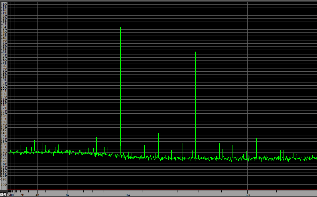

OK, it turns out I have an older audio editing software on one of our machines that allows me to modulate one audio file by another.
I generated dithered 5kHz and 20kHz -10dBFS test tones and then created 20kHz modulated by 5kHz test file. Exactly as what Jn was talking about. All this at 88.2kHz 24bits (HiRez).
Spectrum of that signal is below (64k FFT). As expected, one can see 20kHz tone and sidebands at 15kHz and 25kHz.
(Ignore the "grass" at around -145dB, it is probably truncation distortion due to plain 32bit float operation and no dithering to 24bits at the output of that particular software).

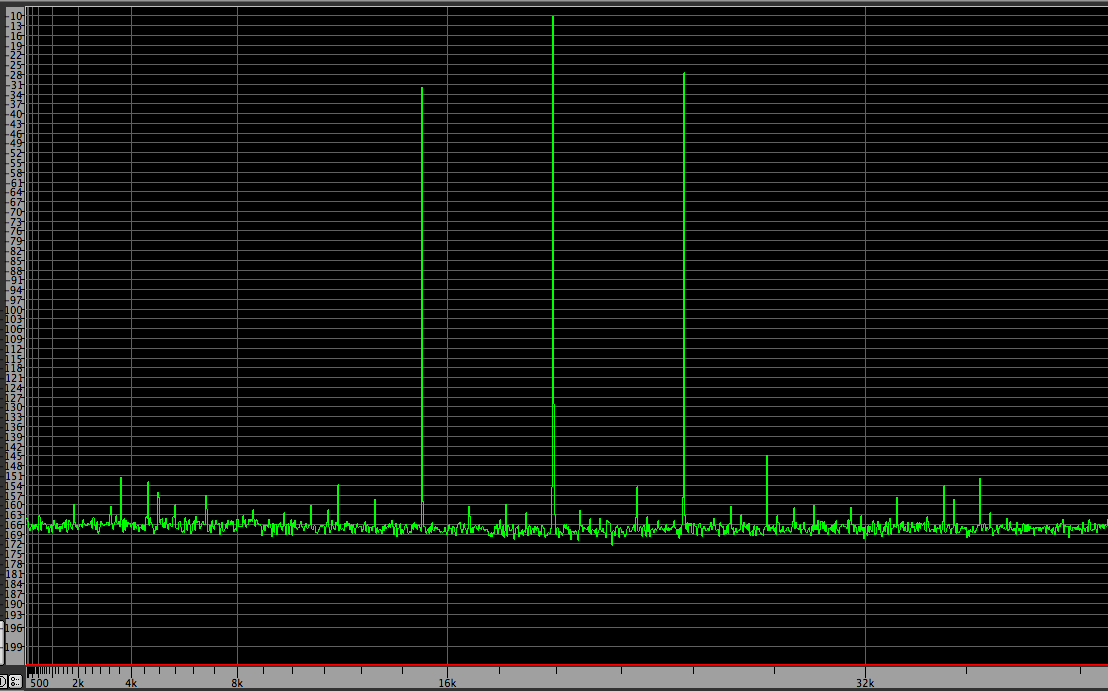

Then I loaded the test file in another editor and applied two LP filters in a row at 22.050kHz with Q=0.7 and slope of 48dB/oct.
As one can see, only amplitude of sidebands have changed - there are no new tones there 😉

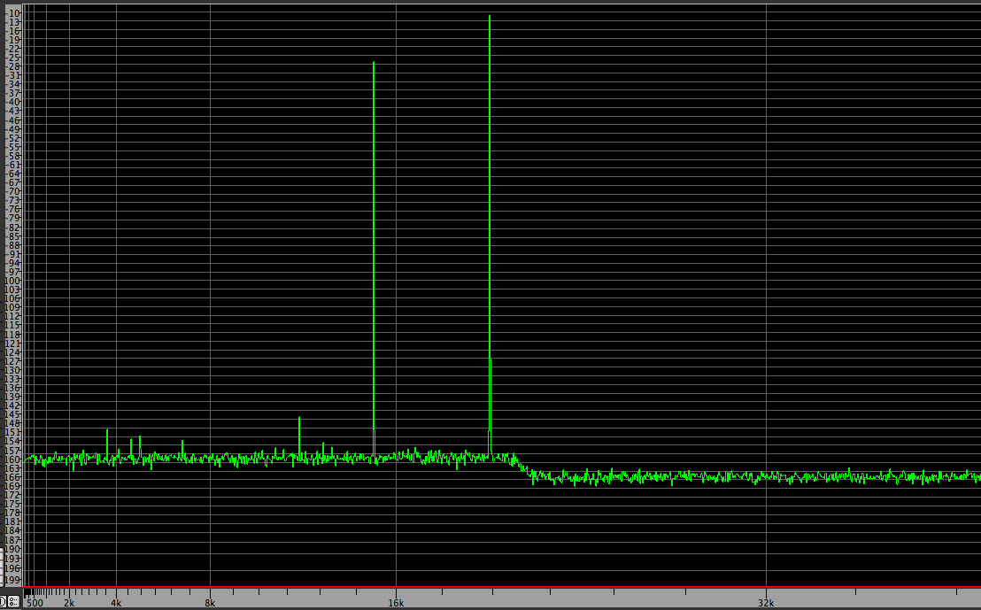

Then, in a way to apply the "brutal" brickwall filter, I took the same test file and downsampled it to 44.1kHz. Then I upsampled it back to 88.2kHz so that it could be better observed on analyzer.
The upper sideband at 25kHz is gone, but, again, I see no new tones and no frequency shift.
