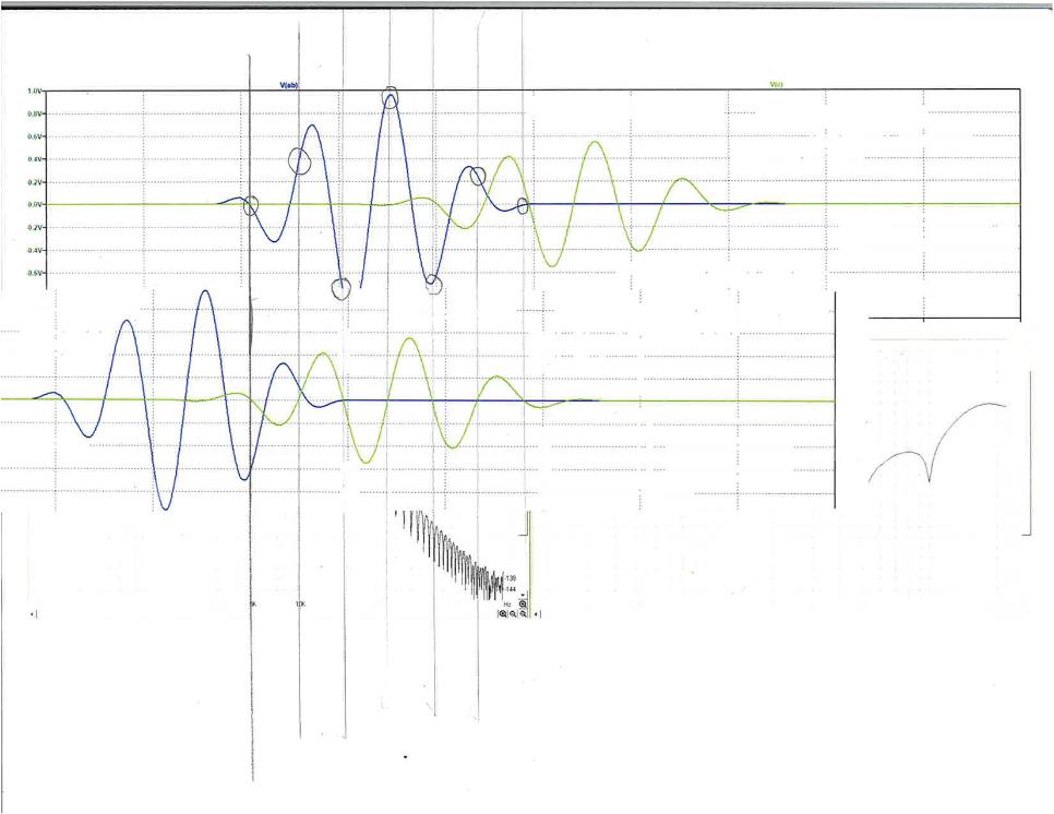

I printed out two copies of Han's posting, star date 34414.
I then used my PSP* tools to sample one, and add it to the other, time shifted about 100 uSec.
IOW, I cut one, scotch taped it to the other.
Note that I drew a straight line through every green zero crossing and the first blue zero crossing.(to line them up.)
I circled on the blue waveform exactly where the green zero crossings occur on the blue.
ps. If one also takes the time to do so, figure out the time it takes for 3 negative going zero crossings on the green wave.
As close as I could guess, it is very close to 170 uSec for 3 full cycles, or 56.66 uSec per full cycle.
1/56.66 = .0176. So just by pencil paper, and good glasses, it looks like the green is 17.6 Khz. Close enough to 17.5Khz given the method used..
jn
*Paper Sheet Processing
