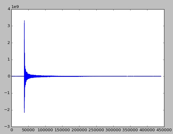

I asked why the 192k and not the easier 176.4k 20 pages ago. No response.
I have a 192k file that Mark provided. We are doing some exercises on small clips as an exercise not designing a DAC. Either sample rate is two lines of code, in place and no zero packing with the change of one number. Both of these sample rates factor into very small primes so the FFTW lib has no problem with them.
EDIT I was wrong the code is agnostic to the higher sample rate.
(for a 10sec clip)
fft_in_sig = np.fft.rfft(input_sig)
out_sig = np.fft.irfft(fft_in_sig[0:220501])
(plot result)
