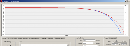

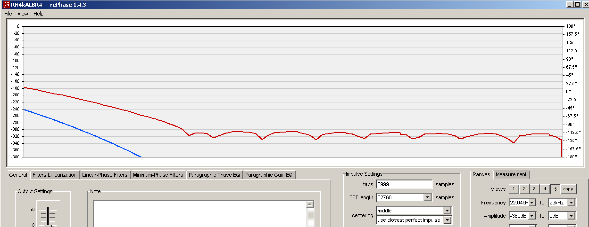

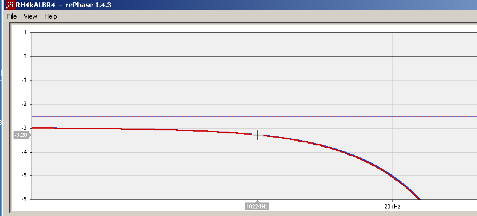

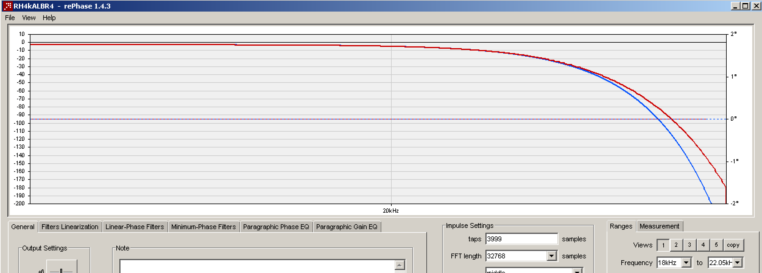

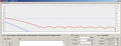

I made my own filters for my DAM dac. It runs on 4k taps (only). Used rePhase to generate the filter. Its optimised for mirror suppression and a smooth drop - not BW. Sounds superb. Even cymbals :-D
One can deduct the scales by checking the settings to the right lower corner e.g. the second pic that focus on the stop band, the leftmost reading is at 22,04kHz.
Yes - horror - its down 0,28 dB at 19,22KHz. Yes, there is 3 dB damping in the filter to mitigate inter-overs 😉
The blue traces are the theoretical and the red is what you get out with an ideal 4k taps filter implementation.
What happens above 20KHz as i have measured and shown above?
