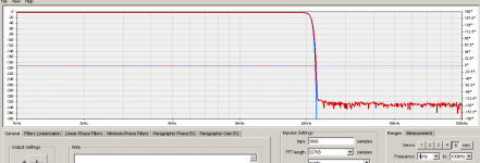

Level is appr 2 dB down. Phase is within 1 deg. This is shown in the pictures. And it is a theoretical value. I have not measured. If my DAC really implements this, the drop and phase is enough to understand what the result will be. No?
The filter characteristic above 20k was in the second picture - all mirrors are supressed > 175 dB.
1k-100k =>

Can it be as elegantly explained how a single, non-repetitive unipolarity pulse of short duration is sampled in such a system built upon continuous waveforms to predict outcome accurately?
Oh, say 50usec wide pulse?
