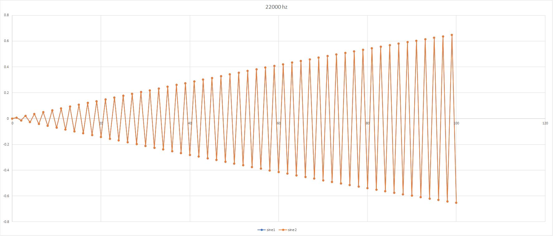

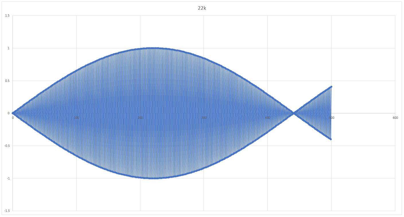

For scott:
Earlier I mentioned the tradeoff between filter window size and proximity to the nyquist limit. Always above nyquist sampling rate, but close.
Here is a 100 point sampling of a 22Khz signal being sampled at 44.1, and a 500 point sampling. My question in this regard is: without system memory extending into infinity, how can a practical system convert this stream into a constant amplitude 22Khz sine wave?
How can reconstruction algorithms, even 8 or 16 deep IIR's or FIR's reconstruct the flat sine?
The closer I get to nyquist, the longer the sampled stream will take to get to the peak value of the sine.
If I modulate the sine, I can get sampling that duplicates this, so how to reconstruct.
As I back off the frequency, the sample envelope (beat frequency) gets faster, and very soon the peak value is indeed within 8 or 16 samples. And as we go further from nyquist, the actual waveform begins to display exactly. That was Richard's point.
These were my questions.
jn

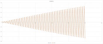

jn

In AM terms, you generate sideband. Reconstruction is possible when the sideband is within Fs/2. But sampling and reconstruction of signal with close to Fs/2 content slam hard against the limitation of practical implementation.... If I modulate the sine, I can get sampling that duplicates this, so how to reconstruct...
