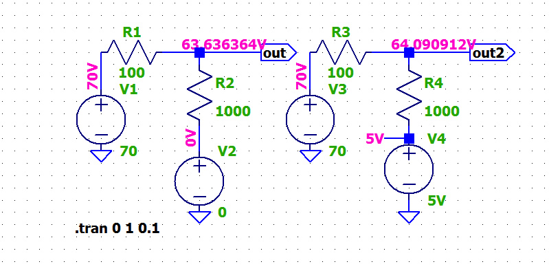

Napoleon said a little schematic says more than thousands words.When correcting a 70 Volt OPS input signal, the correction signal will effectively be in the sub Volt region and should hover around this 70 Volt to correct the input signal.
Suppose input signal is 70 Volt at a certain moment and should be error corrected to 70.5 Volt. This will not be possible with your opamp circuit.
Just the idea. No free lunch, of course, but nothing impossible with a spirit of sacrifice ;-).

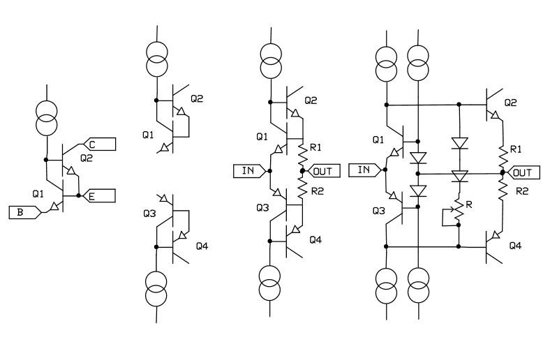

If you search for the Putzeys designed 30W (balanced) class A amp, (Extreme A from memory?) , it had a pretty cool OP stage with local FB
loop current driving the emitters of a pair of 'backward' bjts.
Nothing turns up (any link?), but this reminds me of the emitter driven EC proposed by Barry Blesser circa 1972. He only had NPN's at his disposal at the time but with both flavors I drew a little family chart that led to an interesting EC scheme. Jcx pointed out that this was in a Pass Labs patent years later reinforcing the thought that nothing is new.
Might have been some revisions, but here was the original article IIRC.
ExtremA, a reference class-A DIY amplifier. - Copyrights, Updates etc.

Just make a complete working circuit in LTSpice , with resistors, opamps, a voltage source injecting the distortion and your suggested error correction, all as close as possible to a real situation.
You are attenuating the input signal of the OPS by 10%, it might work that way.
First try to find out what the simulation tells.

These are Christmas sales.You are attenuating the input signal of the OPS by 10%
As I told, there is no free lunch. You will told me too than an OPA do not have 0 Ohm of output impedance etc.
Not my way to work.Just make a complete working circuit in LTSpice , with resistors, opamps, a voltage source injecting the distortion and your suggested error correction, all as close as possible to a real situation.
I have several ideas about the "mix" stage. Don't make the mistake of SYN08 to confuse a charcoal and the final painting exhibited at the Guggenheim museum ;-)

Often also used in discrete small signal amplifiers - a classic being the 3 or 4 transistor RIAA preamp
