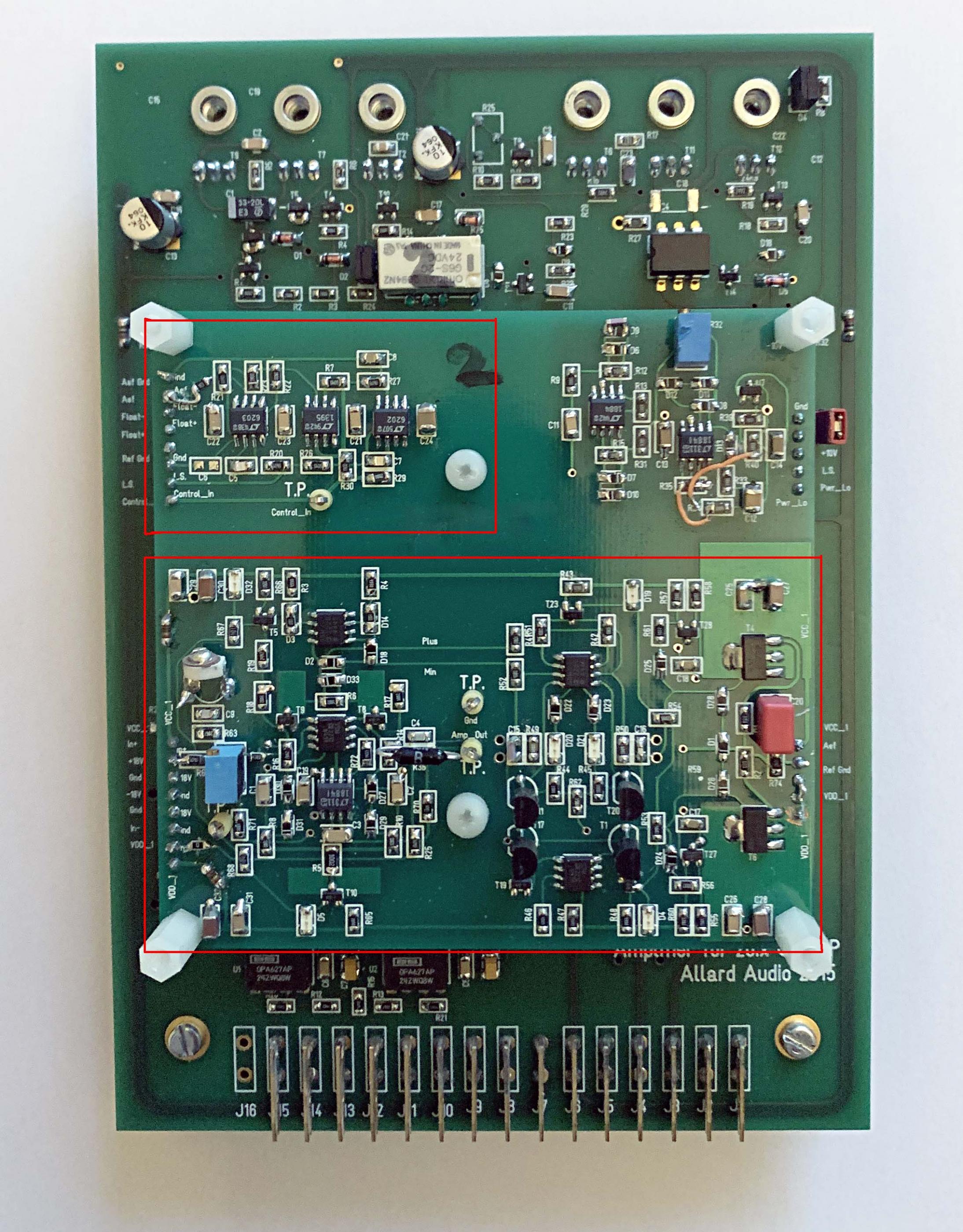

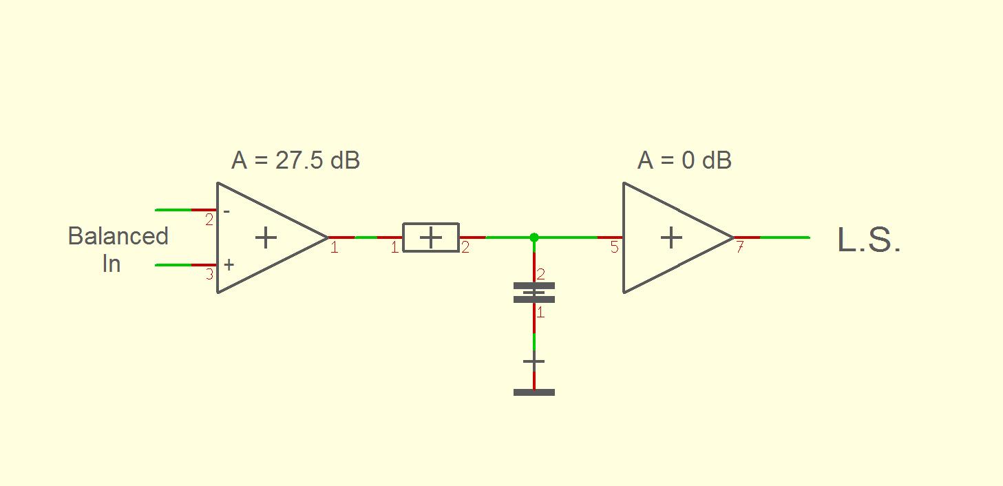

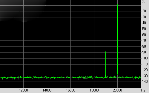

Here the measured IM distortion at 80Watt into 8 Ohm, very low because of the nested error correction.
The picture shows the voltage amp in the large red square and the error correction in the smaller red square above.
The BW of both voltage amp and OPS are very much larger as the first order 250KHz filter in between.
Everything is working perfectly since 2015,
Hans

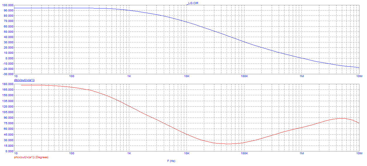

The LG BW of the practical amp I am talking about is c 8 kHz, two pole comp and a ULGF of c. 1MHz. 30-35 ppm at 200W without AFEC and 7 ppm with - I cannot measure lower.
