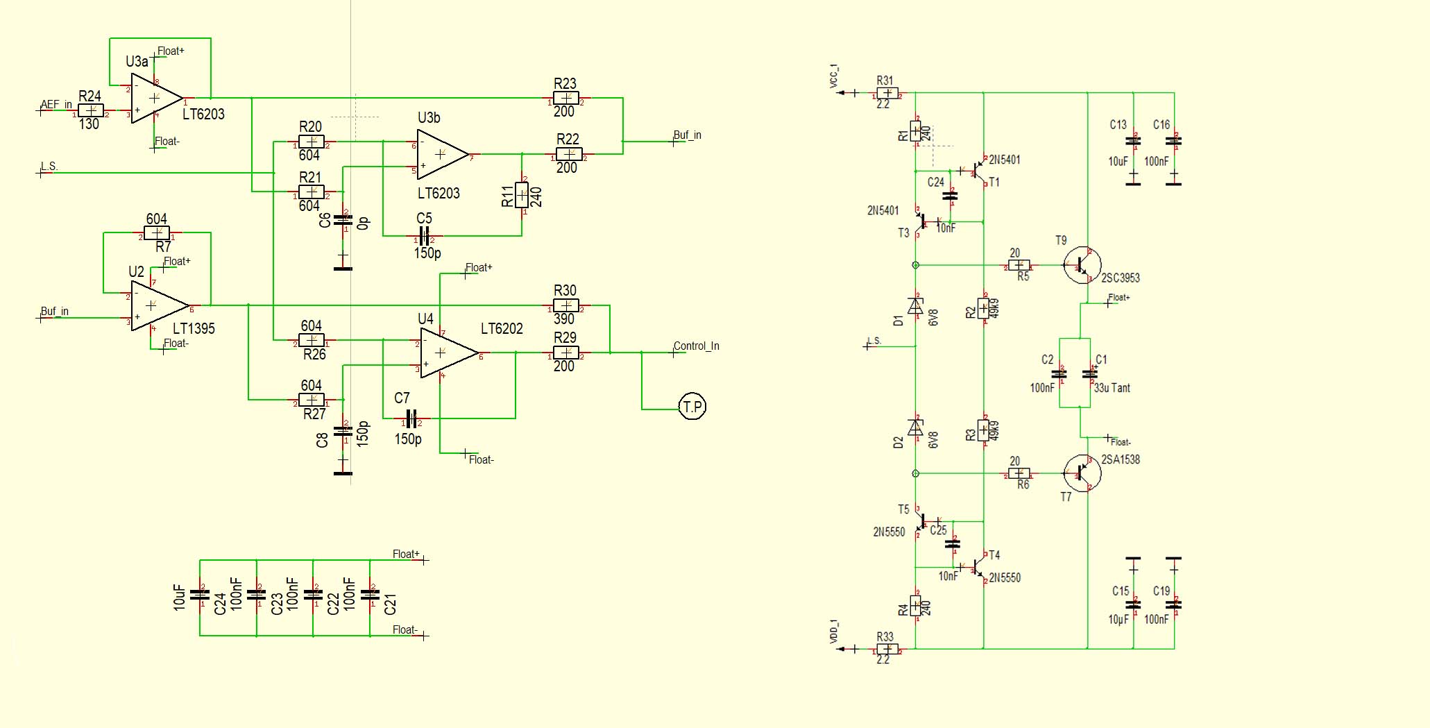

What have-you done ? Reduce the levels of the signal at the input and output of the power stage, in order to can use a comparator with +-12V rails, extract the error signal and amplify-it with discrete devices (in class A) to apply it as a local feedback at the input of the OPS ?
No, the signal taken from input and output is not attenuated.
Supply for the error correction opamps is a floating LS Output +/- 5 Volt.
Hans

Here it is.
AEF_in comes from the RC filter after the Voltage Amp.
Control_in goes to the OPS.
Hans

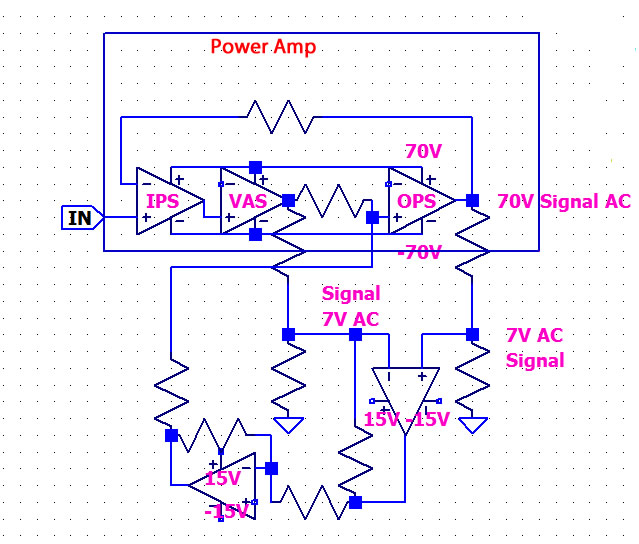

"At the end of the day" (unreasonable assumption at my age), I will try this error correction on OPS as my next project.
Output signal and signal at the OPS input both reduced at good levels for an OPA. Error correction extracted (Signal lot lot lower than the original one with all the benefits expected) and amplified, then applied, phase reversed, to the input stage of the OPS.
Gentle comments welcomed ;-)
I am thinking of using a very low distortion OPA from A.D. to gain an unconditional support from a eminent member of our forum.
No, when the OPS produces 70V, input to the OPS will also be 70 Volt.Ok.
This should but cannot be supplied by the opamp you sketched.
Hans
I don't understand your remark. Both the input and output of the OPS (70 V pp) are attenuated by two divider bridges to, let's say, some 7V pp.No, when the OPS produces 70V, input to the OPS will also be 70 Volt.
After being "subtracted" the remaining error signal will be some mVs (let's say 0.07V for 1% of distortion). That can be amplified in the same proportion with the margin needed for the loss in the passive (or active) mixer at the input of the OPS.
Am-I more clear ?
Am-I more clear ?
His assumption is that the output stage has no voltage gain. You did show it driven by 7 volts so it would have the gain required to accept a similar correction voltage.
Most output stages of course are merely followers and do not have voltage gain but lots of current gain.
Am-I more clear ?
When correcting a 70 Volt OPS input signal, the correction signal will effectively be in the sub Volt region and should hover around this 70 Volt to correct the input signal.
Suppose input signal is 70 Volt at a certain moment and should be error corrected to 70.5 Volt. This will not be possible with your opamp circuit.
Hans
No, no and NO. Its a confusion between error correction and feedback.His assumption is that the output stage has no voltage gain. You did show it driven by 7 volts so it would have the gain required to accept a similar correction voltage.
There is NO original signal after subtraction in the LTP of the first OPA. Just an error signal (the distortion of the OPS that I hope is not 100% ;-) that can be amplified enough to be applied in phase opposition to the input stage of the OPS.
How can-I explain better ?
