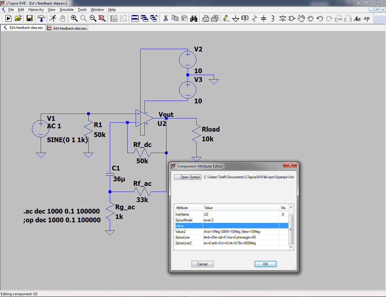

Not really, they can be analyzed by simple inspection. For example the last one in https://www.diyaudio.com/forums/the...wtorch-preamplifier-iii-3239.html#post6014079: LF gain (C is open) is 1 (0dB), HF gain (C is short) is 1+50k||20k/1k~15.3 (23.7dB). Corner frequency is given by 1/(2*PI*C*R) where R is the impedance seen at the C terminals with the independent sources passivized (short voltage sources, open current sources), about 1k (ignore 33k and 50k in parallel) for an ideal opamp, so Fc~4Hz, and it's a sigle LF pole (6dB/octave). Almost exactly what simulation says.
Non-intuitive for me, I should be clear. I'm sure I'll slap my forehead the second I draw it out. Circuits aren't my usual thing so I'm a little slow on the inspection. 🙂
More why the Cordell B schematic does null out the DC offset (3rd one). The others made sense, although I hadn't done the RC constants.
#3 cancels out the input bias current contribution to the offset. If an opamp has an input bias current of say 100nA, a 50k resistor on the non inverting input drops 5mV, which multiplied by the closed loop gain (here, 21) gives an output offset of 105mV (which is a lot, while still assumes the voltage offset is zero).
The Rf_dc=49k resistor doesn't affect the gain, since it doesn't drop any AC voltage. So the gain is constant 1+Rf_ac/Rg_ac=21 (26.5dB), independent of frequency.
At DC, C1 is open and the Rf_dc+Rg_ac=50k resistors drop due to the inverting input bias current exactly balances the drop on R1=50k due to the non inverting input bias current. Result: no input bias current contribution to the output offset, output will stay nicely at zero.
It's even simpler than #4, no calculator required 😀.

#3 cancels out the input bias current contribution to the offset. If an opamp has an imput bias current of say 100nA, a 50k resistor on the non inverting input drops 5mV, which multiplied by the closed loop gain (here, 21) gives an output offset of 105mV (which is a lot, while still assumes the voltage offset is zero).
Much obliged. I knew I was missing something.
It is obvious, in a LTP that both + & - inputs need to read the same impedance.Much obliged. I knew I was missing something.
One other advantage of this circuit is that, if you use a coupling cap for the input signal of the same value and kind than the one in the feedback, (and ensure the AC impedance of the source is ~1K), their defects (if any) will be compensated.

Okay, I want to back the truck up after hand going through things with an idealized opamp. (and then adding things like finite input impedance, bias currents, etc.)
I understand nulling out of the DC offset due to input bias current, that's fine and why I like writing up and solving things by hand at times. (I would have gotten there when I wrote it up)
What I'm hung up on is that *with* 100 mV DC offset placed in series with the AC signal, per George's later notes, the only circuit to zero that out is the Cordell 8-3B circuit. Again, this is nulling out a *differential* 100 mV inherited from upstream. The others show this 100 mV +/- their bias current effects, that one is zero. This circuit is also the only one that has a non-unity DC gain due to configuration. Why doesn't this guy have 21*100 mV = 2.1 V DC offset?
