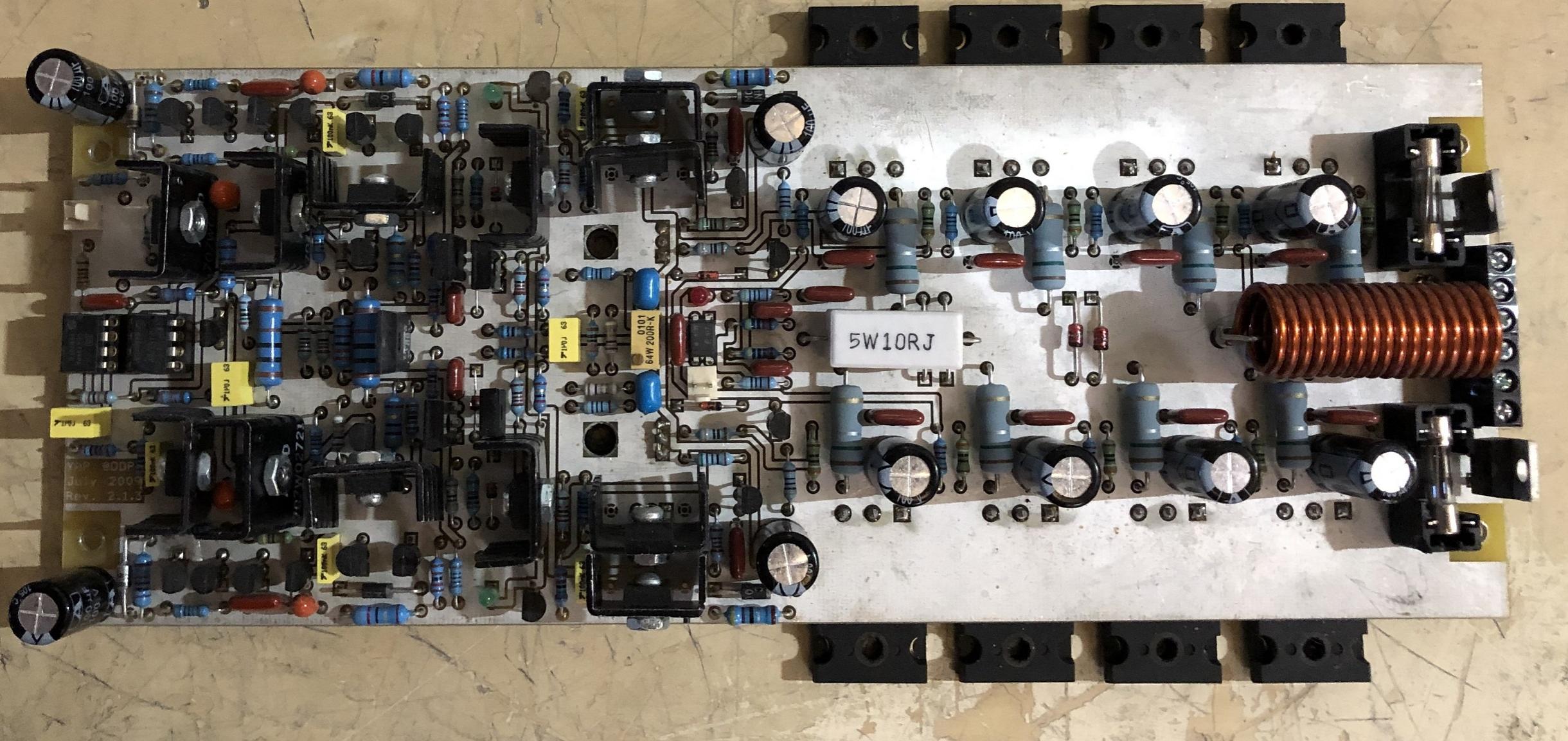

Case in point, 10 years ago I designed a mosfet amplifier (with the now defunct 2SK1530/2SJ162) not with 3MHz ULGF like Dadod, but with 8MHz ULGF (two pole compensation), simply "because I could" and I was curious how much could I push it. I took all the imaginable precautions and built it like a RF piece of gear (that it really was, at that frequency), photo is attached. And yes, it is a CFA, with some twists to improve noise, PSRR and CMRR.
Initially I was very happy with the results; after moving out the output coil off the board distortions at 300W/4ohm @20KHz were under 5ppm (0.0005%), loop gain simulation and measurements were showing a healthy 60 degrees phase margin, sounded perfect to my ears (and a few friends). I was about to declare a major breakthrough, until I had the idea to do a load scan at full power. It took me not longer than a week to find several combinations of real speakers or synthetic reactive loads that showed this amplifier is very sensitive to various reactive load parameters. And even if initially it never destructively bursted into oscillations, it was easy to measure and hear the effect of transient burst oscillations at the output. Lowering the ULGF to 4MHz increased the phase margin to 80 degrees, but the transient stability remained shaky at best. I ended up blowing one channel during capacitive load testing (and no, contrary to what people think a 1uF capacitive load is NOT the worst case for loading an audio amplifier, 1-50nF is where the devil kicks in) and kept the other channel in my museum of failed projects. And never published this project for anybody else to try.
Lesson learned - Bode was right. Given an amplifier and a frequency compensation order (two in this case) you cannot push the HF loop gain without compromising, one way or another, the stability margins. I knew this all along from feedback theory, but what I grossly underestimated is the garden variety of possible loads (speakers+cables) that a power amplifier may encounter. So I concluded that there is a good reason why commercial amplifiers are barely going over 1MHz ULGF and almost always use Miller compensation (not even standard TPC). Those designers knew the risks before I discovered them on my time and dime.
You don't want to hear about more adventures with audio power amplifiers using pole-zero cancellation techniques, able to push the ULGF up to 20MHz even with power bipolars with Ft=30MHz, and since the OLGF is theoretically set very high by the input stage pole(s) they don't suffer by the Bode stability limitations as above, where it is the output stage enforcing the open loop frequency response; in this case, it was the circuit sensitivity (to power supply voltage, temperature, load, etc...) that killed the project, something that trivial simulations will never show (unless Monte Carlo simulations are used).
And Dadod is wondering why I am so "conservative" in ULGF... and I'm not even an "audio designer" 😀.

Have you posted the schematic or are you willing to share if possible.
Jam
PS. Great idea to have local bypassing of the output devices.

Never published the full schematic, and ten years later I have no idea where it is on my computer with 4Tb of hard drive. I'l try to find it when I'll have the time.

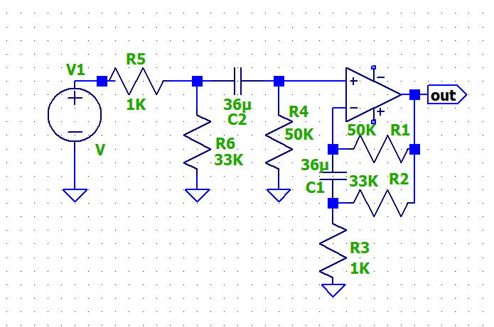

At DC it is a follower with a gain of 1!
John Curl's Blowtorch preamplifier part III
Third circuit is *not* unity gain at DC. This is the one that I cannot reconcile with:
Admittedly my brain isn't firing on all cylinders (writing a paper closer to what Auplater does) but are we seeing an oops from LTSpice wrt convergence at DC?
>Edit: wrong links fixed

Okay, I read you carefully and cannot contradict you. I also looked at your printed board and, indeed, it seems conform to what you said about it about RF precautions.
