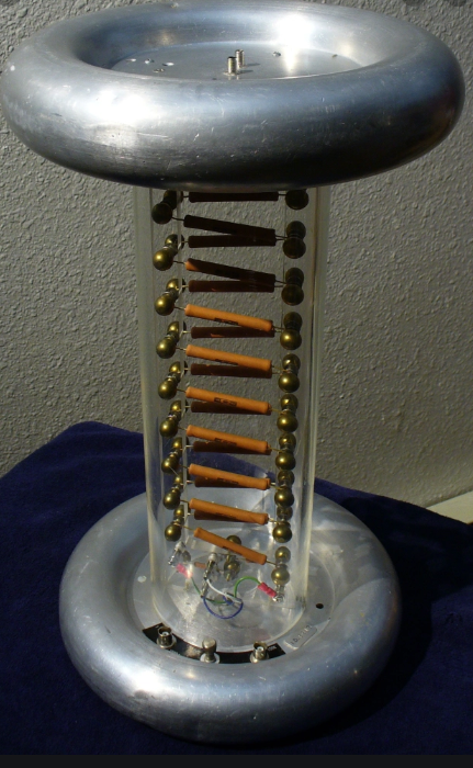

Resistors have shunt capacitance as well as inductance and at 10K the cap dominates. It seems they tend to balance ot around 100 Ohms but nothing is guaranteed. If you are looking for precision you do want a pretty high power resistor divider and if the ratios can work the nonlinearities "may" cancel or they may add. My AC calibrator uses a 5W Vishay foil in its feedback to meet the performance requirements for 10V.
The photos are high voltage precision dividers showing some of what is involved to get accuracy for HV AC. The better ones I have seen spiral the resistors as you can see.
