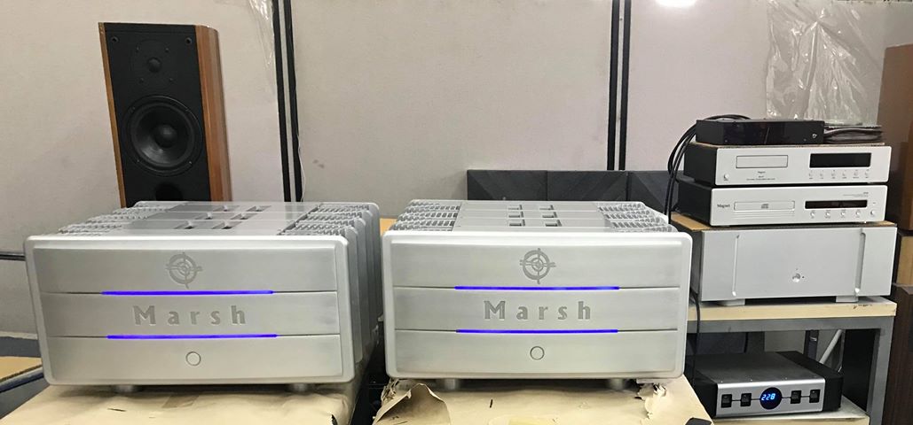

yep, they are at my disposal if i have a project I want to work on. Like those custom, one-off amps of Damir's for myself. They did drawings for chassis, got them milled and machined. Did pcb and ordered all parts, did assembly and testing. Silk screen. Everything for me. Doesnt mean I, personally, am selling anything.
No, they (Magnet Audio) would, in your name, with your logo and name on the product:
then send it to audio magazines for review:
I can report to all here that I had this amp design prototyped for myself and recently sent to Asian Audiophile magazine for review and listen and get thier comments on the sound. They said they were able to clearly hear the character of the various preamps they had used it with. .
Then set a price and advertise the product:

Here you go.I dont sell audio gear. Just as JC doesnt sell audio gear.

That is a big assumption well past what i already said. They are made for me. I do not plan to sell them as they would be too expensive, the way it is build now. Plus, they have not been reliable enough, yet. I am not going to send them to audio magazine for review. They are going in my personal system. They are for my bi-amp'ed JBL M2's.

Damir design is being build by others, i am sure. Plus his other fine designs. All published for DIY. What I showed is my DIY effort in packaging it. The fact that I have resources available to me to build it should not be a problem for any one.
