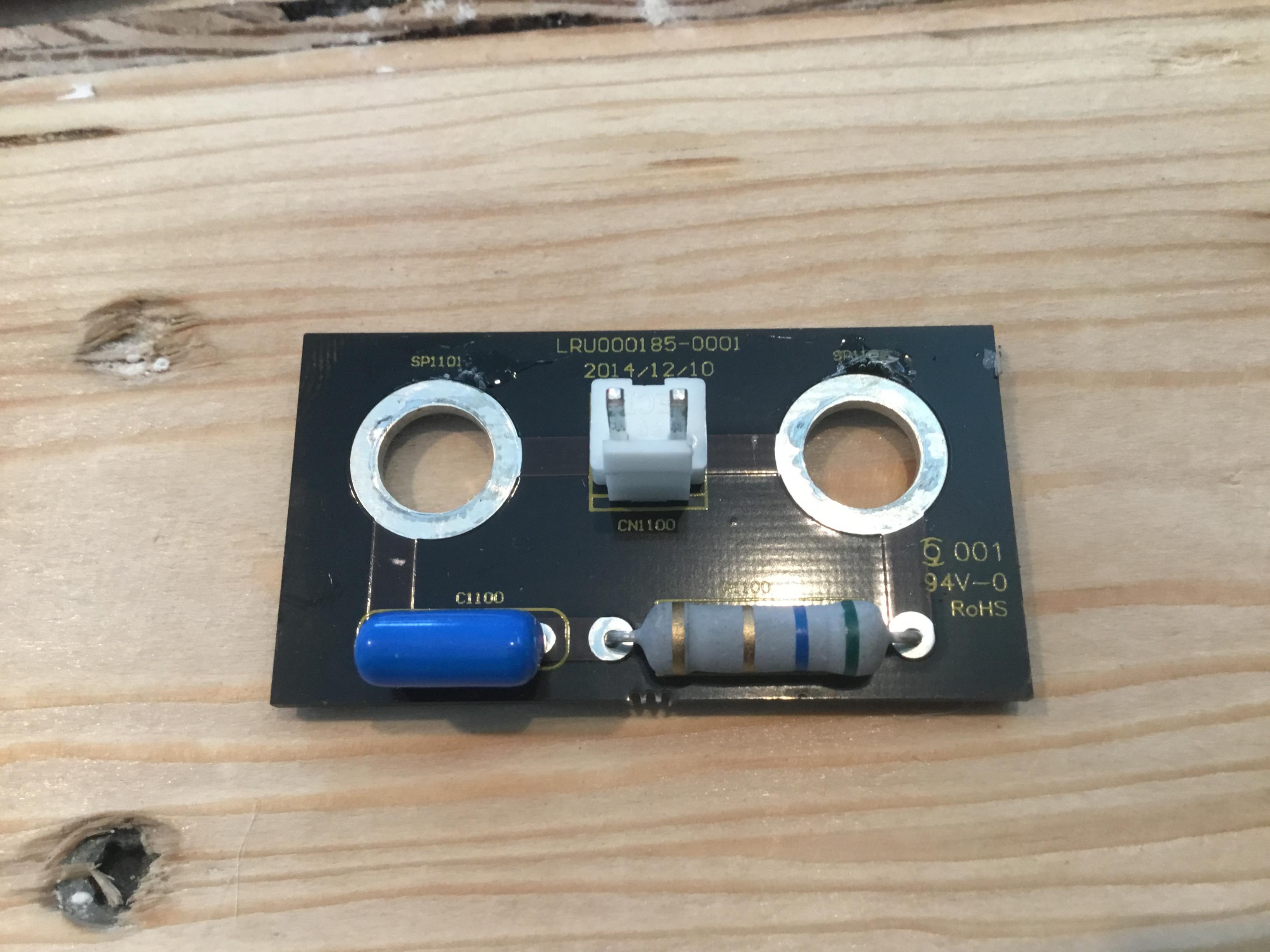

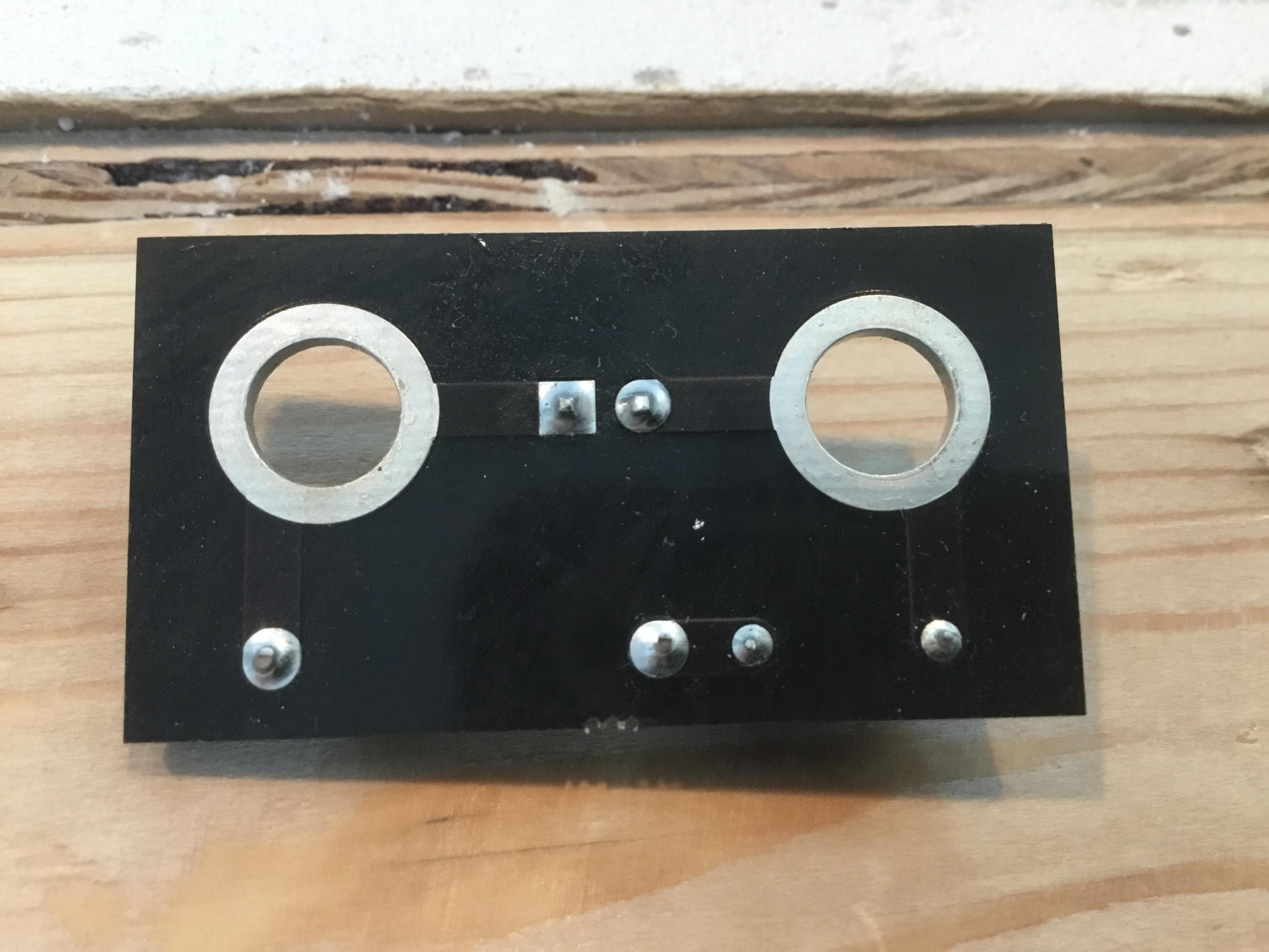

Do you mind also to remove one of the connector boards and take a pic of both sides please?.
Dan.
Here ya go

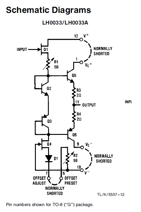

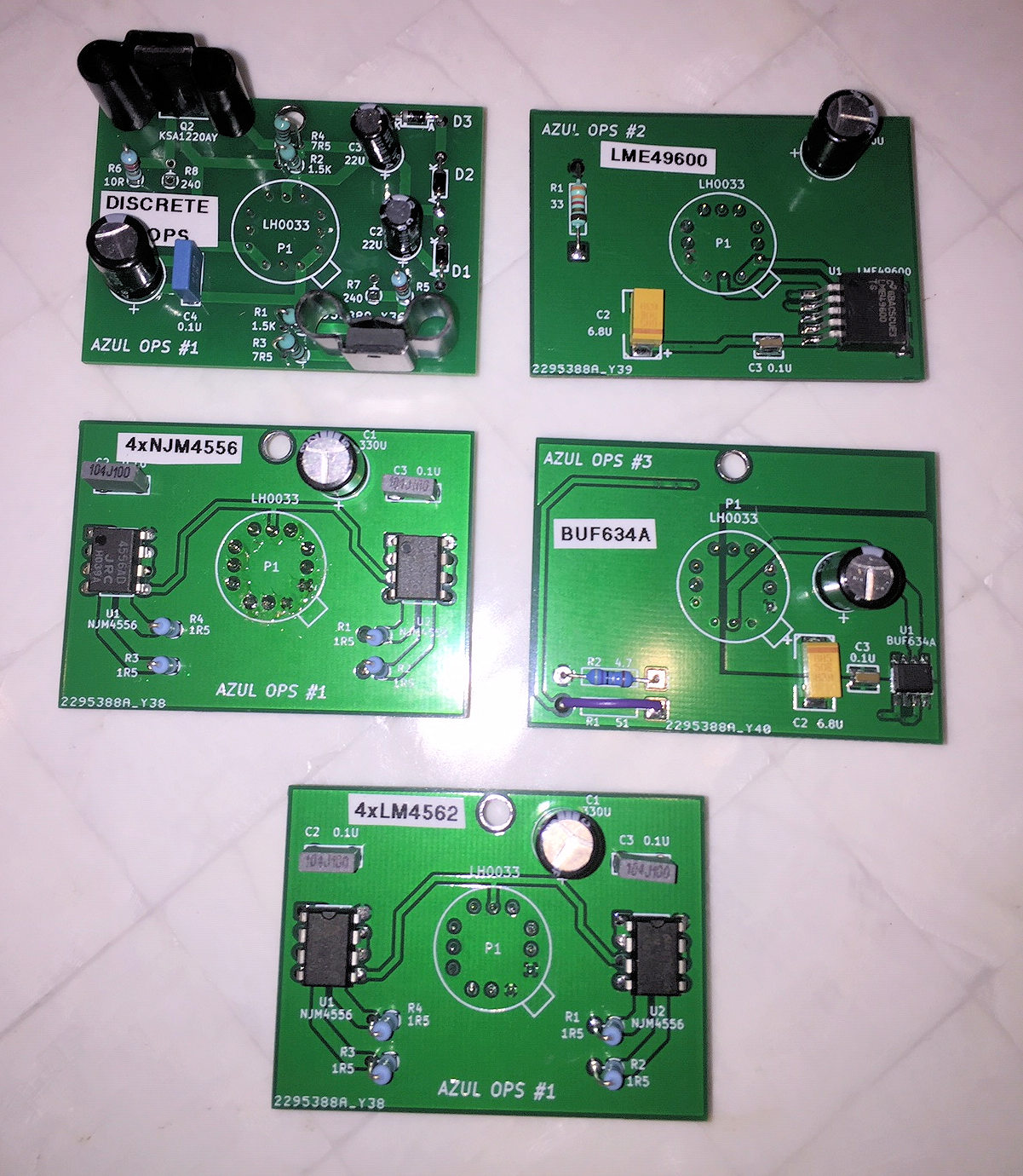

LH0033 hybrid as output stage of headphone amp
Although I had several LH0033s to play with, I didn't want to risk them in an unproven and not-bug-free amplifier board. So I decided to build an "emulator" daughter card, which plugged into the LH0033 socket and performed the same function, using low cost, easy to buy, active production components. If I destroyed a few of the emulator cards, so what. They're easily replaced.
Then the penny dropped. I realized that these LH0033 emulators were, in fact, interchangeable Output Stage Daughter Cards. I could swap new output stage designs in and out, as often as I liked. Perhaps to optimize measured performance, perhaps to optimize listening pleasure, perhaps to minimize parts cost, or perhaps to use up my stash of 1971 Linear Hybrid devices. Eureka.
Besides the LH0033 itself, here are some of the daughter cards I built to drop into the output stage socket. A couple of them use the "Objective 2 HPA" idea of parallel opamps with 1R5 balancing resistors; in my case, four parallel opamps, i.e. two duals. Then there's a BUF634A, an LME49600, and a discrete push pull buffer using 200 MHz VAS transistors in the TO126 package. And, perhaps, more to come.

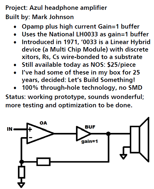

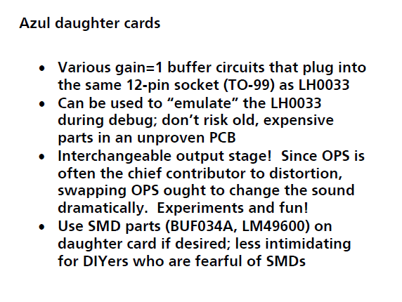

Daniel, it's a composite. However the LH0033 is only a unity gain buffer so it doesn't increase the loop gain. It does add a few degrees of phase shift at the unity gain frequency of the entire loop.
Here are the exhibit plaques that I placed next to the amplifier on display at Burning Amp. I think they probably tell you exactly what you want to know.
MJ
{I did exhibit another composite amplifier called "Rojo", with a total of ~180 dB of loop gain. An IC opamp in series with a high power discrete opamp. Yes it was fun to figure out how to compensate that unholy swamp. No it didn't use LH0033s.}

Please keep it as it is. The soldering points shown by Max in the first picture may be connected to the terminals with thin traces, can't see because they are on the flip side. To solder there if that is the case would make matters worse.
The other picture underscores Max's lack of insight. Of course, the Zobel does not have two resistors.
There is guaranteed nothing to be gained sonically from bypassing the PCB connector.
