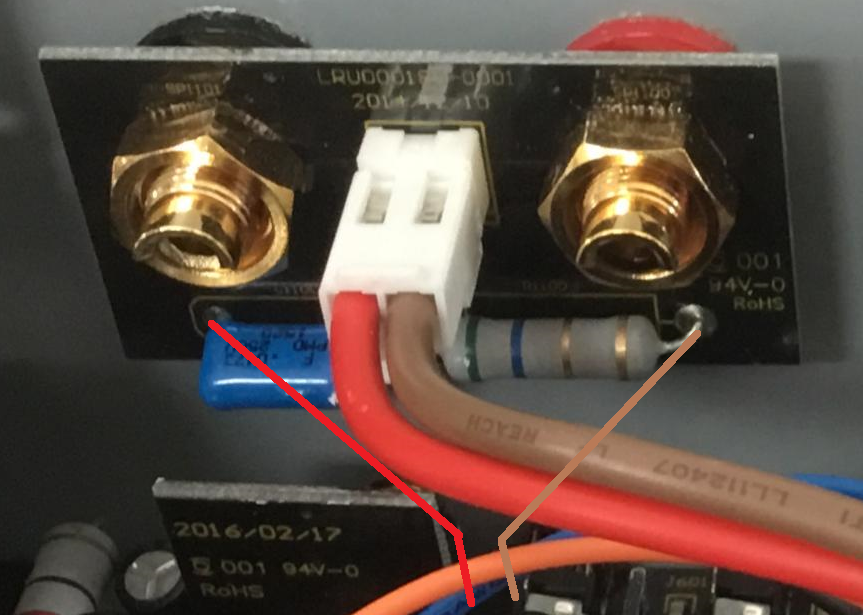

What's the copper output ?...do you mean on the output sub pcbs ?.And yes Daniel I meant soldering directly to the copper output....probably best to scrape the gold plating at the soldering point?
If so, then do it like the pic, no scraping tracks etc, just cut the wires and solder them to the existing pcb pads at the points shown......you will need to remove the pcb temporarily to get enough heat into the board/joints during soldering.
The above will give you a slightly different sound.

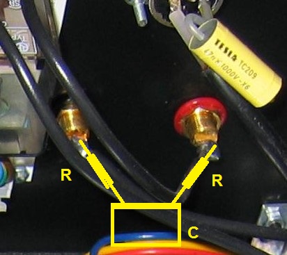

IMO better is to lose the pcb and solder connect everything directly to the binding posts as per Pavel's photo using new R and C as I described in another post.
Bob, I suspect you are overthinking things, this should not be complicated.
Dan.
