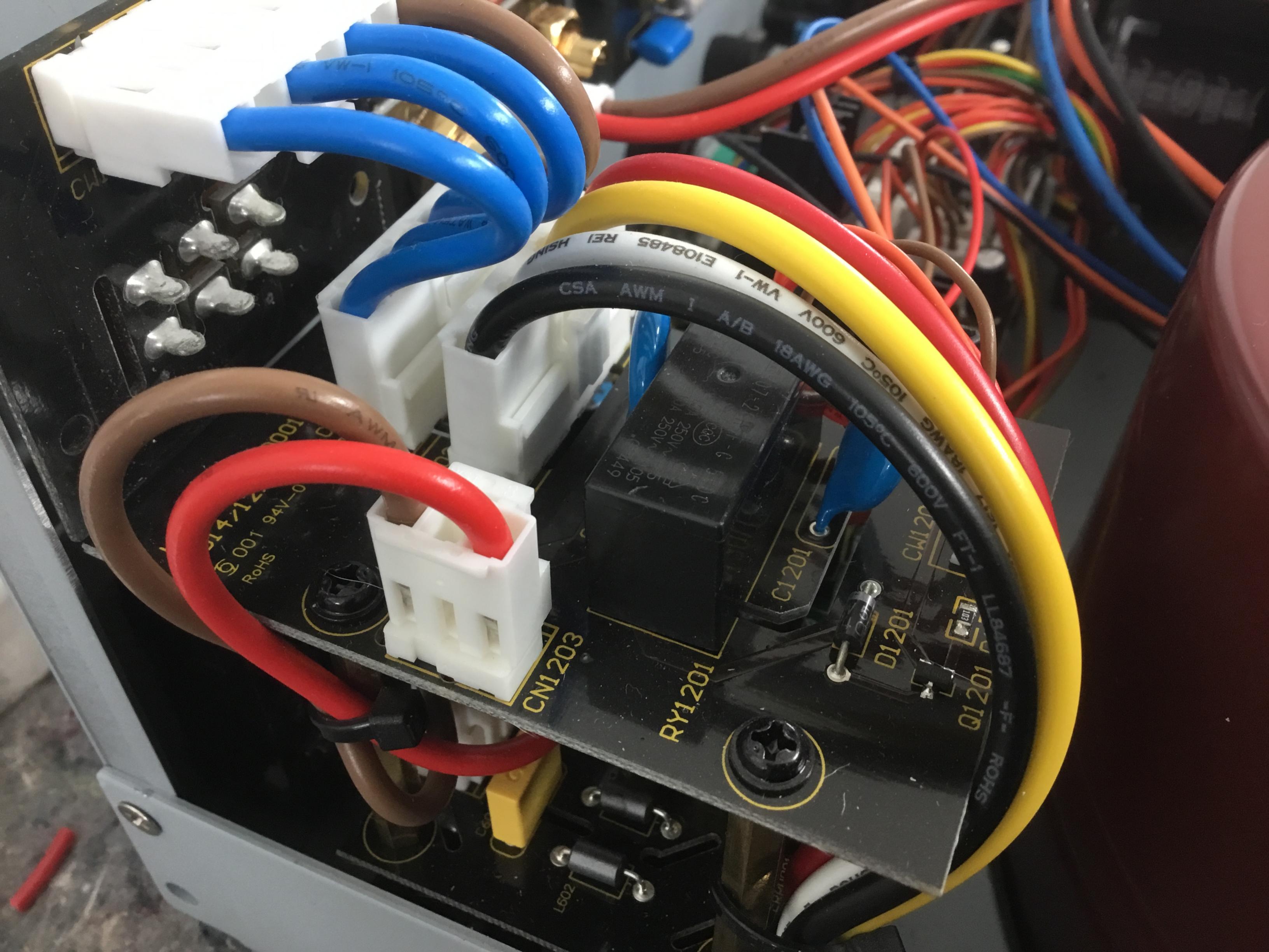

The biggest potential compromise in the output are the output connectors. You should test them for steel content. Get a magnet, and if the magnet is extremely attracted to the connector, it should be replaced if possible. A potential improvement also 'might' be to solder directly the output cables to the output connector. Usually this is almost impossible without a huge soldering iron or a flame torch. Is it worth it?
Thanks JC,
I understand your position of not wanting to open a can of worms.
And I thank you for what input you are giving.....like I said I’ll leave the zobel alone and will probably get some high quality output connectors.
Hopefully they are just tightened onto the zobel PCB and come apart easily, after disassembled it would be easier to solder it back.....I have a heavy duty gun that would probably work.
If you could maybe comment on those ferrites in question on the mains input(the two on the bottom board near the yellow cap)
that would cover what’s been questioned.
It is about the sound after all?
Thanks again,
Bob
Probably not. Thankfully Bob listens to what you say. For what it's worth I might do something about the connectors onto the board.
I would think soldering as many of those connectors as possible would be beneficial.....seems as though it was a ease of assembly/repair thing, definately not a optimal quality thing. In fact the parts and PCBs seem very high quality but assembly does not.
The assembly is cost-effective first and can be done much better by DIY.

Yes you have it, the overall design is excellent.....JC's schematics and Taiwan layout parts and production techniques.I would think soldering as many of those connectors as possible would be beneficial.....seems as though it was a ease of assembly/repair thing, definately not a optimal quality thing. In fact the parts and PCBs seem very high quality but assembly does not.
Yes, the output terminal arrangement is ideal from production/assembly point of view but could be better sonically as I have been saying.
The RC network values are 0.047uF Polyester cap and 5.6R Metal Oxide Film resistor I think.
There is much room to experiment with types of both C and R....the resistor type is chosen because it is rugged and fail safe....no smoke/flames/fire and the cap because it's pretty cheap and on measurements does the job (unless JC chose it by auditioning).
I say the output terminal pcb is 'voicing' the amp to some extent, ie all the parts involved (connectors and RC and pcb material) set a tone, and in this case I reckon will be dirtying the tone.
I have never found polyester caps to sound good (see the link above), and the MOX resistors are noted for being noisy and the tempco is not very good, and I am suspicious of their sound, IIRC they cause an odd dull sound.
So you have opportunity to do some tuning by removing the pcb and soldering new RC networks and the speaker wires directly into the back of the banana posts.
I am finding that Metal Film resistors across my amp and speaker terminals sounds nicely clear, Carbon Film sounds 'musical' but dirty and veiled.
Two standard 2R7 0.6W MF resistors in series (solder one into each post in addition to speaker wire) with a 0.047uF/47nF polypropylene cap bridging the resistors would work and I expect lift the sound nicely.
This arrangement costs only a few dollars, is easily available and allows easy AB experimenting with cap or resistor types but the MF/PP network will be close to optimal IME and is what I would try in this case.

Ferites and speaker output cables are next subjects.
Cool, thanks Dan,
I know for fact that sound can be shaped with different materials/manufacturer of the same values, as evidenced in my xo experiences.
I’m probably going to try just better outputs soldered straight first (with the stock zobel) and go from there. I like going slowly,one change at a time or you never really know where your at!
