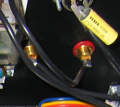

In the case of the Hint amplifier, what it was supplied with seems adequate. Anything else will not give much. Other amplifiers might be another answer, but the Hint amplifier cap is pretty good, at least as far as I can tell. The biggest potential compromise in the output are the output connectors. You should test them for steel content. Get a magnet, and if the magnet is extremely attracted to the connector, it should be replaced if possible. A potential improvement also 'might' be to solder directly the output cables to the output connector. Usually this is almost impossible without a huge soldering iron or a flame torch. Is it worth it?
The Hint, no doubt, does not deserve to be torched. As to possible gains: soldering cables directly to the output connectors could lower resistance, possibly, but the uOhm that might be gained seems irrelevant to me. Unless, of course, said connectors exhibit micro diode behavior 🙂.
Probably not. Thankfully Bob listens to what you say. For what it's worth I might do something about the connectors onto the board.
IMO just "normal" soldering iron gun (pistol) will make the job, at least it does for me.
