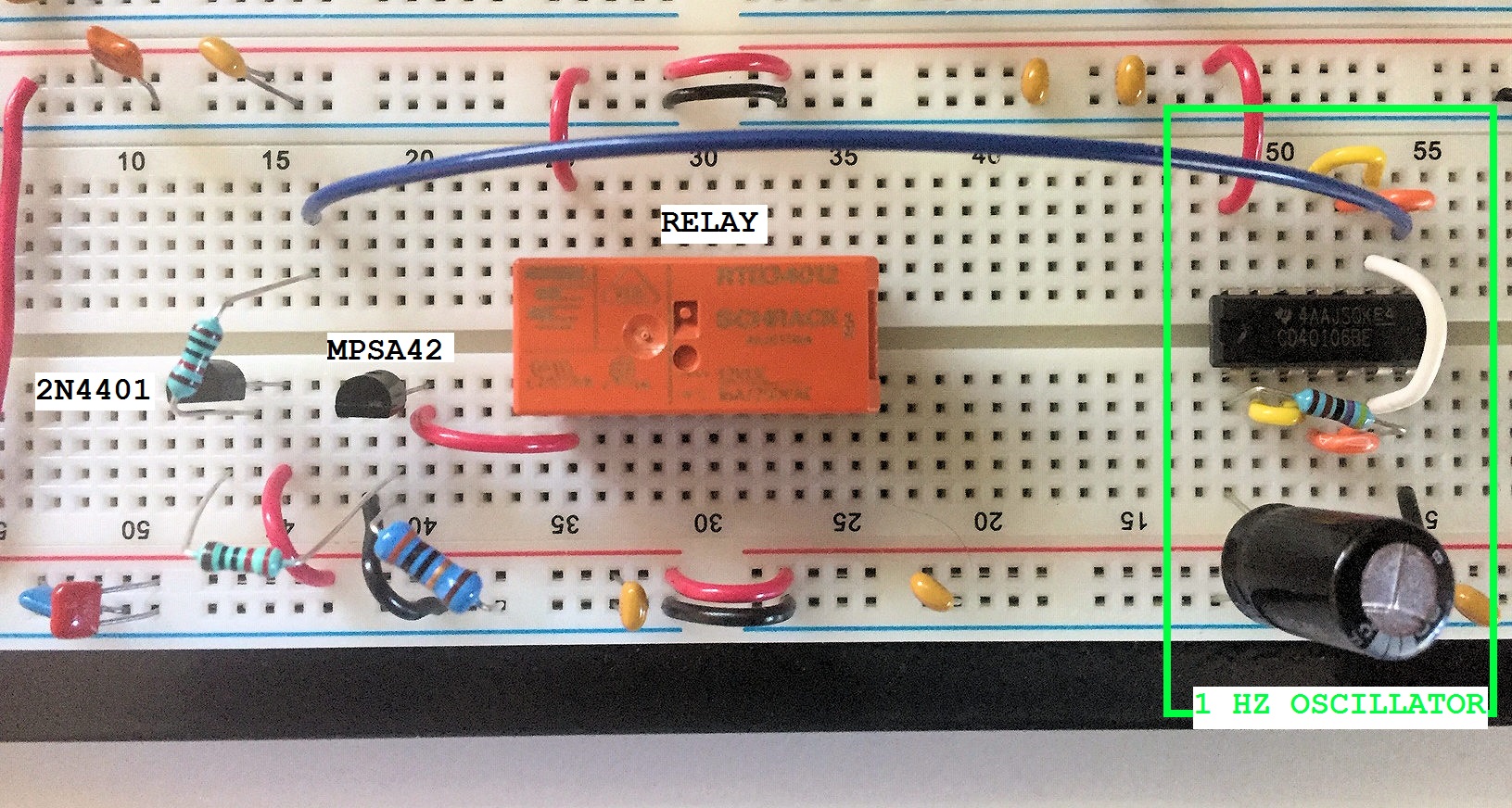

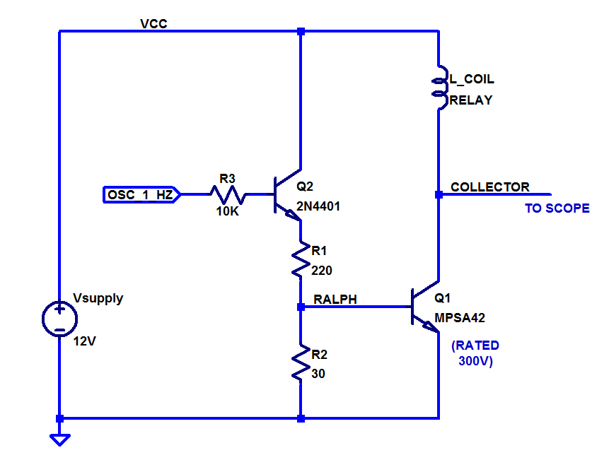

I built the little circuit shown in figures 1 and 2, on a solderless breadboard.

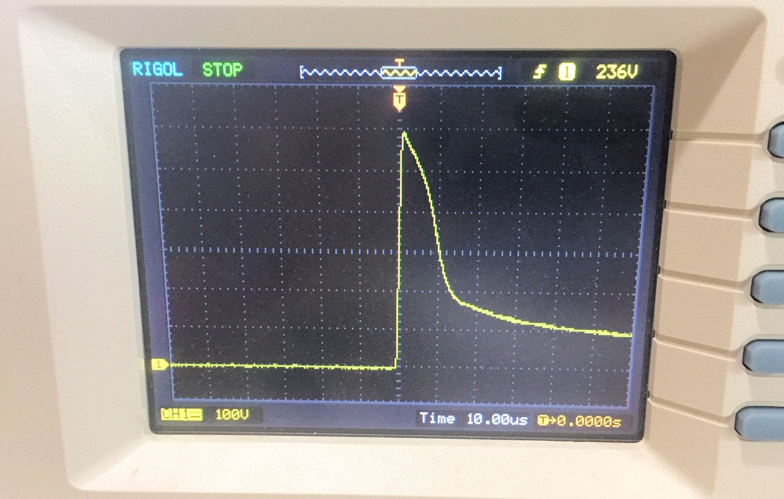

With no flyback diode and no flyback protection of any sort, I measured the waveform shown in figure 3, on the collector of the BJT. It's an MPSA42, whose datasheet shows an Absolute Maximum Rating of VCE <= 300 volts. But it seems to have survived just fine. I ran the apparatus for two or three minutes so it tolerated more than 100 flyback pulses at 600V each (!).
You'll notice that Figure 3 was taken on a very inexpensive digital scope. Yes it was my "most expendable" scope, which I used just in case the flyback pulse might prove injurious. With a 10 megohm 10X probe, the scope seems to have sustained no damage.

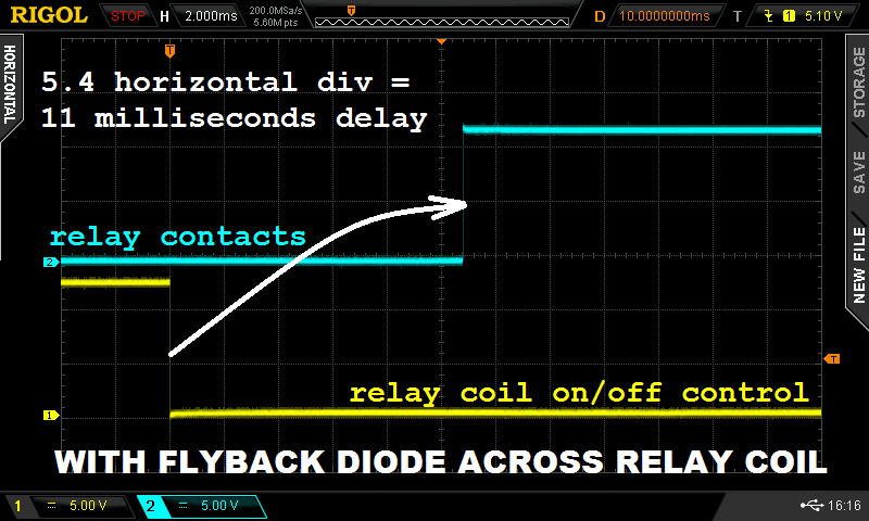

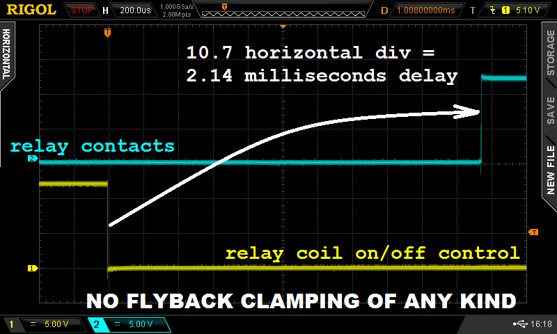

Then I pulled out a slightly nicer scope and did some two channel waveform captures. I measured the turn-off delay, with and without the traditional 1N4148 flyback diode across the relay coil. See Figures 4 and 5. Experimental result:
Relay turn-off was 5x slower with a flyback diode than without.
Anybody could replicate or extend the delay experiments; you probe only digital signals, which swing between DC supply (+12v for this relay) and ground. Benign and safe.
Circuit notes: R2 is only 30 ohms. This sucks out the base charge of Q1 very quickly (nanoseconds not microseconds) and speeds turn-off. Predriver Q2 is provided because the 1 Hz oscillator is made of CD4000 CMOS logic gates, which cannot source or sink much current at all. But they can run from a 12V supply, unlike TTL.

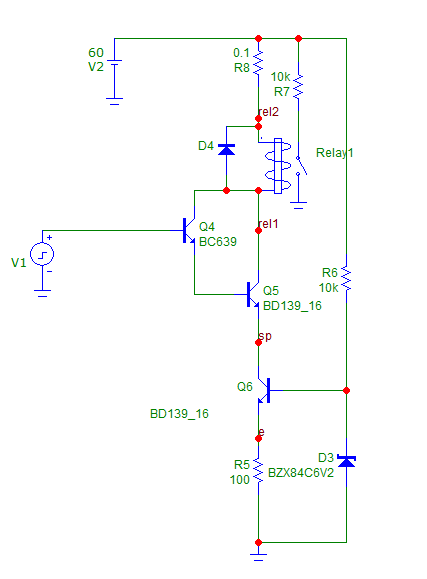

I was using the relay driver as attached. There was no advantage to omit D4, on contrary, D4 helps to restrict coil transients.
