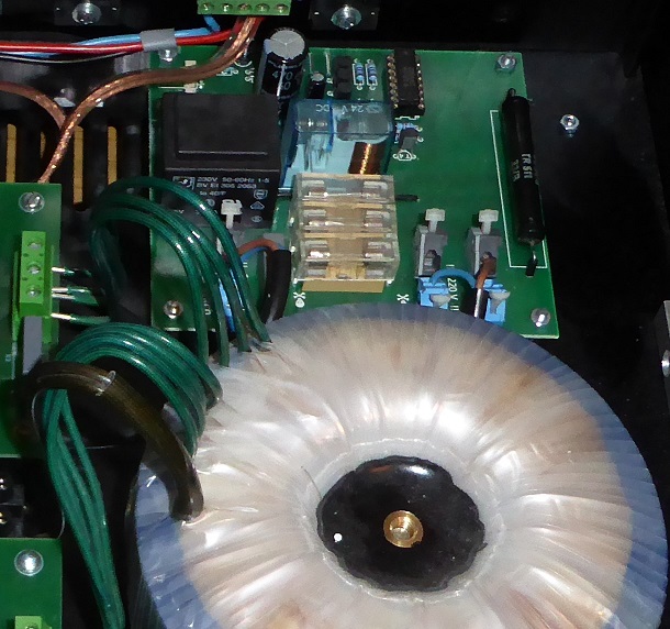

Inrush current limiter working with CMOS logic (timing) and standard approved fuses, shown in the photo. Absolutely reliable, numbers of them working in many amps.

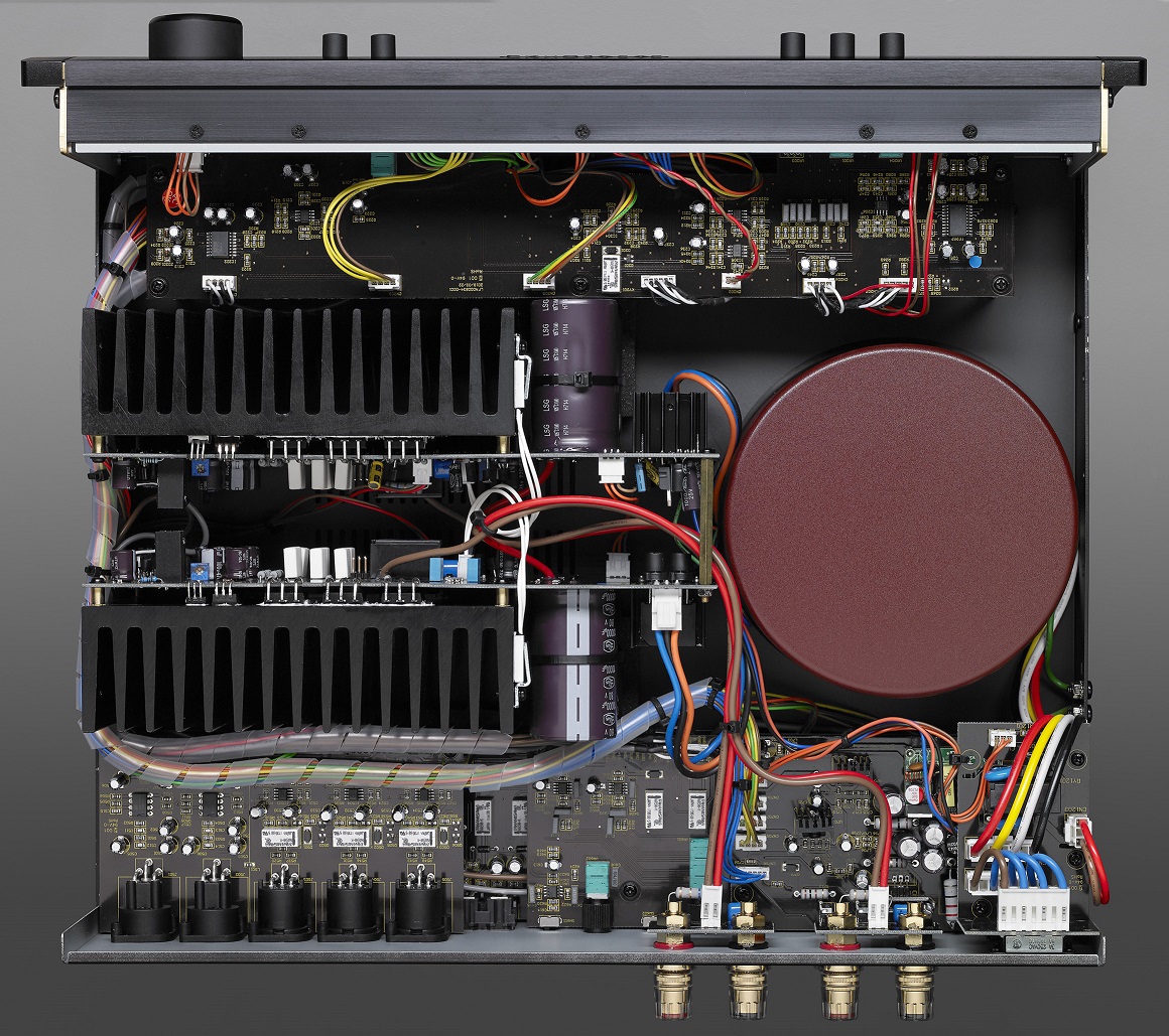

Edit.....here’s the internals of the one I have (V 1.0)
https://www.parasound.com/product-images/hint_black_inside.jpg

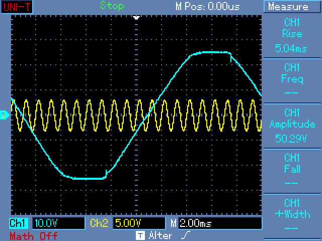

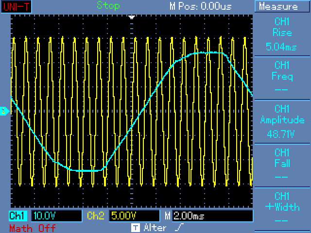

Next an amplifier drawing a mere 120 watts from a 120 volt AC power line does not draw 1 amp peak current (what the fuse responds to!) It easily will see a minimum of 10 times that. So the simple fuse resistance will make a 12% difference in maximum power output. A level that would be considered perceptible by most.

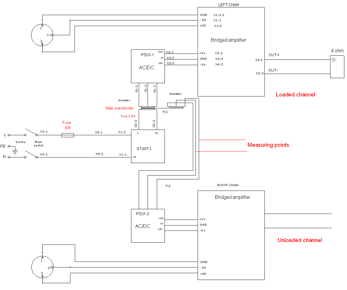

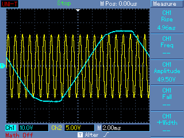

Ed, I was curious when reading your post 😉. So I made some measurements, to get a bit rigorous. I used an amplifier rated at some 2 x 120W/4ohm. The block diagram is attached. It is a bridged amplifier, so it has quite low supply voltage. The amplifier has one transformer with 2 separated secondaries for the two channels. I loaded left channel with 4 ohm and changed output power of this channel from 0.1W to 114W. The second channel, the right channel, was left unloaded. I measured transformer secondary voltage of the unloaded channel, which should reflect the primary voltage changes pretty well. Here are the results I got, shown as secondary power in W/Vp-p (peak to peak) secondary voltage.
0.1W/50.29Vpp, 3.6W/50.29Vpp, 26W/49.9Vpp, 57W/49.5Vpp, 114W/48.71Vpp. One can see that at 114W Vpp voltage is still 96.86% of the Vpp at negligible output power. There are 4A and 2.5A fuses used as shown in the schematics. So nothing like 12% drop. CH2 of the scope shows only one output of the bridged amp vs. ground. Output bridge voltage is twice higher. CH1 shows AC voltage at measuring points described in red.

Pavel,
A 4 amp 3AG fuse should have a cold resistance of .031 ohms. So at 230 volts AC line 114 watts out should be a current draw of .5 amps or so. Thus the fuse voltage drop would be .015 volts if the current draw had a power factor of 1. I expect it might go as high as .15 volts peak. So the compression you are seeing is more likely the transformer's effective losses and other issues.
However voltage at .9686 ^2 is 93.8% power so you have a bit more than a 6% power loss. (Could just be 12% both channels driven!!!)
BTY why does it have a 4 amp fuse? That would be 920 watts at 230 VAC mains voltage. Is the amplifier that inefficient or just to handle inrush current?
Ed, there is one more 2.5A fuse in series (see the schematics end description), however I agree that fuse voltage drop would be negligible compared to transformer losses etc., so I am wondering if I understood your post well, where you speak about 12% of amplifier power loss because of the fuse.
I looked at the schematic and saw the one 4 amp fuse so if you added a second 2.5 amp in series that would add .081 ohms so the voltage drop would be .5 volts or so from the fuses maximum.
From prior measurements and using a 1 amp fuse as a reference I can see just the fuse causing 12% loss. You seem to have 6% system loss with an AC line voltage twice of what is used here. But you also are 50 Hz. and that would make things a bit worse.
I did go back and look at my now 6 year old tests and see that it did include all losses and some of the units tested lost 30% of the expected power! (Cheap 70V transformer output amplifiers tested on the 8 Ohm output.)
