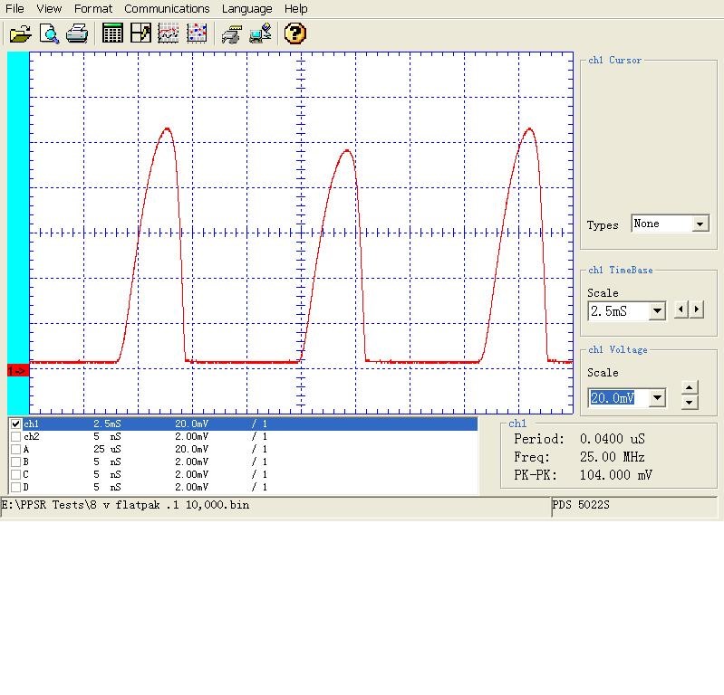

Wow do you really not understand something so simple. A miniature fast blow fuse rated for 12.5 volts AC as you referenced is not even close to the types used to fuse the AC power line of an audio amplifier. Try an appropriate data sheet.
313 Series - 3AB_3AG 6_3x32mm Fuses Cartridge Fuses from Fuses - Littelfuse
Next you don't have a clue as to what the current into pretty much any audio amplifier looks like. It doesn't draw any current until the charging voltage from the transformer diode combination voltage exceeds what is stored on the filter capacitors. Very rarely do you see even a 5% sag on those capacitors. A 10 times surge is actually quite low for peak power but not unreasonable at a moderately loud listening level. I and many others have published this data and you are too freaking lazy to even look at what is out there.
The transformer does some some effective internal equivalent resistance, but a transformer would be useless if the efficiency in the power supply was 10%, the amount needed to drop the peak level to the average level!
Pretty obvious to most anyone, a short on the secondary of the transformer, power supply or even output transistors will cause the primary fuse to blow.
Attached is a simple shot showing the current peaking more than 10 times above the average current on a small transformer suitable for a pre-amplifier. Power transformers have much lower effective internal resistance.
Lets see any data you have measured!
