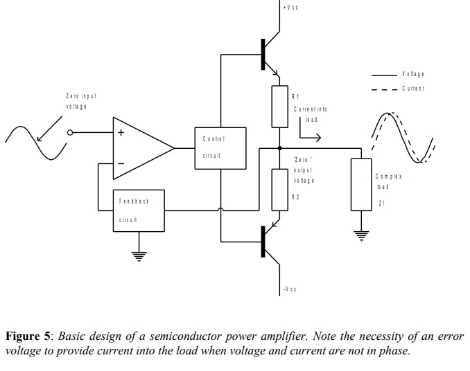

At the risk of attracting hate mail I would like to point out some wrong ideas (as if there are not enough). In Why do amplifiers sound different? there is this figure. The caption is incorrect, any feedback amplifier has an input error signal the phase of output current to voltage is irrelevant.
In fact for a basic "blameless" dominant pole compensated amplifier the error signal is in quadrature with the output signal. My favorite example is using a triangular wave (constant rate of change) as stimulus. The input error signal is the derivative of the output or in this case a square wave. The point often missed is that the feedback responds instantaneously (within the closed-loop BW limitations). Anyone can set this up in even the most basic lab, an op-amp connected as an inverter and look at the input error signal, nothing could be easier. So the delay and feedback goes round and round arguments are just simply nonsense.

So what is new about this?
