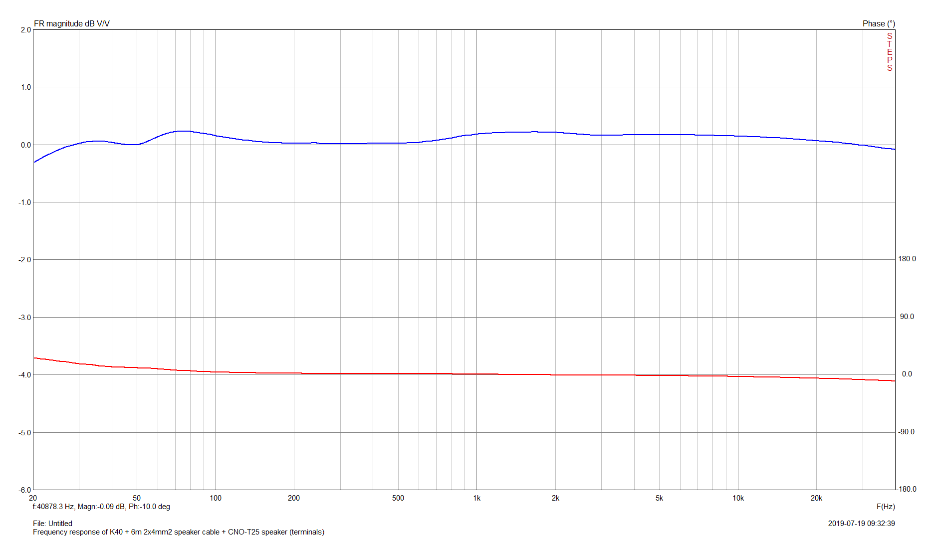

Frequency response with 6m speaker cable
So this is what the ignorant EE like me would do to show the electrical amplitude and phase response of the whole audio chain, including preamp and power amp, cables and speaker, measured with 6m of 2x4mm2 speaker litz wire cable at the input terminals of the speaker box.
I am expecting to see similar measurements by JR, RNM and JC, instead of stylistic word essays.

Ummm. So what?
Measure the group delay instead. More insightful.
