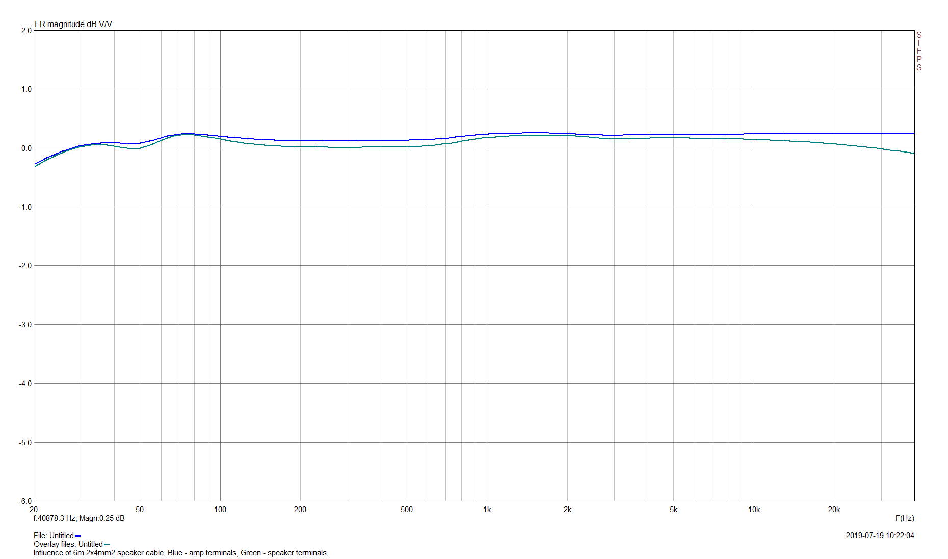

This is the effect of 6m, 2x4mm2 speaker cable to amplitude response.
Blue - amp terminals
Green - speaker terminals.
Wow, 0.1dB in the audio band and 0.3dB at 40kHz. Really "big" effect .....
What if one connects the beloved SET tube amp or a no feedback amp? 😀

BR tuned at ~45 Hz?
Exactly, maybe 46, 47. Small 2-way column speaker.

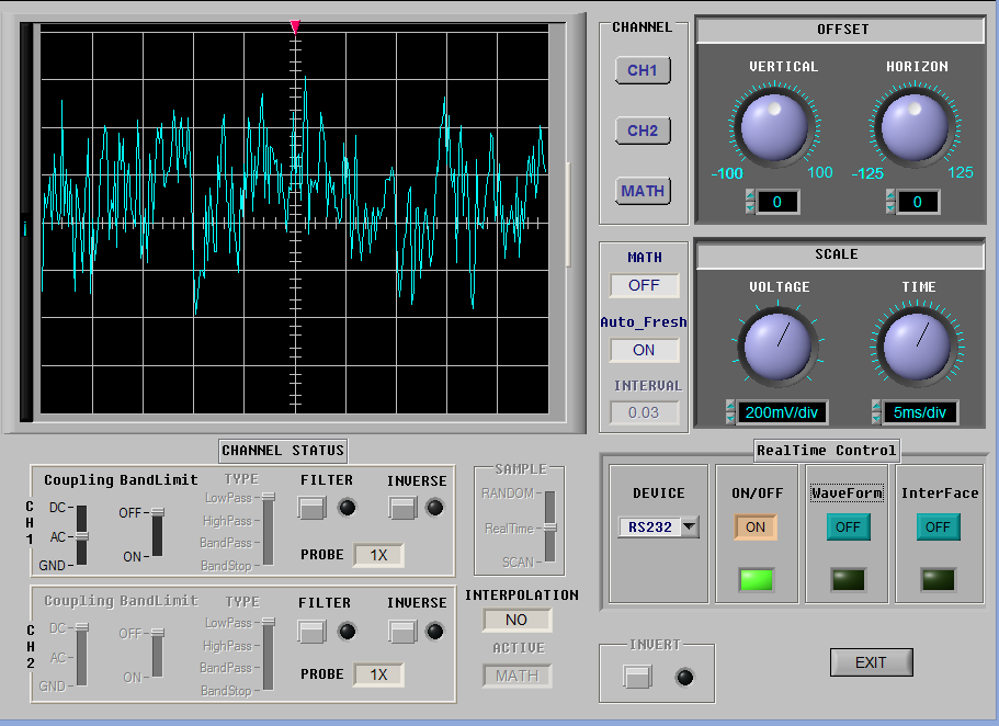

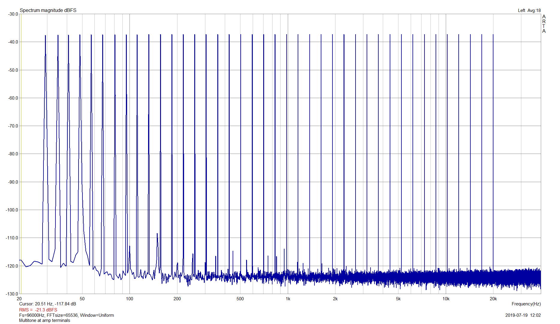

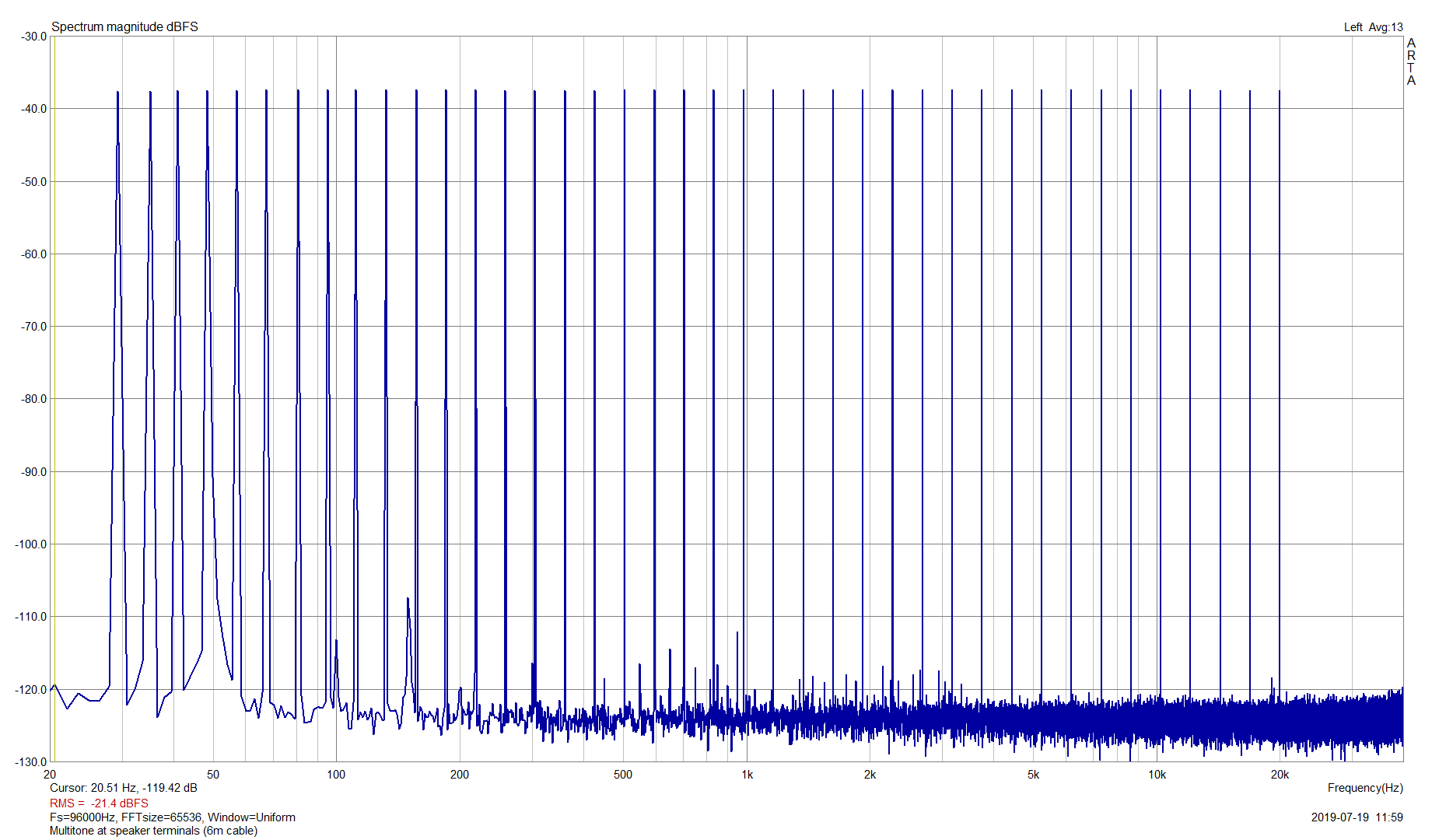

Briefly made some multitone measurement at amp terminals and behind the 6m cable at speaker terminals, cannot see much difference else than the wire loops are very different, so there is some change in mains components. Hundreds of mV peaks, I would need to measure by scope if needed.Newell/Holland reported in their book some results from Voishvillo, Terekhov and Czerwinski, showing the differences (spectral content;multione test signal) [/url]
Edit: multitone time plot attached

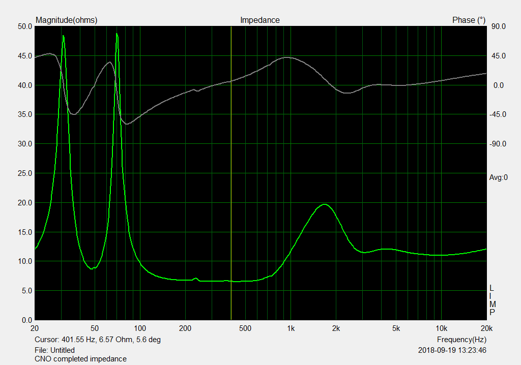

Here is the impedance plot. The small irregularity peak at about 220Hz was due to box standing waves and was damped later.

Looks like a quality bass driver in a well aligned enclosure.
Thank you, I appreciate your comment as you are specialized in speakers.
You are applauding to measurement and experiment errors.
