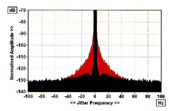

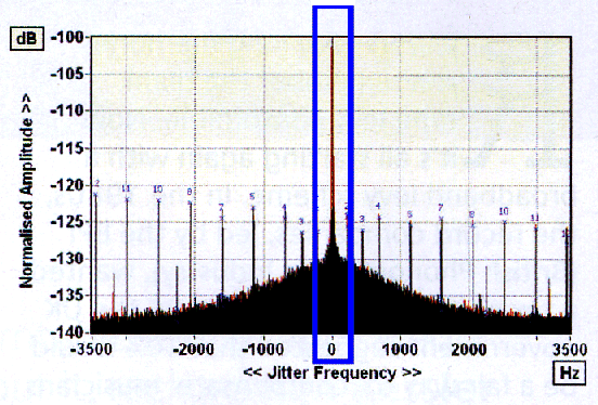

I have some KAMCAP Supercaps here 0.33F 5.5V and datasheet:
http://tinkersphere.com/documents/1F55VSupercapacitor_Datasheet.pdf
The specs are very typical and similar to others of various brands I have tried, like those readily available on eBay.
The rated ESR is 44R and I measured a 79mA initial peak when connected to +3.3V and that coincides well as 3.3/44=0.075 (75mA). But no power supply comes on instantly so I suspect that charging up the reservoir caps just after the rectification means that the 79mA is not actually reached. So far I have used/done this hundreds and hundreds of times and there has been zero failures.
Since the ESR value is high in supercaps, I believe that the energy stored and that ESR means that the benefit is down to a fraction of a Hertz' with low rate of change (did somebody just refer 1/f noise). Paul Miller in the UK has referred to "Uncorrelated Noise-Like Jitter" and came up with the measurement below, note the high magnification required.
People here can make up their own mind. But what is so obvious is anybody can try it, since you can buy these 0.33F/5.5V supercaps all over the place now. Put on the power supplies of DAC and the usual =3.3V on the oscillator (assumes that it is a powered oscillator). Then you can comment on what you think is happening and what it does to the sound. Fair enuff?
1 PCs CAPACITOR SUPER .33F 0.33F 5.5V SUPERCAP Radial SUPER Cap | eBay
[Edit: Seems something wrong is happening to the above link, so will also attach below.]
