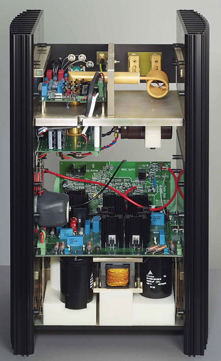

It's very hard to extrapolate, since the result depends on the amplifier load (current through the coil), output power, overall 2nd harmonic distortions (if that's rather high, you will barely see an improvement), coil diameter and length, amplifier wiring, etc... But sure, attached is the distortion spectra with the output inductor off board. After removing the inductor, the 2nd harmonic went down by 19dB (almost 10x less 2nd harmonic, at this very low level).
3 pairs of lateral mosfets, biased at 150mA each, 100W/8ohm, coil is 15mm dia and 25mm long (2.5uH) amortized by 3.3ohm, frequency is 20KHz, THD @20KHz with coil on the board 0.001%, coil on board, and 0.0001% with the coil off board (as shown). It is expected the on board coil effect to scale more or less linearly with the current, so with the square of the output power.
This was an extremely careful construction (the PGP) with regards to stray magnetic fields and induction (bringing a steel screwdriver around the on board coil was immediately visible in the distortion spectra, as a 10-15dB extra increase in the 2nd harmonic distortion). I can't even imagine what would be the effect for a conventional amplifier wiring, since I never placed an output coil on the board since, not even for much more relaxed YAP amp.
P.S. Found another pic, the 20KHz distortion residuals, with the coil off board. As you can see, almost entirely 3nd harmonic. 2rd harmonic due to magnetic effects are the small ridges in between, placed at the load current peaks.
Thank you for your effort.
Do you have information how much the value of the coil inductance change that influence? I use 0.5uH up to 1uH as I try to design an amp to be stable on capacitive load with that values.
Unfortunately not. All I can tell is that the mutual coupling factor is inversely proportional with the number of turns.
Speaking of this, find attached a photo of the innards of the Halcro DM88 amplifier (the lowest distortions commercial amplifier ever build, as far as I know). Not only do they have the coil off board, but they placed it in a special closed (and I suppose shielded, check out the walls thickness) compartment of the chassis. Guess why they bothered to do this.
