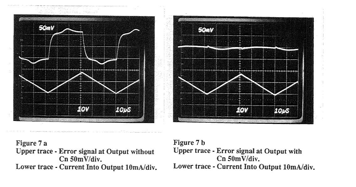

I published this 27yr. ago. It's a simple demonstration of cancellation of the so called "back-emf" by the addition of a single capacitor (AD797). When Walt Jung did his super regulator for some reason he thought that somehow this was too confusing to include. Bruce Hofer of AP is the only person at the time that appreciated this.

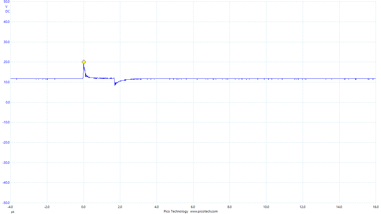

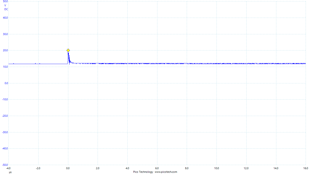

Briefly from my archive. In-wall adapter ripple, power bank ripple, power bank output spectrum. Components for RME-ADI2.
Yes it is, as a power supply noise. Remove DC by a simple HF filter and then measure the rail by scope and frequency analyzer. You can get sensitivity as high as you wish and BW as you wish.

But... stability is being spoken of in relation to the device being powered during processing dynamic signals & hence the current requirements of the device are dynamically changing. Hence the noise stability of the PS is what is in question under these conditions.
So of course I would believe these measurements need to be taken when the device being powered is processing dynamic signals.
Any measurements for such conditions?
Thanks guys
Yes, of course 🙂. It is a sudden jump of load current of about 1A. But please take into account this is an input DC voltage for the RME-ADI. Inside is the additional voltage stabilizer, I was asked to measure input DC.
