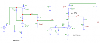

I was playing with similar tube line stage:

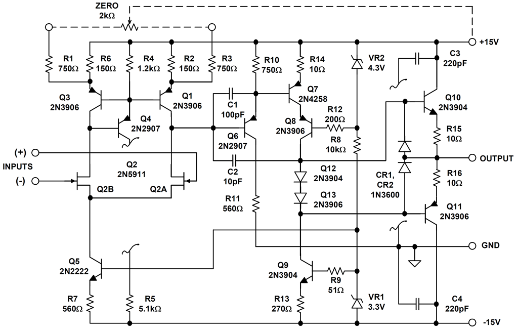

Guys,
As we have been spending time bashing how bad 1970's Integrated Circuits where, here is the schematic of one of these that originated in 1973.
I find it rather good...
Noise will be a bit high by modern standards (around 7nV|/Hz at 1KHz and 14nV|/Hz at 100Hz) but slew rate and bandwidth of this circuit where quite good and many modern "Audio Grade" Op-Amp's are dramatically worse...
Ciao T
Folks,
Guys,
Ciao T
Seems at least on my browser the schematic does not display, here as attachment instead...
Ciao T
