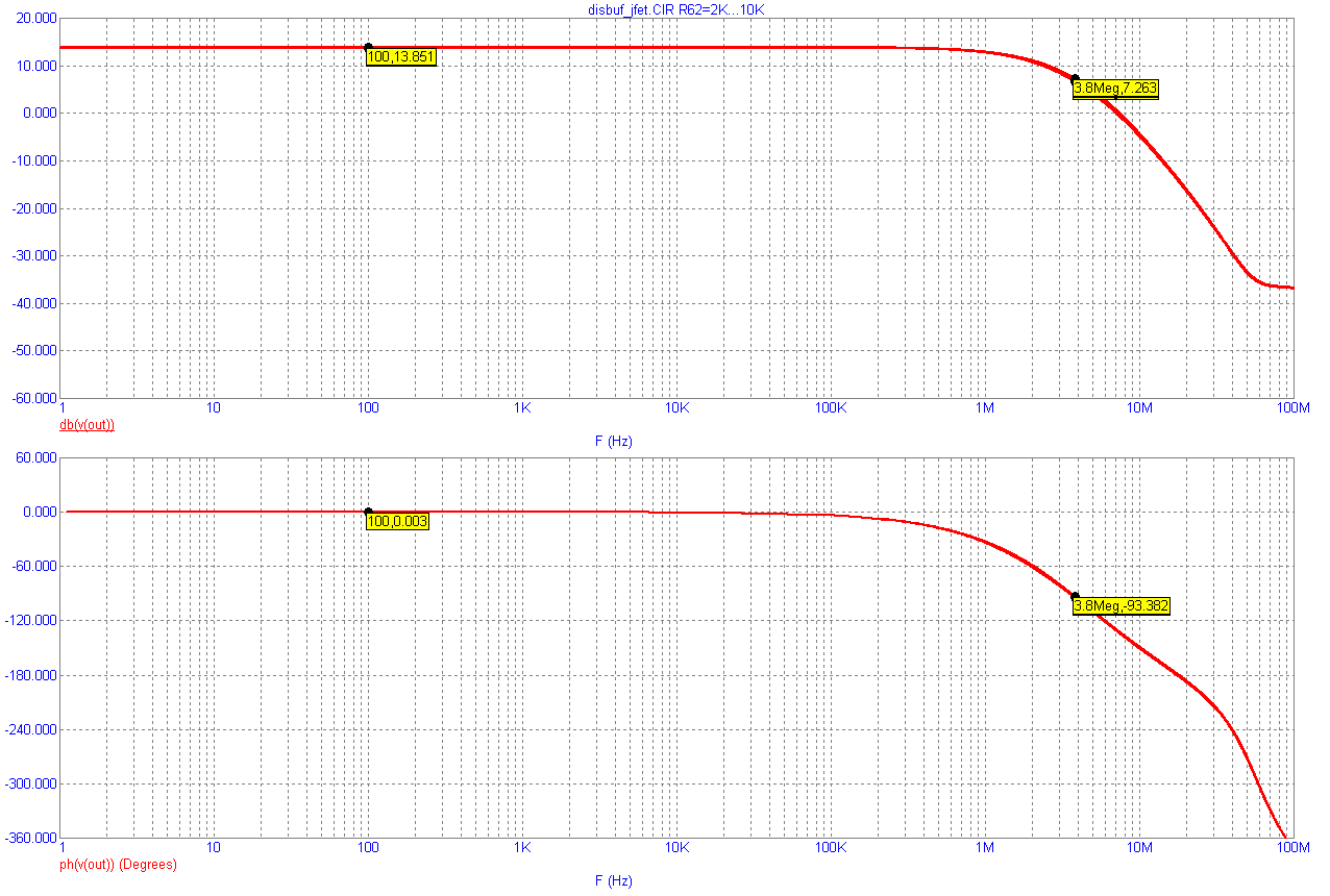

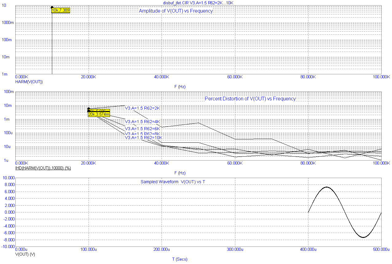

This with the lowering of gain with a shunt to GND, can be made by making a current output on a open or local loop circuit..then the shunt resistor will define the gain, and thus the voltage swing into at High impedance buffer..only problem is as you reduce gain, you also reduce the possible voltage headroom...
This is whar I get with resistor VAS load. Just increasing distortion, nothing else.
