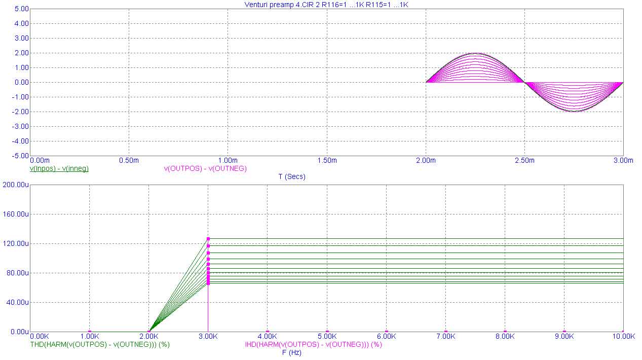

This is what I'm getting with a VGT (Variable Gain Transimpedance) volume controll, by stepping the volume controll resistors (I'm not even using all the "tricks" to get a low THD). It is ofcourse an open loop design.
BTW: It's an all BJT design, no obsolete parts.
Simulation is done by factory models.
Cheers
Stein
Sorry the file is to large, I'll reduce it.

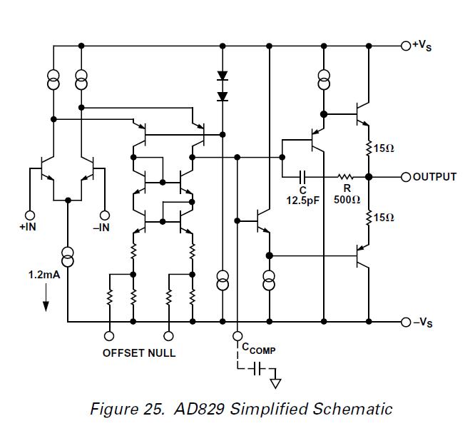

The confusion still remains, take an amplfier with a 100MHz GBWP and make it have an Aol of 10^7 so open loop BW is 10Hz with some super process ultra-high Early voltage whatever and then make the >SAME< 100MHz GBWP amp have an Aol of 10k with an ordinary/bad process and an open loop BW of 10kHz and make a closed loop 20dB amp out of them they both are 10MHZ closed loop BW (within a very small error).
What John means by open loop BW is the 10Hz or whatever corner where the DC open loop gain breaks not the GBWP.
You could almost do the experiment with the AD829, it has an Aol of 100dB but I bet it's linear enough to feedback to the null pins from the output to push it up to 140dB or so. This part has lots of pins available, unfortunately the cap load helper R/C loads the VAS and is horrible for distortion even with no cap load (not my idea).

Scott, I think it is cheating, since everything is optimized for low currents and high dynamic load resistance. Loading VAS only screws down input stage as well. Also, an output stage expects deep feedback around. High OL bandwidth opamp has to be designed, it is not enough to take low OL bandwidth opamp and load VAS on plain dumb resistance. It is a complete different story.

It depends on the circuit design. In some circuits, you may get lower distortion with the VAS loaded, especially by a particular, selected resistor value. It usually is the case when input pair is not tailed by CCS and has some degenerating emitter resistors. In my bipolar input Dispre 2 there is a heavy emitter degeneration of input LPTs and these resistors are supplied by resistor, not CCS. It works like tail current modulation (discussed currently), but has pretty bad CMR. Together with certain, defined resistor VAS loading the non-linearities subtract and you get minimum of distortion. But this concept is not universally transferable.
PMA, my take on it is that it 'quaisi' voltage drove the complementary transistor darlington output stage, as the nominal drive Z was 100 meg ohm, was reduced to 1 meg ohm. I stand by my conclusions, until shown different. It is easy, not that difficult, especially when I came into electronic engineering in the '60's, when we believed in non-linear beta as the fundamental distortion contributor.
Excellent PMA many are fooled by fortuitous cancellation (I wish I could forget). 😉
What a breakthrough! A more than 100 cancellation of the distortion, primarily at 60 Hz, in an IC with a 1 meg added internal load across the driver stage, AND a slight improvement in slew rate.
John;
it does not mean that any ic would benefit from such modification. I believe Scott's designs are very well optimized, so all attempts to improve them may screw down results of his efforts.
Why don't we instead compare apples with apples, shall we?
Let us say we have a discrete OPA with 120dB DC Gain and 20Hz bandwidth with an SE class A output.
Due to the vagaries of epectronic design the 20Hz bandwidth corner is modulated by around +/-2Hz over the whole swing of the OPA VAS. What is the effect in band for a 20Hz-20KHz bandwidth? Non-Linearity (whatever you want to call it) from bandwidth modulation.
Now let us take the OPA and degenerate input by 20dB and VAS by 40dB (Yes, this will loose us output swing and increase noise, we may need more supply current, all no-no's in IC design, but "fair game" for audio). We will find we need to change our compensation to a much smaller one as well.
We now have appx. 70dB DC gain (because the VAS operates in current input mode, and degenerating raises it's input impedance and thus the gain if the IPS) 70dB gain at 1KHz and even close to 70dB at 20KHz. There is no or very little bandwidth modulation, as the parameters that cause it are all stabilised much better due to degenerating the devices Gm.
What is the in band effect? The previous distortion mechanism has disappeared and the whole amplifier behaves with an equivalent linearity to the above for other non-linearity factors.
So, here we have a simple case where widening open loop bandwidth does help to remove sources of distortion without penalties elsewhere.
