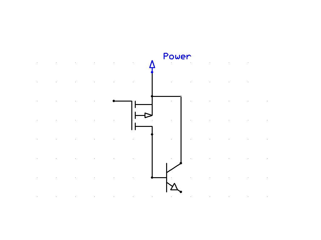

You mentioned doing a compound output stage with bipolars driven by complementary Fet (Mosfet?).

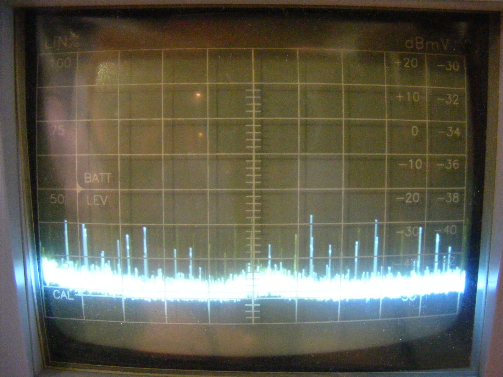

Previously I asked how many hidden common base/gate circuits are in an amplifier. I also showed the noise potential of power supply types.
Attached is the noise measurement results of the type of power supply I would expect in a power amplifier.
So if you use a complementary device off of the rails you have in effect a power supply noise follower.
I prefer to use a small split output coil transformer to provide a higher voltage drive rail and stay with followers that are driven by signals inside the cleaner (when designed correctly) core.
Please let me know what results you get.

Can you provide a circuit or reference? The description is a little to terse and I would like to better understand what you are describing.
The noise on your spectrum looks to be mostly power line related and less a function of the rectifier/cap combination. That is a really complicated problem to solve short of batteries.

The noise has my noise generator added to the normal stuff that is there. We agree it is almost impossible to get rid of it. It is also at this point of very low source impedance. That is why I prefer not to couple it into the output.
Although the gain is one, using a standard follower allows other active parts to reduce the noise in the drive path.
ES
Thinking about it the voltage gain on the power rails noise is actually above one and will vary during operation!

Not really. I mentioned a SFEF2 - that is a source follower driving an emitter follower.
You are right in EXPECTING such a supply, you would not catch me using one anything I'm serious about.
At the absolute minimum I use CRC Filter (yes, for poweramp's) with the second capacitor bypassed and snubbered. I normally set the R in RC filter to appx 30% of the effective DCR of the supply (that is if the supply drops 1V output voltage for 1A load I use 0.33 Ohm - 0.33 Ohm & 10,000uF form a 50Hz lowpass.
In AMR's amplifiers I design some R L directly into the PCB Layout, the big am has a 4 Cell RC filter at 100Hz per section and THEN a regulated supply...
For my current Pet Project I ordered some 1mH/50mOhm/10A chokes wound on Manganese/Iron torroid cores and a bunch of 18,000uF/71V Elna "For Audio" PSU Cap's.
Each supply will use a separate transformer winding, hybrid fast/soft & schottky rectifier bridge two cap's and two chokes with one choke in each line.
This supply has around a 10Hz turnover and -20dB at 100Hz with only 0.1 Ohm added DCR. Due to the ESR of the Cap's (including bypass) resonance of the Chokes the filtering is limited at 120dB around 500Kz but filtering remains significant (> 60dB) well into the lower two digit MHz.
Sorry, but working mostly with open loop circuits I have a fetish about PSU filtering and damping any resonances in the supplies. Even in circuits with ton's of feedback I find the audible problems introduced with generic circuitry rather troublesome.

OK I misread what you were doing. I avoid Sziklai bipolar outputs since all the ones I am familiar with fail long term.
It seems you have a good handle on how to handle power supply noise, although a bifilar common mode choke is often used to avoid dc saturation.
I like to use small caps across the rectifier diodes as they not only help damp any residual switching noise, but all four also end up as equal to just one straight across the filter cap. The inductance of the diode to cap wire helps to form an RF filter.
So how do you handle the Vas stage to avoid the same voltage rail issue?
Looking a bit more at it you will have some rail noise voltage gain in the output devices reduced a bit by Cis. As the rail impedance is almost zero and the load above that the issue still creeps in.

I would not do a bipolar Sziklai, the bias is just too twitchy and loves to run away. Lateral Fets in both positions are a slightly different proposition on thermals.
With Bipolar outputs incidentally I would classic followers with a normal Bias Spreader, which is AFAIK what JC does.
