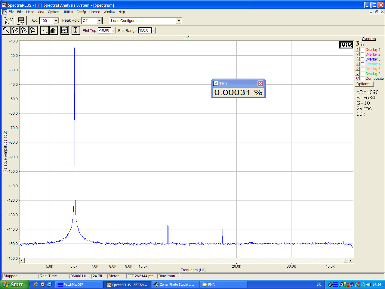

I have finally fixed the problem. The case was UHF oscillations in the circuit application (ADA4898 + high power buffer) that occurred after clipping. It (oscillations) was not seen at the output. After change of frequency compensations this effect completely disappeared and I can confirm that to me the ADA4898 is one of the best sounding audio opamps I have ever heard.
I wonder how many folks never catch this. I had one listening session where the guy said that oscillation at 60MHz did not matter because it was not audible.

Has 'opamp_distortion' independently tested this device?
Would you kindly explain what you mean 'opamp_distortion'?
I have some measurements we made, but they are not a general answer.
