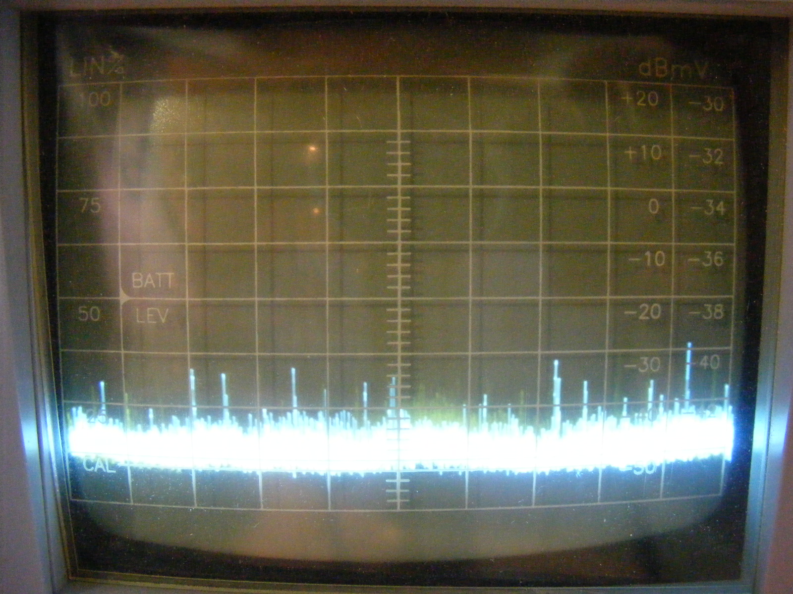

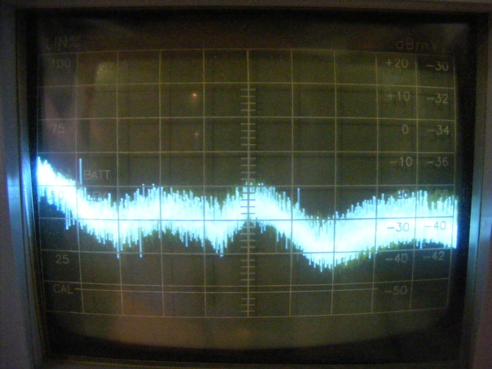

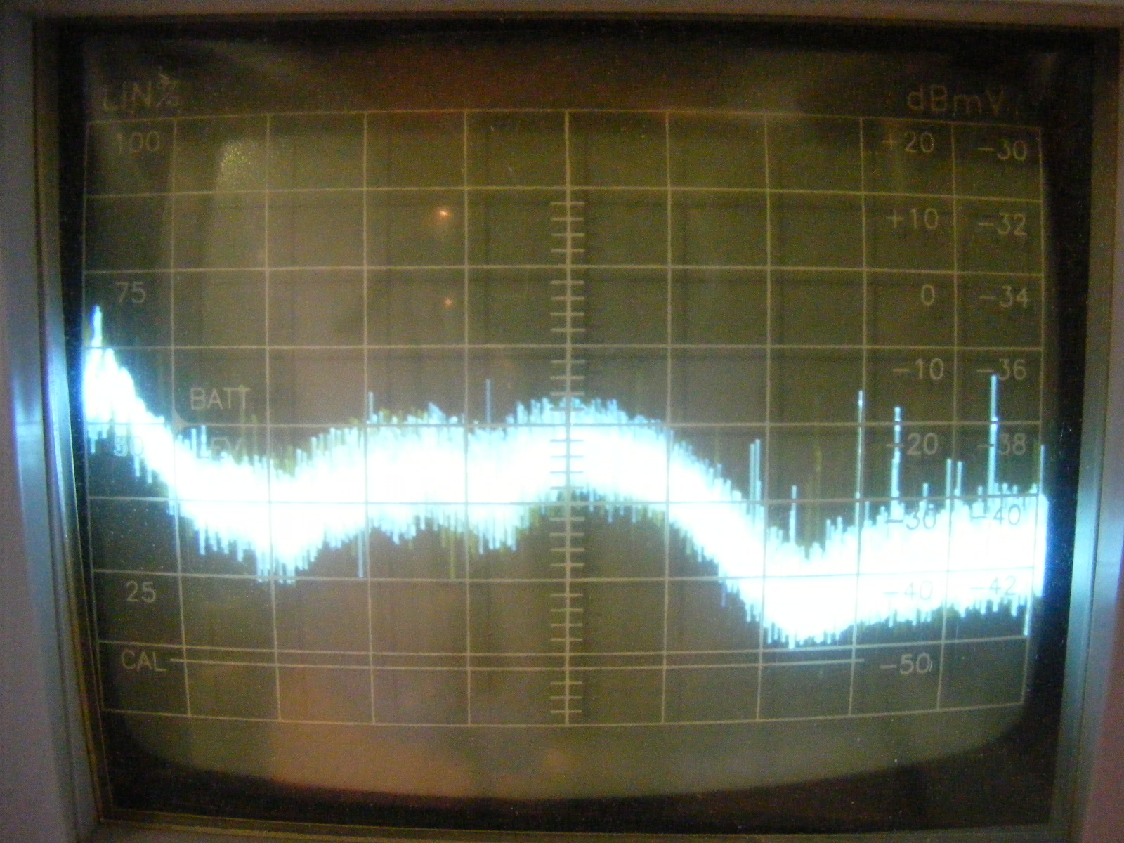

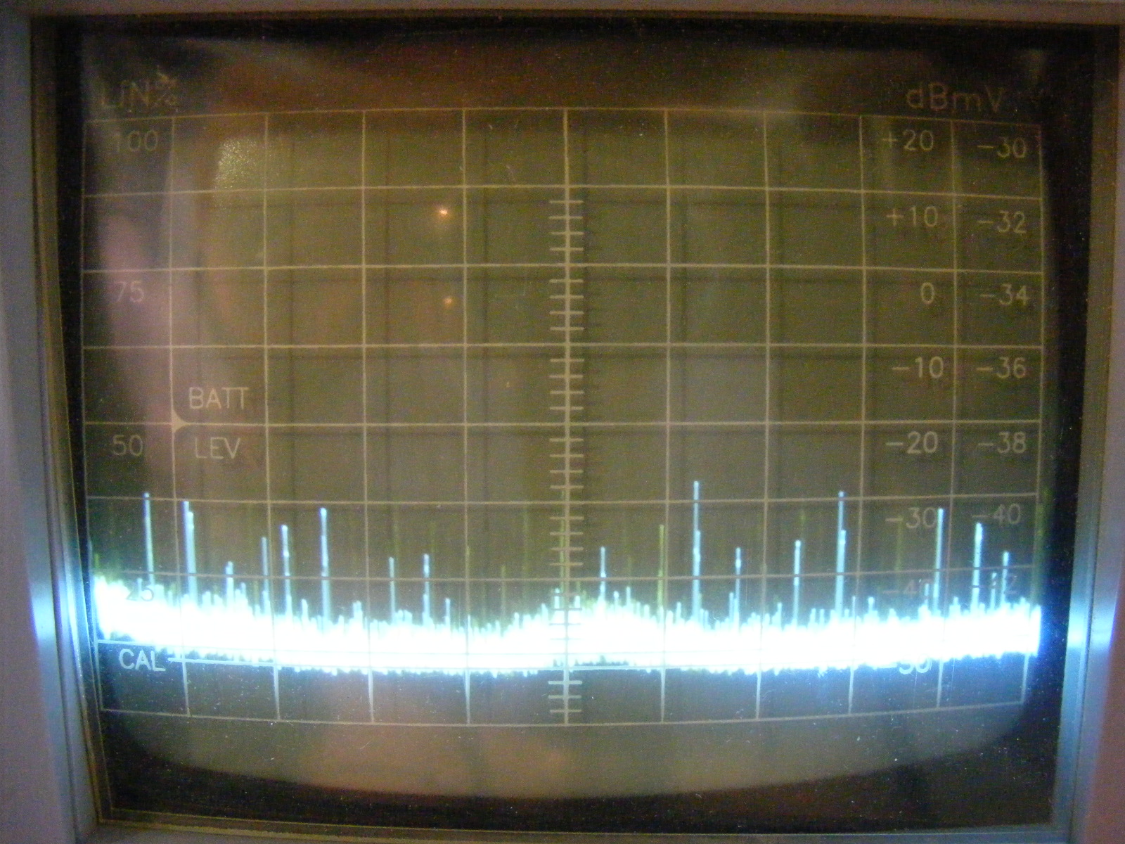

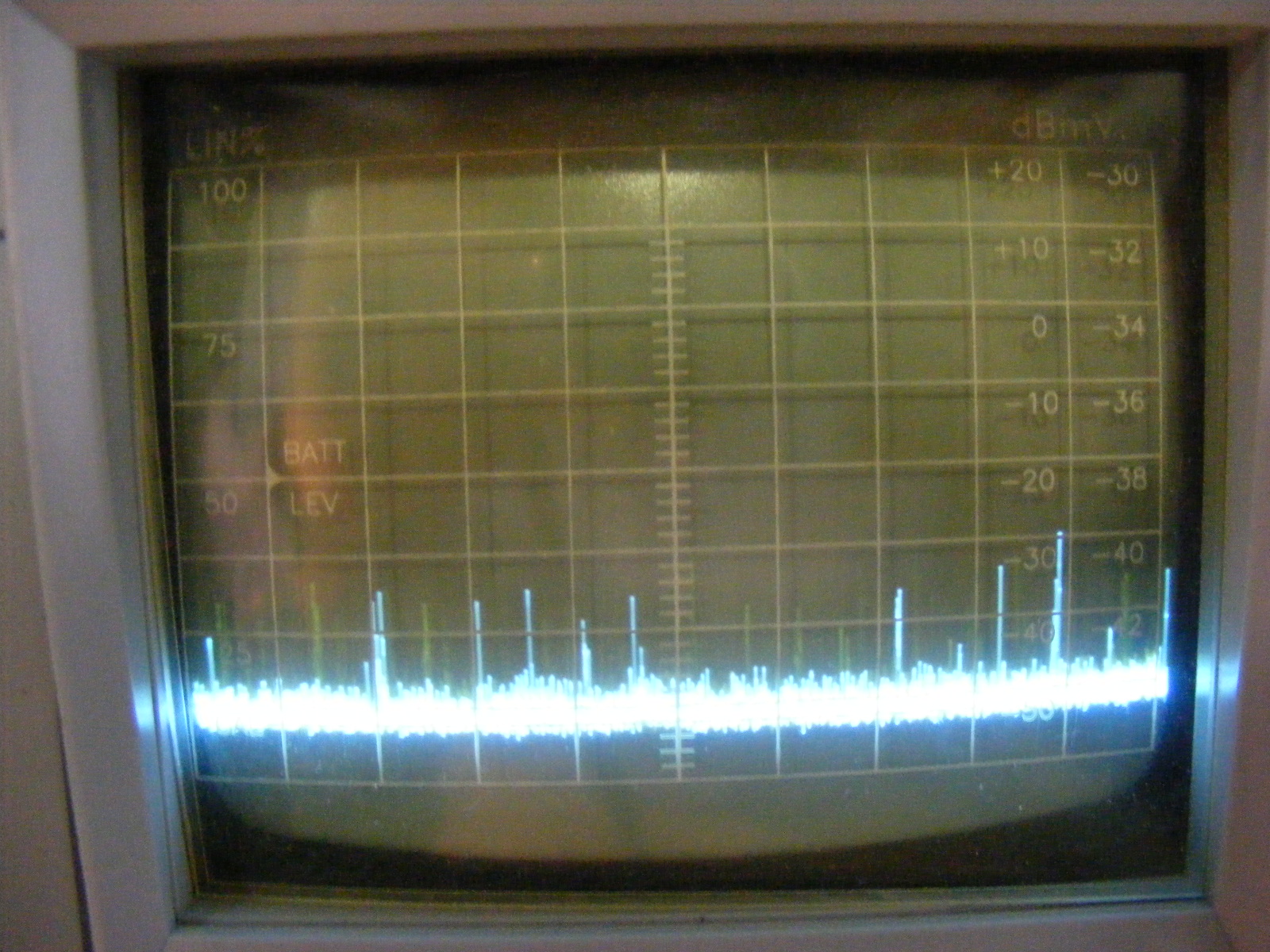

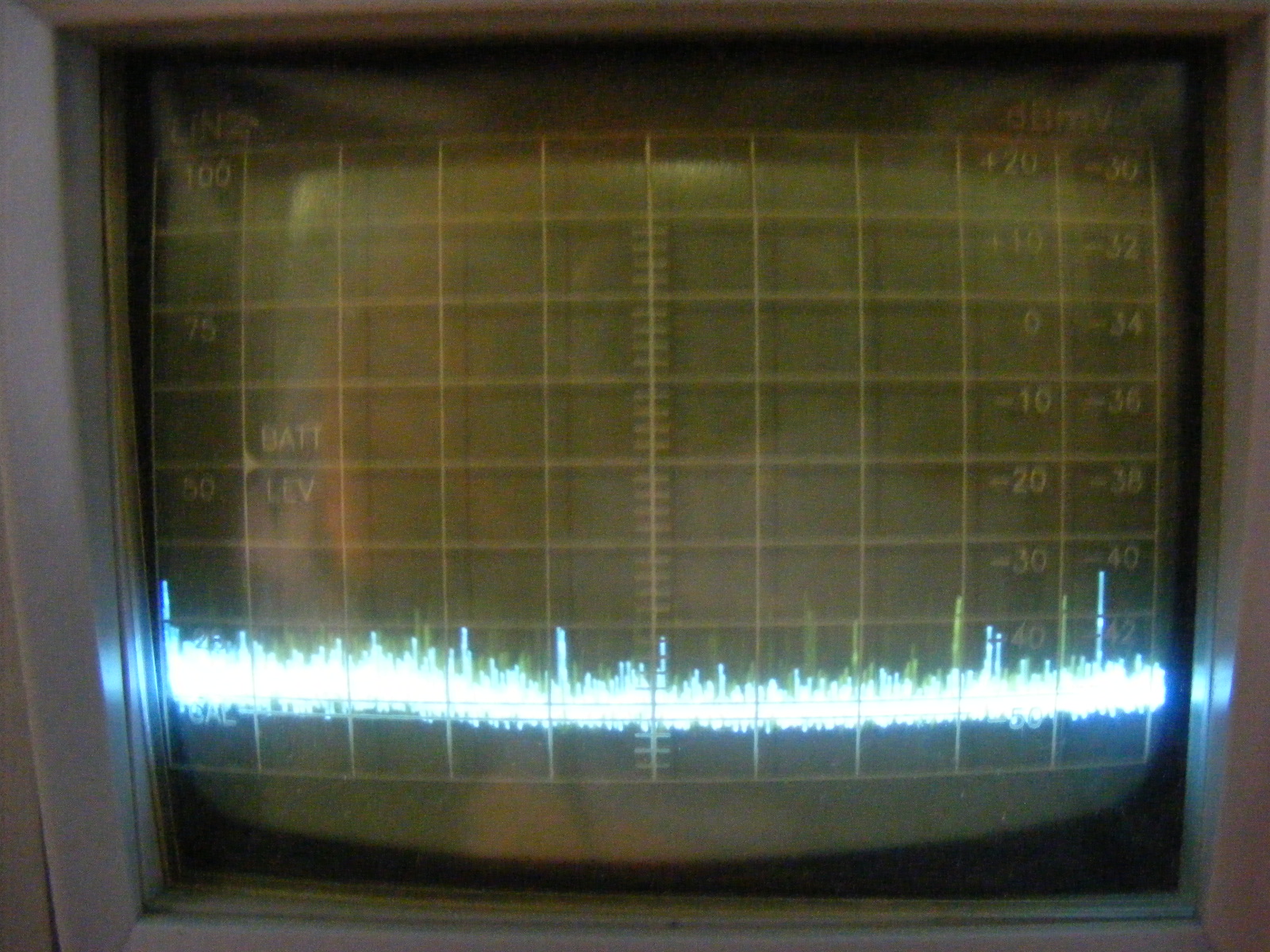

Well I just did some power supply tests.
One test was just how much noise was present on the 12v dual coil toroidal transformer with no added noise.
The second was with my noise generator turned on.
The third was the noise filtered by a 4700/50 capacitor with the center tap grounded.
The fourth was using a full bridge and the negative side grounded.
The fifth added a small ceramic bypass to the 4700/50 capacitor.
The sixth had no extra bypass on the filter capacitor but did add bypasses across each of the diodes in the bridge.
Now try to guess which is which before you mouse over the image and have the label give you the answer!
ES
ES
