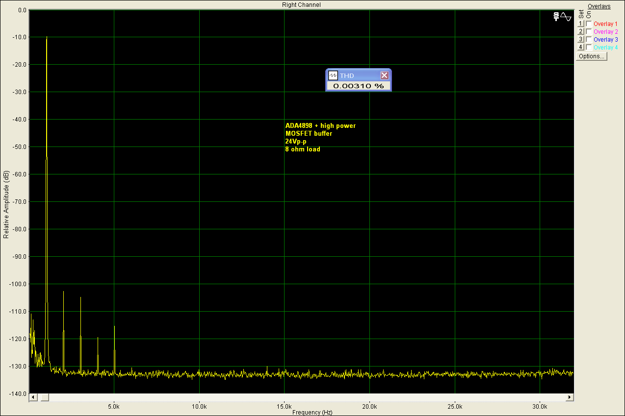

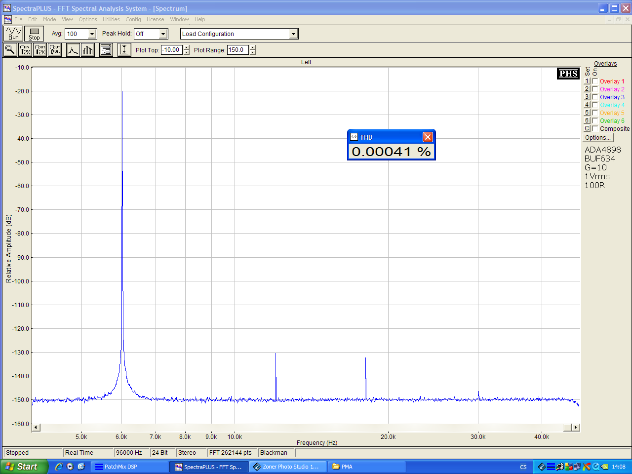

I do not have a 600 ohm record. I have 100 ohm measurements of ADA4898 + BUF634, gain 10x.
For the record, my input load is about 820 ohms at high frequencies, the output stage of the op amp cannot be completely 'starved' or it will not work in this phono circuit.
This should be OK, hopefully. Anyway, I have good experience with opamp output buffering just for the application in a phono preamp - to drive equalization network.
You know, PMA, the REAL problem lies with ADI. Perhaps we can get Scott Wurcer to explain why the output stage cannot drive 600 ohms without excessive distortion. How can we use it WITHOUT an external output stage? A single extra milli-amp might have made it relatively OK. Then maybe not. I'm all for discrete, at this point.
Well, now I have to take it all back (maybe) because SG measured the AD8599 and NOT the ADA4898-1. So I have to retract my criticism of this part until it is proven one way or another, BUT the ADA4898-1 DOES HAVE HIGHER QUIESCENT CURRENT than the AD8599 (7.5ma vs 5.7ma) so there is the missing output current, I would think.

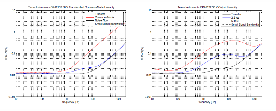

I am sorry, but I have the LT1115 at these pages. No ADA4898 in this book. Maybe I have an older issue of the book.
But there is an OPA2132/2134 in the book (page 184-6). And it has big problems to drive 600 ohm load, and also has poor common mode linearity and output linearity even for 2.2 kohm load.

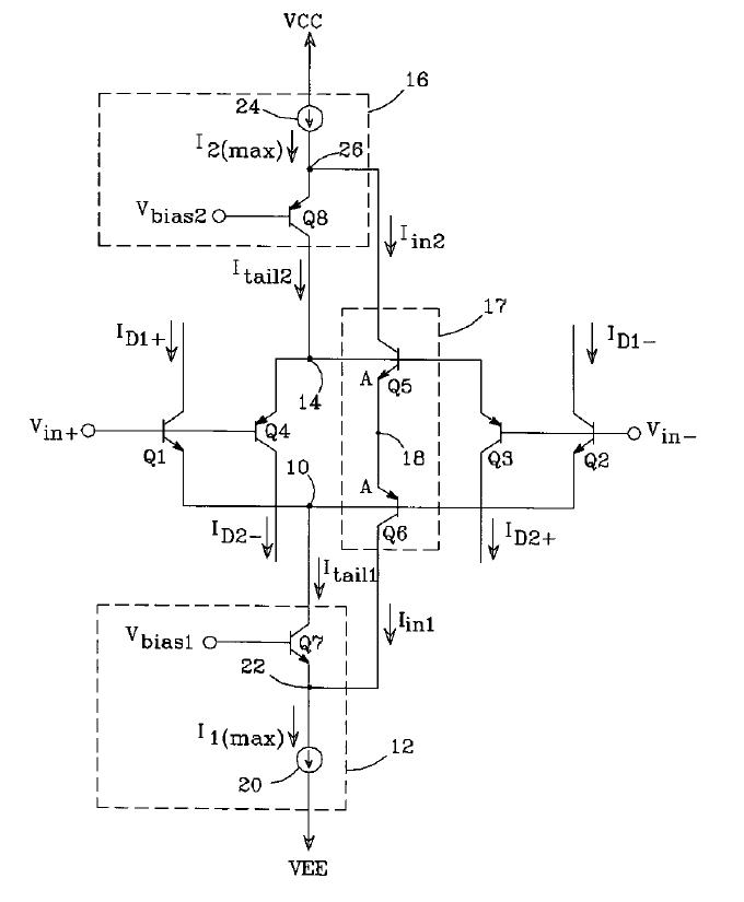

Nathan's circuit is patented US6963244 so it is public record. Nathan is one of those new young guys I was telling you about from San Jose State. I introduced him to Jim B. but that was somewhat a disaster.
Yes PMA, John please download and read the datasheet, this part is specified down to 100 Ohm RL and with total feedback circuits down to 500 Ohms, and don't forget the multi-tanh input completely removes Barrie's PIM mechanism here it is identically zero.
