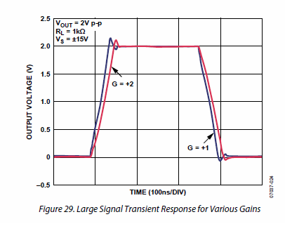

some ADA4898 numbers (from the datasheet) with a little calc
if my calculation from the patent's equation was correct then the gm of the input stage is 1 ppm linear for input differential V of up to +/-4 mV
I also estimate that the output could slew ~2V/us with |4 mV| input difference (the datasheet psrr curves give a good estimate of the audio frequency open loop gain if you know Sakinger's “A General Relationship Between Amplifier Parameters, And Its Application to PSRR Improvement”)
note that this isn't the slew rate limit, or onset of gross distortion - this is for the input stage gm variation contributing less than -120 dB nonlinearity
2 V/us seems like it would cover a lot of consumer line level audio - with essentially no "phase modulation" from input gm nonlinearity
the output stage doesn't look current limited for 600 Ohm load - but does have rather high dropout from the supply V such that 10 Vrms isn't practical

Do you mean 2V/us at the output of the input stage according to the patent?
Please explain, the opamp has much higher slew rate.
Pavel,
Do you mean 2V/us at the output of the input stage according to to the patent?
What is there to explain? The input stage is followed by gain stages, so if these stages are not slew rate limited at all the slew rate of the IC would be 2V/us * Gain. In reality the other gain stages will actually limit the slew rate...
So the OP's point was that the input stage does not introduce any slewrate limit.
Ciao T
