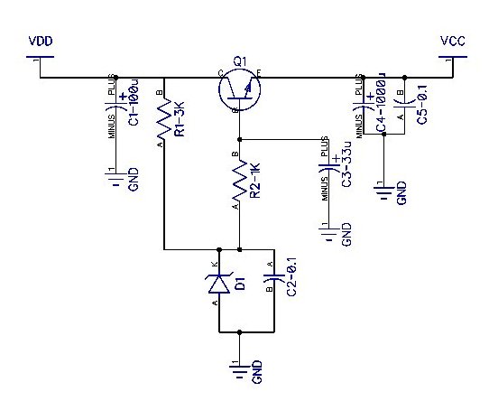

Joshua G, your example has only one major problem. You should put a resistor of 1K ohm or so between the Zener diode and the cap which should be connected to the base of the transistor. This will lower the noise generated by the Zener diode, significantly. In fact, this is one of the major tradeoffs of using the 3 terminal IC regulators, that is: no way to bypass the solid state reference.
John, do you mean something like this:

Joshua, it can be debated whether you need to add the .1uf cap across the Zener. The Zener diode has its own internal capacitance and works well into the RF region. Everything else looks OK.
This sort of design (without Zener) is used with 'real' IC regulators and are normally known as capacitor multipliers. They can be very quiet. Adding the Zener, and resistor reduces the 'breathing' from AC power lines and its potential compromise to the circuit, IF you do not use a 'real' regulator in front of the cap multiplier.
It is best to keep the channels separated by using a cap multiplier for every channel, and even every gain block, in an audio preamp or power amp driver stage. This is because the output Z of the regulator of this kind, while being broad-band, is fairly high, even a few ohms, especially if you add short circuit protection in the usual way. The Levinson JC-2 suffered from this.

What are the differences between such a discreet regulator and an IC one?
Also, aren't Zener diodes noisy? If yes, over what frequency range?

Now that B, E and C of the transistor are nicely decoupled, let me propose a NE68819
from NEC / CEL for Q1. It is not only low noise, but even one of the very few types that have
their 1/f noise guaranteed.

Thanks, it's a low current transistor, therefore not suited for a regulator.
It is important to note here that the 1/f noise of the output device in THIS example is not so important, unless you are regulating very low current 20ma or less loads. Sometimes, however, that could be important.

What in my schematic doesn't apply to the definition in the link?

I think that we are talking about a simple linear regulator, as defined in the Wikipedia, as well as design app notes from 50 years ago. What is the problem? Too simple? Too quiet? Too fast?
Probably not enough feedback (no feedback)?
I don't see what your getting at Jan.
From Wiki ...
Joshua's regulator is a real one.
