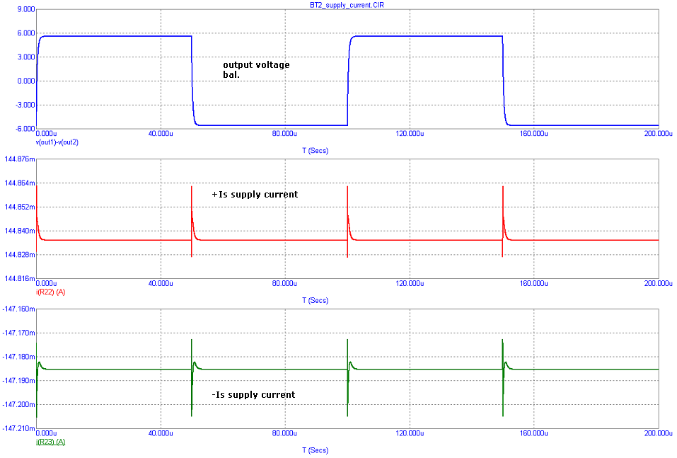

Transients that you describe, do not occur for all practical purposes, in the class A, i.e. constant current loads that I am using these simple linear regulators with. Only relays or digital switching would be compromised.
Can you point me to your favorite constant current load class A circuit? I'd like to run a simulation on it to convince myself.
Sure, run a Blowtorch like schematic. There are plenty of them in part 1 of this thread. This is the Blowtorch thread, so that might be the most applicable.
Well, we may say that Blowtorch-like circuit has pretty constant supply current in both rails:
Thank you Pavel, you just saved me a couple hours of unpaid work 🙂
