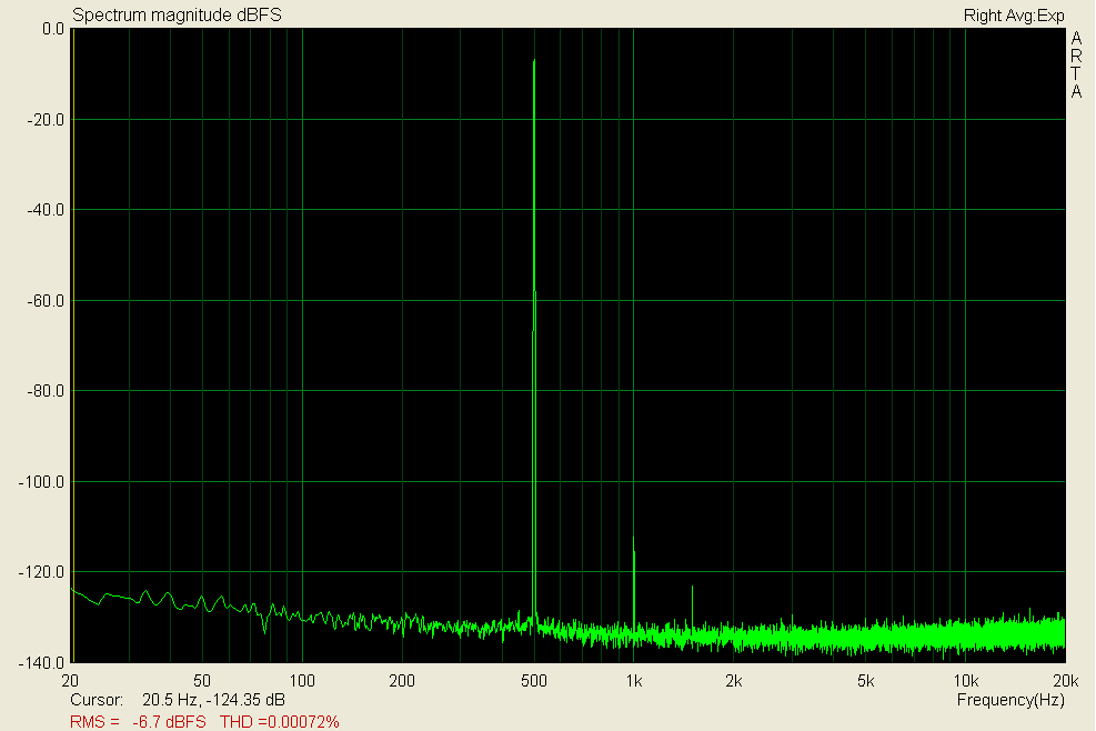

As this enough, for a real preamp, as PSU mains components rejection?
