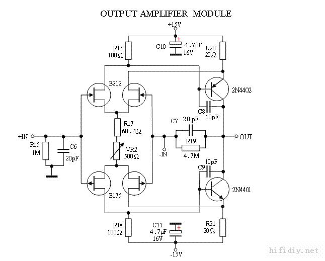

some questions
hi..i have several questions
1)can i use matched bc557c bc556c instead of 2n4401/4402?should i make some changes on the circuit..a
2) can i use this circuit to drive my sennheiser hd25 dj headphones?is the power of preamp enough to drive them?
3)can i use it as an unbalanced preamp?because it seems a balanced preamp. thanks

First, umut101. This schematic, as presented has a serious error in that the first stage output leads are switched. The circuit will not work as it is presented in this schematic. This is a 36 year old design, and was published 32 years ago, and the parts are all obsolete. Originally, we used TO-5, 2W devices with heat sinks for outputs, then went to TO-92 for the Levinson JC-2 output stage with thermal epoxy for improving the TO-92 thermal performance, and making it acceptable. In any case, it will NOT drive a headphone properly, because it is a transconductance amp, and is highly dependent on the load impedance. Even in the original design, the minimum load was 600 ohms. With the TO-92 devices, perhaps 2K ohms.
Therefore, it is best not to use this approach for a headphone amp.

would you please send or show me a working schematic? i am very interested in this preamp..i want to drive my F5 amp
I don't have an accurate schematic handy, sorry. However, searching this website for JC-2 line stages might give you one.

Hi umut1001,
you might want to look at this thread:
http://www.diyaudio.com/forums/solid-state/10160-need-build-jc-2-preamp.html
it deals with the circuit you are referring too.
