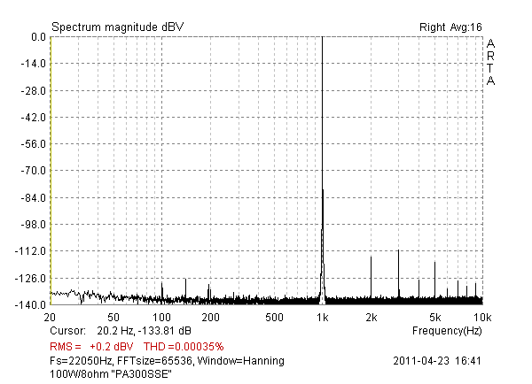

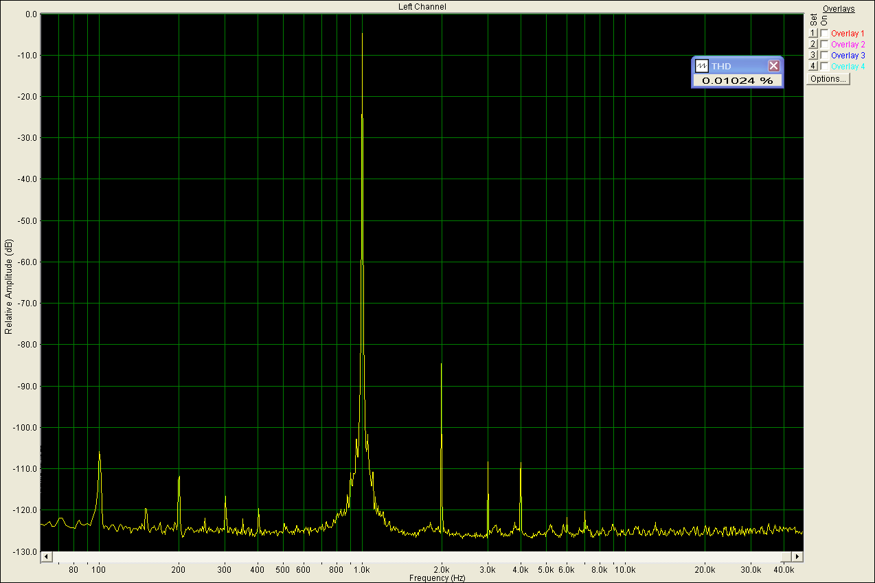

Example of real amplifier attached.
Why spoil a beautiful theory with incovenient facts? 😀
Ciao T

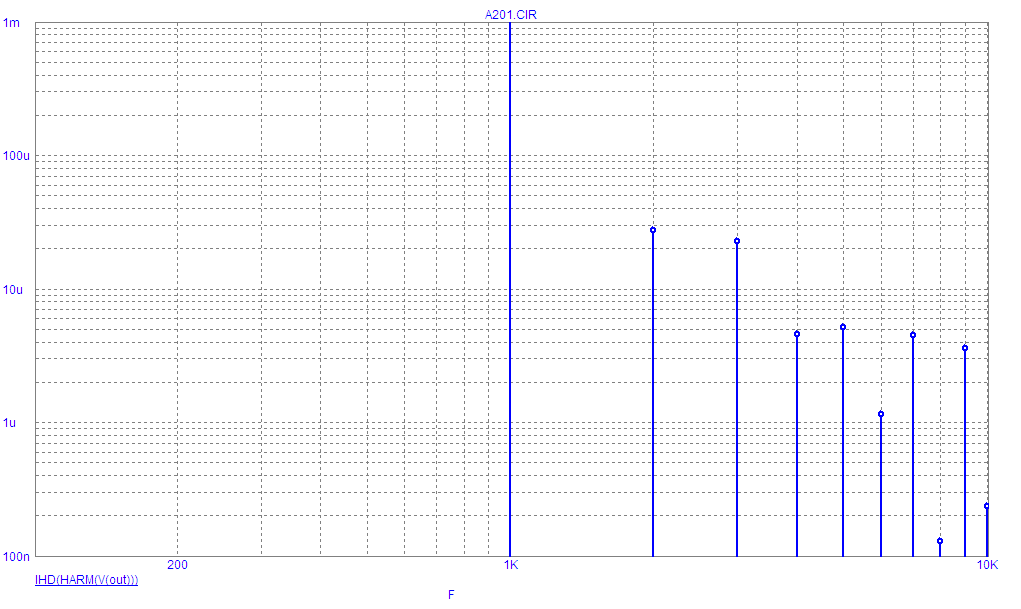

Here are two pictures, one is simulation of IHD for my amp, second is measurement for the same , realized circuit. I found according this simulations quite reliable, if properly used with realistic models and all faults in realization are avoided (PCB, grounding, etc..).
2 PMA
What about posting here Your .cir file?

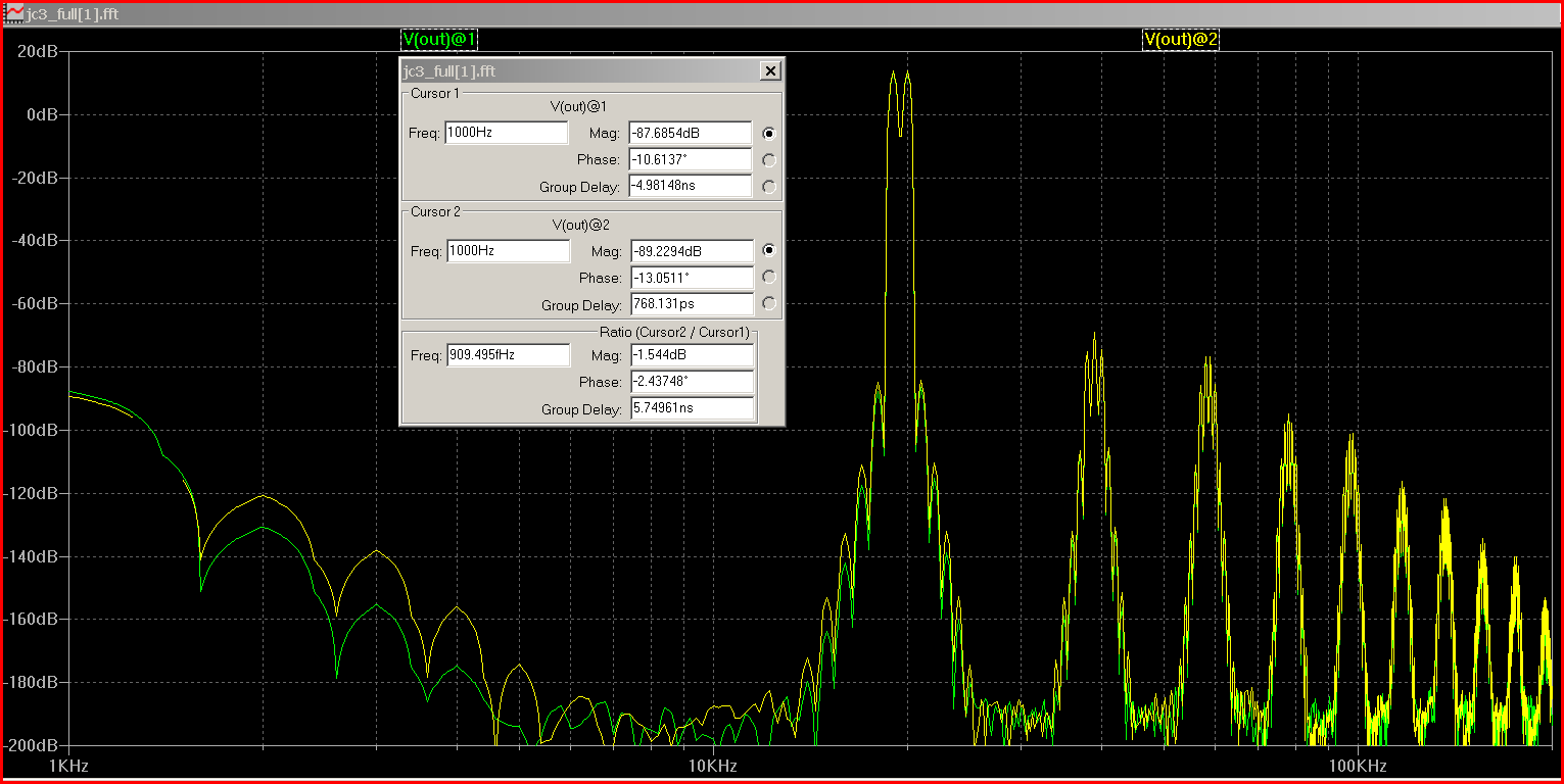

The usual jc3full sim, green v(out)@1 is without inner feedback, yellow @2 trace is with inner feedback resistors
The pic is a little large but I wanted to include the 1K and still have everyone be able to see the higher frequency IMD skirts too
Now is someone going to point out that the inner feedback made the 1 kHz IMD product “better” by 1.5 dB while ignoring the faster decay of the higher order difference "skirt" envelope?

No, sorry, that is not what I noticed. Your sims showed basically "no real difference", based on you wrote...
This is 19 & 20KHz? Gosh this looks bad, what is wrong with your sim?
I can barely tell there are two signals!? Is that something that LTSpice does? I expect a rather different picture in my old (and now non-functional) copy of P-Spice. I was considering a switch to LTSpice, but looking at that I better buy an old 2nd hand Laptop to run Win XP and PSpice on...
Ciao T
windowing in fft is a trade off, selectable in Ltspice
Blackman windowing - pushes down the "hair" of spectral leakge "floor", in exchange it widens the lines, takes up 4 "bins" for the windowing skirt to fall to the sim's numerical fft "noise floor"
the sim is only 5x periods of the 1 kHz difference so the Blackman "fattening" of the spectral lines means the overlap doesn't drop to the fft floor, the windowing skirt is ~ 20 dB down from the peak at 400 Hz offset = 2 "bins" for a 5 ms sim
the "points" of the spectral lines are what is relevant - there are no mechanisms generating less than 1 kHz differences in this sim
I chose Blackman rather than the defult becouse I wanted to "look lower" - I could have lengthed the sim but was pushing tol, t_minstepsize to the point of taking 10s of minutes already
