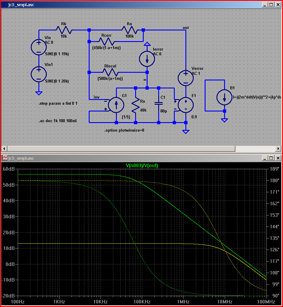

for this discussion sufficient criticism is that the Lohstroh Otala circuit introduces a extra gain stage (and don't you consider diff pair “VAS” with current mirror more complicated than just 1 stage?) heavily degenerates each, and adds a little local pole cancellation that actually makes it much more "conventional" in terms of degeneration/local feedback at high frequency
I think the text is less than illuminating - probably the "loaded" language referencing the AES debate was missed by the IEEE reviewers
but I don't see how you come to the conclusion from that paper than the JC-3 "inner loop" feedback R are working in their formalism
as I keep stating, the analysis result of how the JC-3 inner feedback R "works" is completely independent of why you thought it was a good idea at the time
when you state that the local feedback reduces the internal driver node Z and that reduces distortion in the closed loop amplifier from Ierror at the inner node you are making a circuit operation claim testable with Bode sensitivity analysis - that is what my simplified sim is about
by the way university EE programs have been teaching feedback circuit analysis for 50+ years the "reduced Z from inner feedback reduces distortion from Ierror at that node" is simply not true for the JC-3 topology - the sensitivity is for all practical purposes is the SAME with or without the inner feedback R in the JC-3 topology to beyond audio frequencies

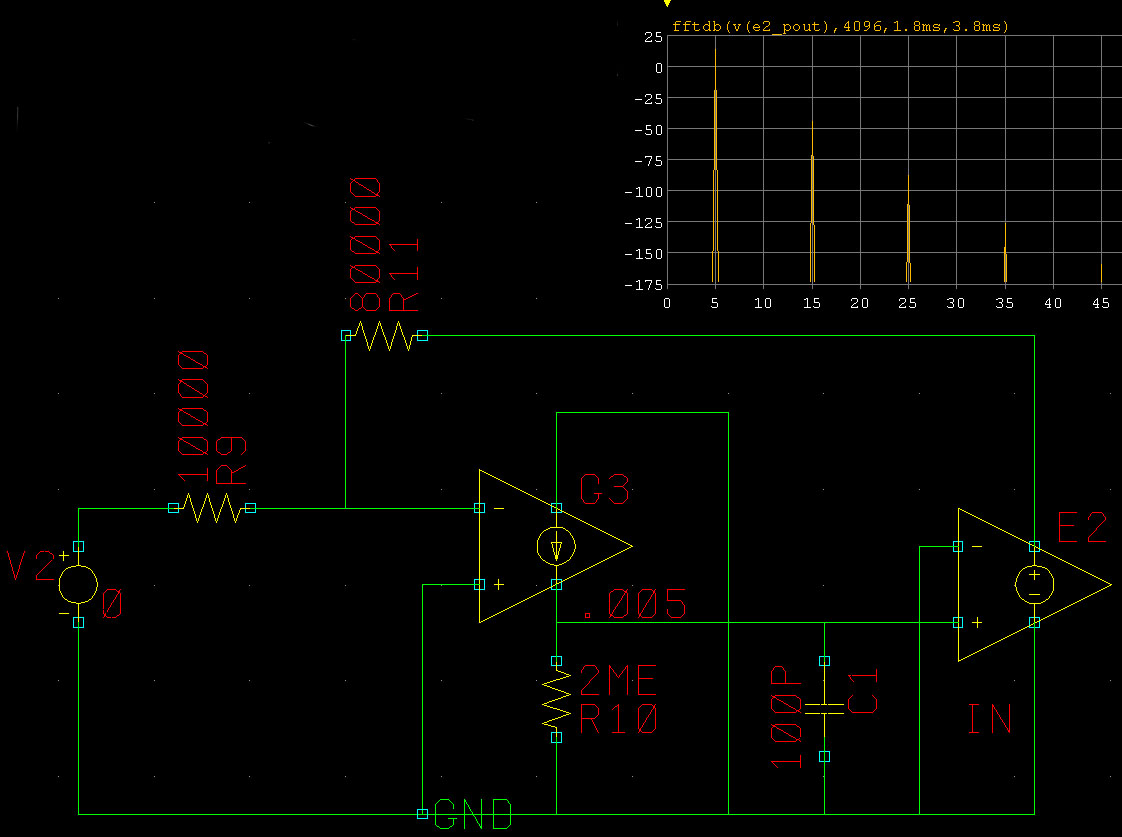

Another simple experiment
Here's a cute demo of "re-entrant" distortion or whatever you want to call it. Take just about the simplest representation of an "op-amp" , a gm (5mS), R, (2Meg so Aol = 10k), and a C (100pf), ideal output stage, and put feedback around it. Give the C a voltage coefficient (C = 100pf + 1pF*V*V). With only the square law variation of C all odd harmonics are generated in a decending amplitute with frequency. Here I have about 16V p-p at 5kHz. I'll say nothing about adding local feedback, anyone can do the experiment (Hint: you don't need another plot.)

"we are not amused" - that audio gurus writing articles on feedback don't follow this
the intent to "reduce loop gain to 20 dB" is not illuminating how the inner feedback resistors actually change the JC-3 circuit's closed loop performance with respect to
"linearizing the driver, by swamping the relatively high impedance developed by two transistor collectors, and/or providing a relatively low drive impedance to the output followers that forced less influence of beta nonlinearity, easily and obviously seen in open loop measurements of the device,.."

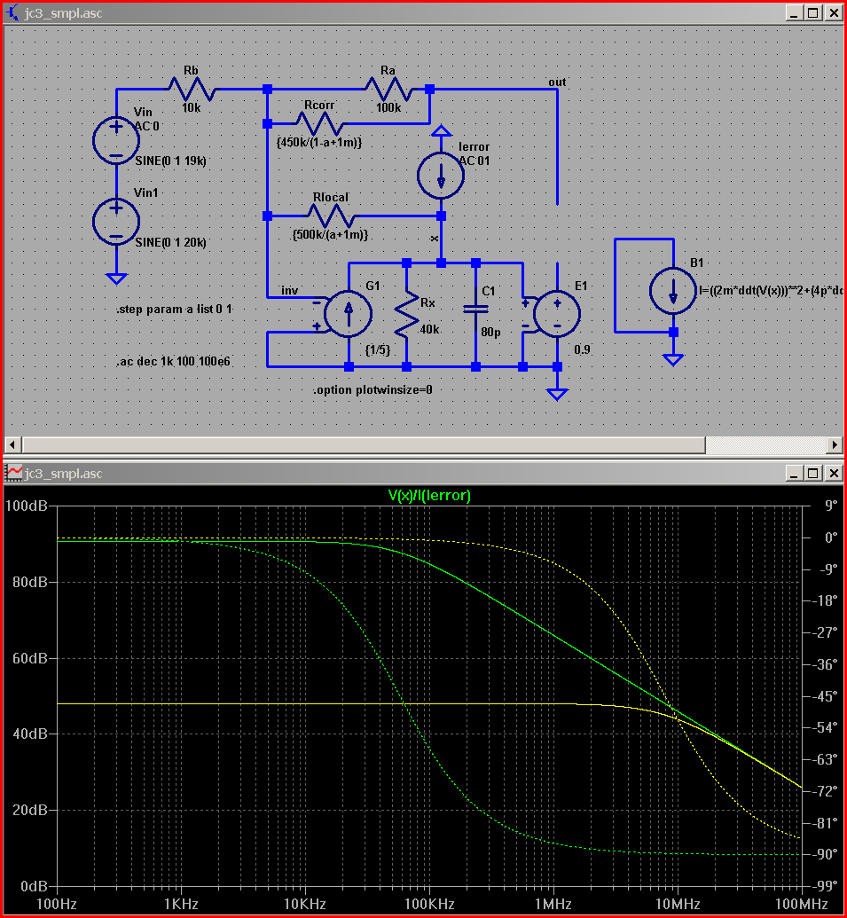

perhaps you are stuck on the "1st step" - the inner feedback R does reduce the high impedance node Z when measured with the global loop opened
apparently you stop the analysis here
I ask "the next question" - how does the inner feedback R affect the (globally) closed loop response of the amplifier to the same influences?
the answer is that when you close the loop the "influences" represented by injecting a Ierror into the node show the same sensitivity without the inner feedback R
a way to think about it is that the inner local feedback reduced the error by very closely the same amount it reduced the open (global) loop gain
so you end up in the Red Queen's race, "spending" loop gain to reduce the inner node Z, costing "the same" amount off the global loop gain, reducing global loop effectiveness to very nearly exactly compensate – back where you (would have) started without the inner loop feedback
If you add gain stages, local feedbacks then you may see “improvements“, not in this simple topology where you haven’t added gain, just “rearranged” it
My simple version Bode sensitivity analysis sim can show the inner loop Z reduction, and that it doesn’t change the response when the global loop is closed
http://www.diyaudio.com/forums/anal...ch-preamplifier-part-ii-1581.html#post2705814
I expected people working at the pro EE level of circuit design would be able to do the Bode sensitivity sims, plots, particularly with eveything set up for them

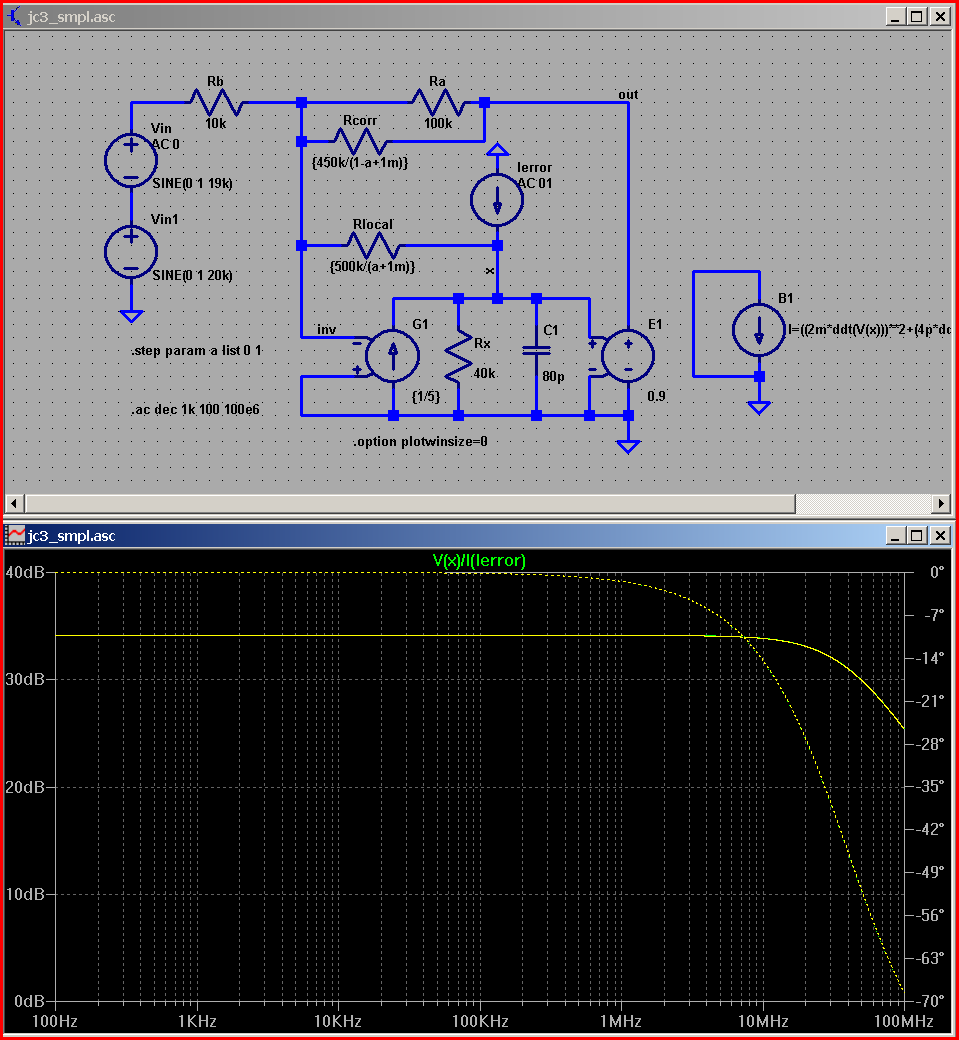

below shows the inner loop Z reduction of node X impedance with the global loop open
then the response to the same Ierror at node x with the global loop closed
and the 3rd is a "simple Middelbrook" loop global loop gain test
yellow is with John's inner loop feedback R, green without - but outer loop gain compensated by Rcorr
a further step would be to insert the loopgain probe "inside" the inner feedback and see how (not) much the "total" loop gain changes with the inner feedback R

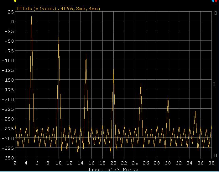

That is cute. Can you show us one with a 2nd harmonic?
:cool:
Sure, just make C have a straight linear with V relationship. 100pf + 10pF*V is strong but shows the point. Odds and evens show up, you can imagine a full polynomial expansion of C (~V^.33) would look "interesting". Distortion caused by nothing but feedback, what a concept (not new).
This example is so simple you could write out the node equations and solve for the polynomial solution directly. The simulator does the same thing iteratively.
Dear Scott,
Now I have been reliably informed by my people that they finally located a kind of matter that is more dense than the stuff beyond the event horizon of a singularity. Apparently I am carrying it around inside my skull. I never knew!
Anyway, back on topic, please explain to me why exactly I would want to use such a capacitor in my amplifier? Now I understand the capacitors inside IC's are very bad, I hope sincerely where they matter they are better that that if used as dominant pole.
I have this nasty habit of making my own cap's for this dominant pole job from PTFE Coax Cable (which incidentally also allows them to be easily adjusted for optimising transient response), if this becomes impractical, I use silver mica, which I happily enough can get made up to several 100nF if I order enough.
Now I understand the didactic purpose of this particular strawman (I hope you understand the same purpose in my own ones), but honestly, you are loosing most of the audience and you are boring me to death. I think I just lost pulse for several seconds.
Please show something REAL.
Either a Sim that is sufficiently REAL (it gets really complex to that but with sufficient time and willpower it is possible), or a real circuit.

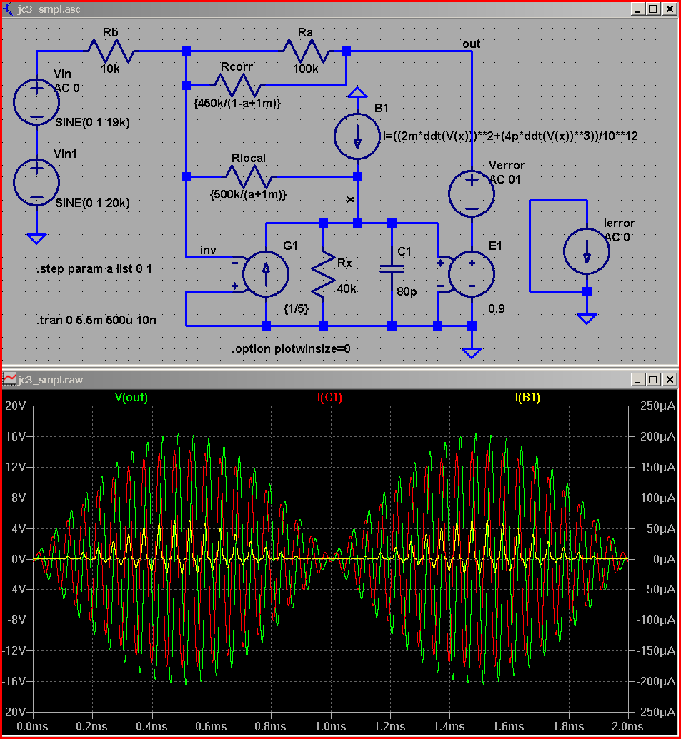

What software did you use for schematic capture and simulation ?
In house LTSPICE can do this I'm sure.
jcx - What handles does LTSPICE have to force a rectangular window to work right? Most transient analysis algorithms fly along only worrying about converging to abstol, reltol, etc. When you ask for exact time points they interpolate.

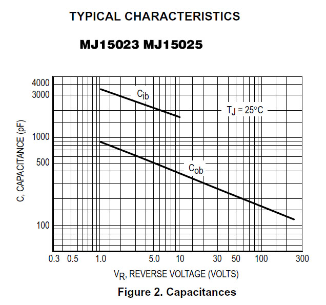

EDIT - Oh BTW the circuit we have been discussing seems to use these bad capacitances as Cdom.

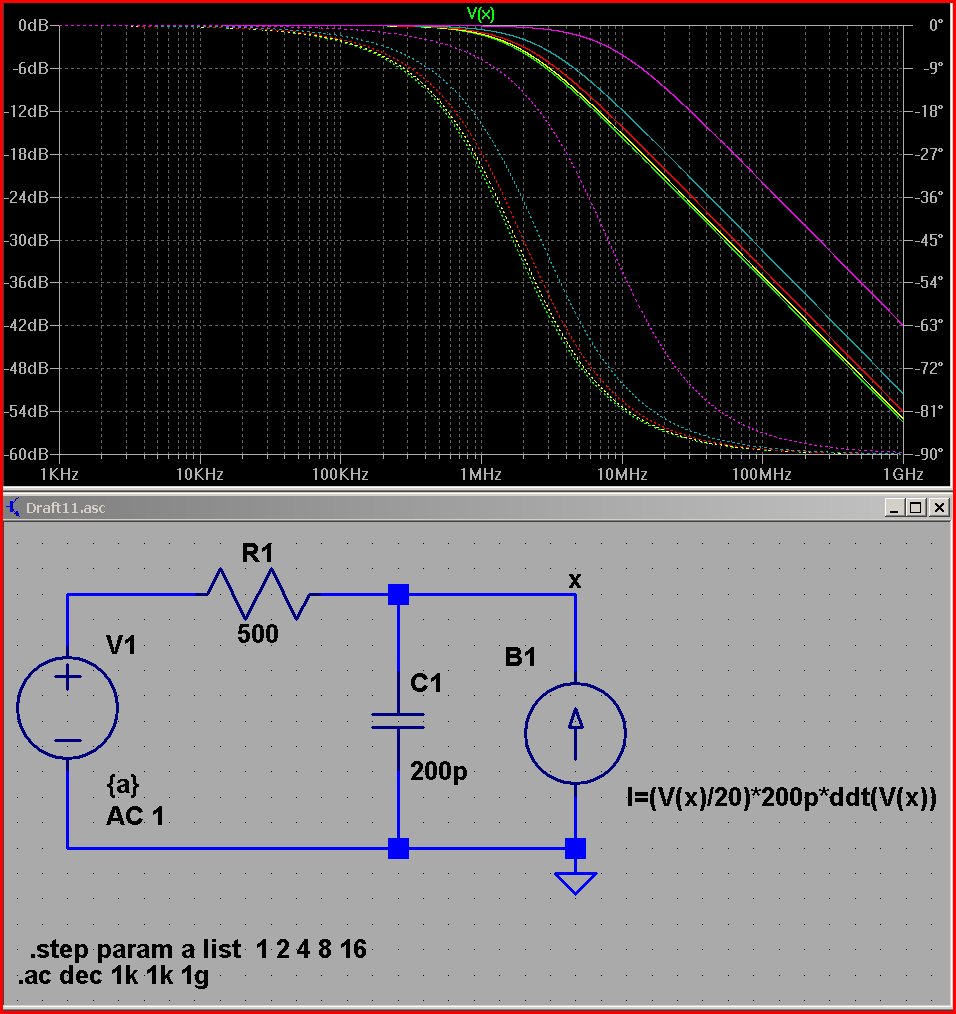

I already posted a fairly nonlinear C model - as Scott mentions you can go the books, look up the equations for semiconductor's junction's C, model I, V dependencies
here's another, done in Ltspice
BI source equation is that of a C, behaves in the cirucit sim as a (nonlinear) C
I=(V(x)/20)*200p*ddt(V(x))
"deconstructing" the equation
I = 200p*ddt(V(x))
is the basic behavioral definition of C = 200 pF
you can multiply it by any other function of terminal V, or any other circuit's I or V
you want to avoid negative impedance in compensation C, some equations will do that
the sim actually "subtracts" the BI capacitance from the "real" sim C1
AC sweep shows differing RC corner F with bias V - but you would need a .TRAN sim to see harmonic, IMD distortion
Scott: the fft pop up window has "Binomial smoothing filter applied before FFT and Windowing" length setting in "points" - I'd look on the Yahoo Ltspice users forum for more details

You do all the time they're known as Cje's, Cjs's, Cgs's, etc. They don't have to be C's they could be bad early voltages, quasi-sat.
Oh, you meant the kind of stuff that would not make a difference if the source impedance was zero and and less of an impact if the drive impedance was lower? Like lower by using a local loop?
