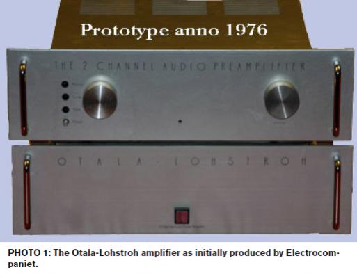

Lohstroh on circuit simulation . . .
"During my later work in digital research I used circuit simulation in order to understand the principal properties of a digital circuit. Setting all the parasitic capacitances and/or resistances to zero for the circuit except in one place gave you good insight. You can do the same for an analog circuit. Set all capacitances in the device models to zero and use only a single capacitor in the circuit; for instance, the Miller capacitor of the input stage. The amplifier’s dynamic behavior will now only be determined by that one capacitor.
Excite the amp with a step impulse, possibly with a sine wave superimposed on it, check the signals at all important nodes, and then re-introduce all the parasitics step by step to find out where some limiting factors come from. This might be time consuming, but you learn more from it than by including all parasitics right away. In this way, you can 'play' with a circuit and look at open-loop bandwidth and nonlinear behavior such as IMD and TIM, to mention just a few." Jan Lohstroh
from Jan Didden's My interview with Dr. Lohstroh
