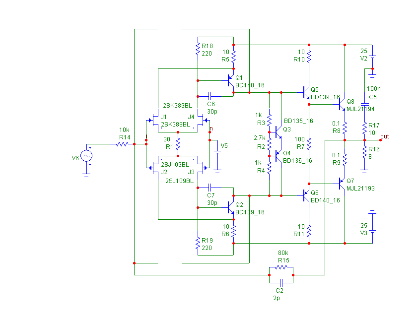

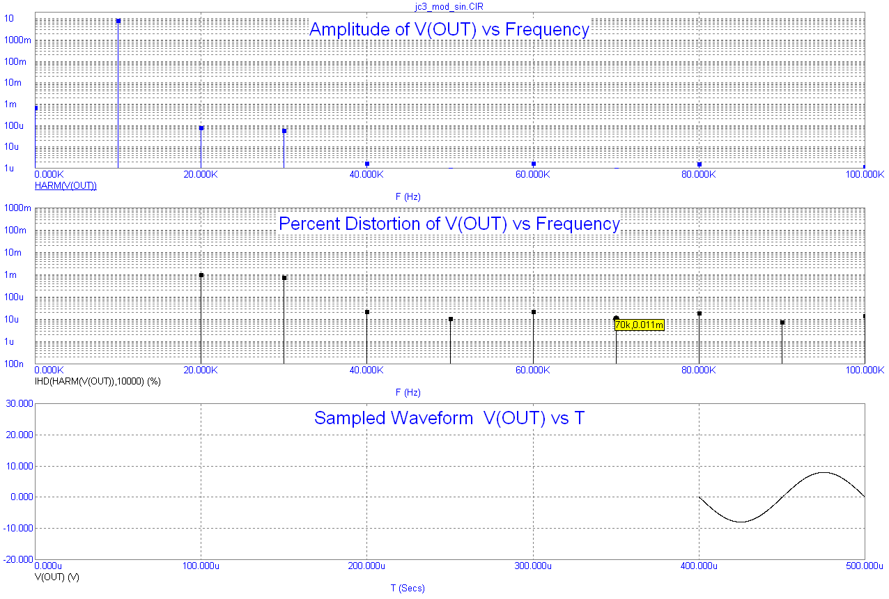

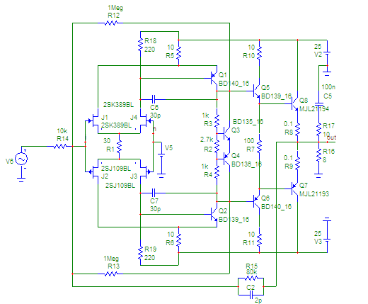

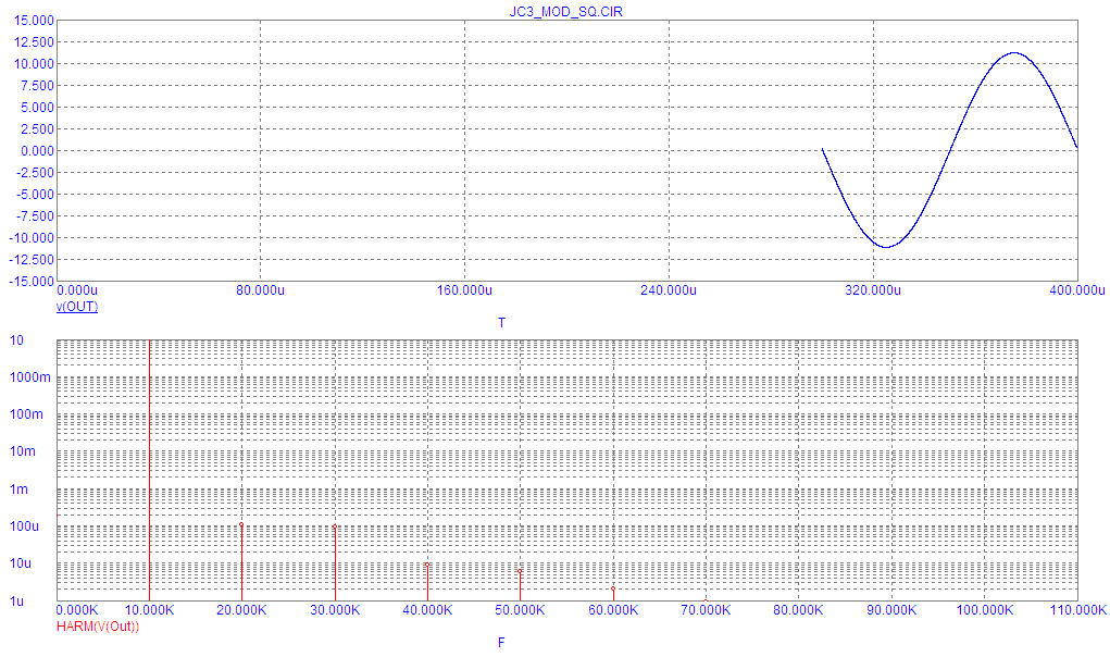

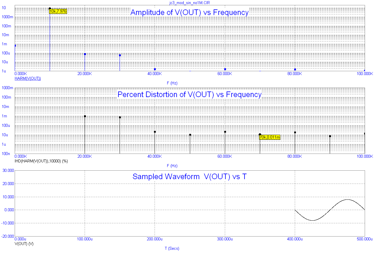

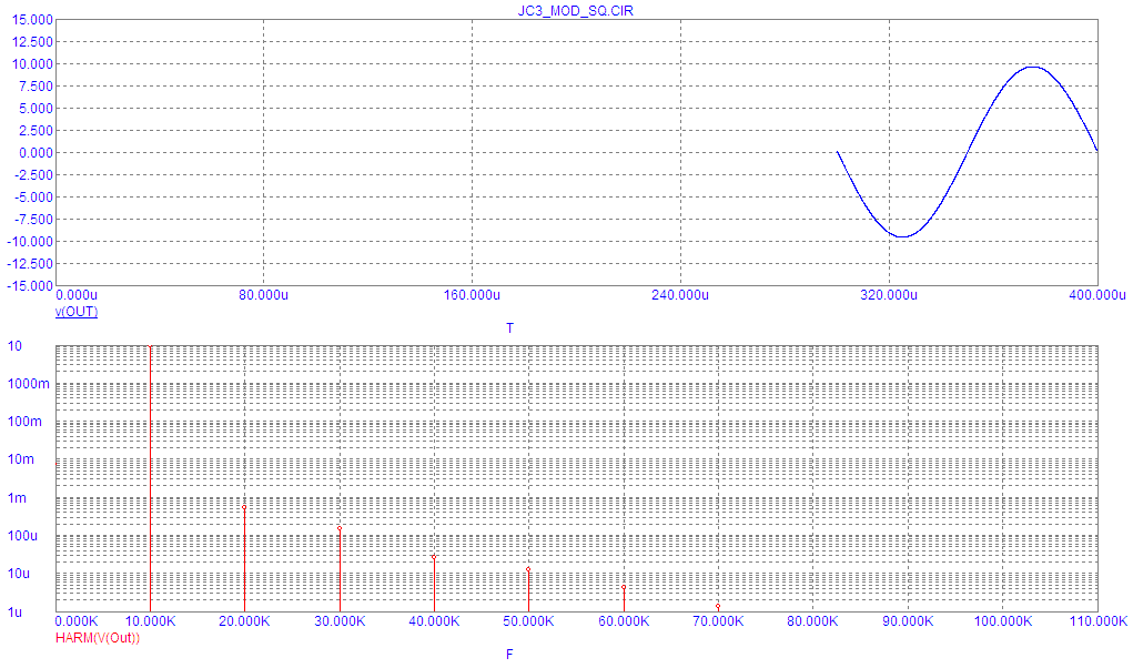

If the 1M FB resistors are omitted, low order distortion remains the same, but high order distortion components rise.
Pictures or numbers please, or are you going to make me eat my shoe like Wener Herzog. I might note your circuit is not the original.
Wait a second guys, the harmonics above thirds start at 40dB below the thirds. This could be splitting hairs and random numerical cancellation after all is is a different circuit and just a sim. What about the seconds and thirds also from the same sources of distortion?
PMA's results actually prove our point the dominant distortions from soft voltage coefficient non-linearities are not reduced by this resistor, whats happening at the ppm level is dependent on all kinds of fortuitous non-fortuitous cancellation.
I'm beginning to smell krill. So have fun guys, not getting sucked down that again.

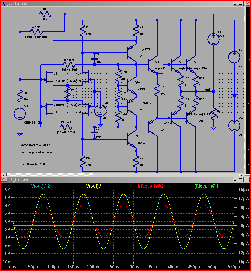

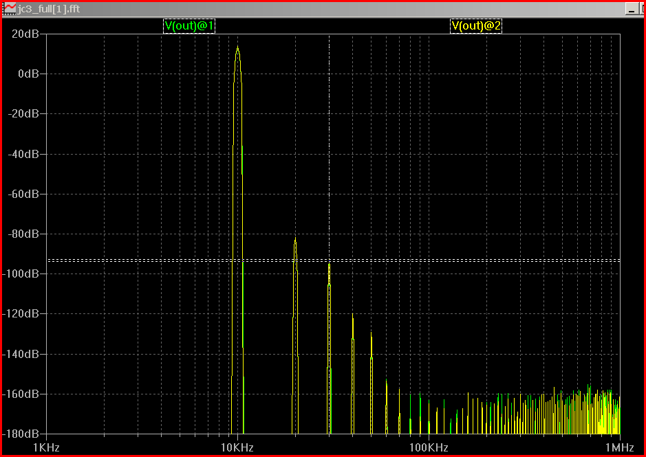

I guess it must be the models - I used fet models from http://www.diyaudio.com/forums/parts/18031-looking-spice-models.html#post210374
Cordell's Q models, maybe Bob's (skeptical) touch "spoils" the sim?
all the part models are on the schem
the result is, again, No difference in distortion or distortion "profile" with the the output in Class A with or without the inner feedback 1 M resistors - down to -170 dB below the fundamental
when bias is cut back a little, edging into AB output operation, removing the inner feedback Rs reduces some higher harmonics
I am getting tired of this - my impatience may mean there are errors in the sim - find them, put up PMA's models or work the excuse list a little harder...
