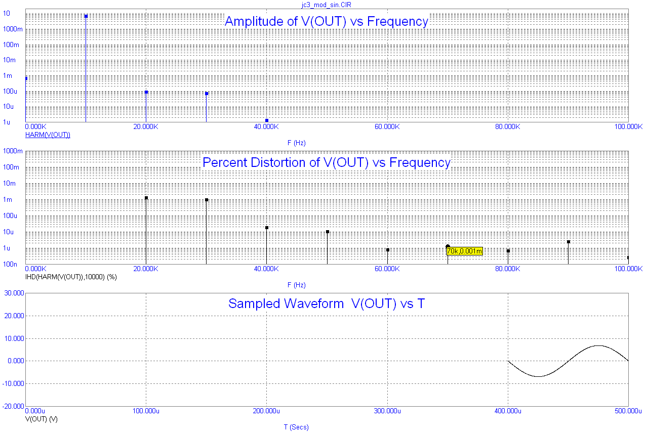

Some JC3 sims made years ago ...
If the 1M FB resistors are omitted, low order distortion remains the same, but high order distortion components rise.
Hi Pavel,
This is what I would have predicted.
Ciao T
Ciao T
I do not know whether they are "right". When I compare results of simulated and built amplifiers, the sim results predict real life quite well. Usually the real life THD is 2 - 3x higher than that by simulation, but spectrum shape remains similar.
For this amplifier, the result shown is at less than 10Vp output voltage. In case we go close to 20Vp (for 25V supplies), distortion (simulated) rises to some 0.015%.

Pavels Sim looks more like my "modern" suggestion,though the BD139/BD140 are more than bit long in the teeth.
I stand with my original suggestions to answer the question what the local loop does in the JC-3 as originally designed.
