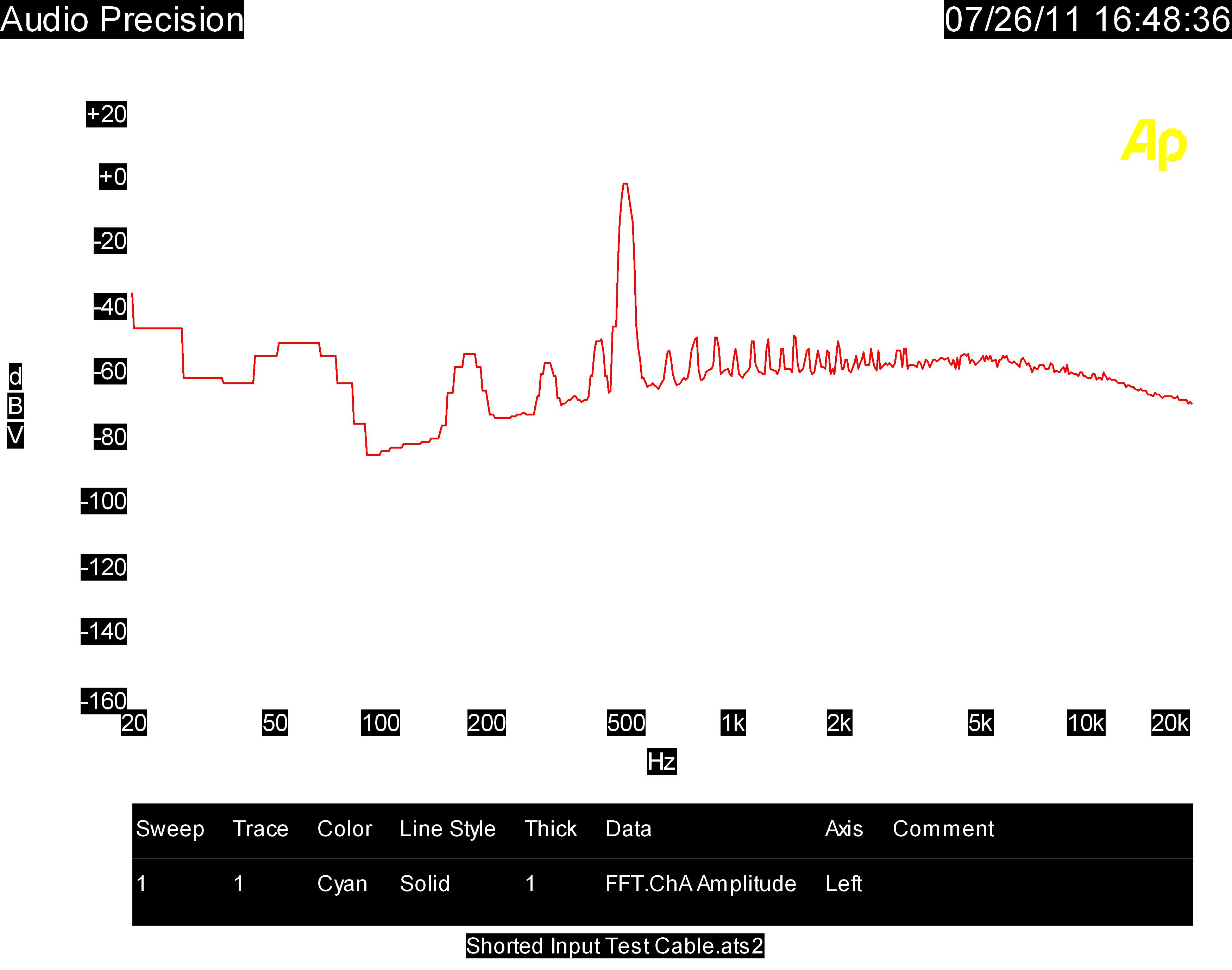

I promised a look at the FFT of my test setup. Shown is the output of my preamp being fed through the attenuator and the capacitor as shown in the second image.
I did change to an external Jensen isolation transformer and turned down the gain to 100 db or so by changing the middle stage feedback resistor to 10K

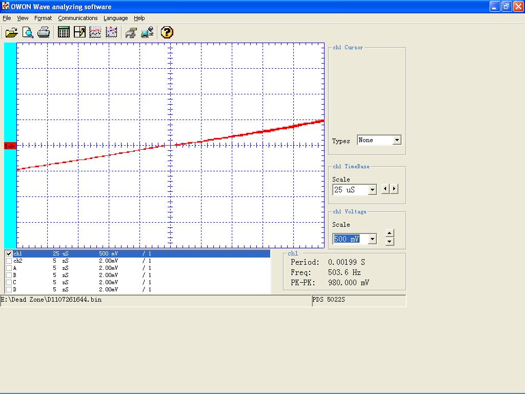

Also attached is a closeup of the zero crossing of the electrolytic capacitor.

Try constant current in the cap through zero.

I think we both know what to expect. This is more typical of how a coupling capacitor is used. After I finish running things as it is set up I may try it, as surprises are interesting.
I have a few other interesting plots, but they didn't transfer as I though they would, so next play session I will have to see if they are still in the scope's memory.

Now, explain how this capacitor knows it is crossing through zero? It will need to be biased, so at each point on the curve, there will be a voltage across the cap.
Must be the machine.
vac
vac
There is no power at 0 volts.
