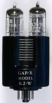

Great illustration on the front page. Just wait till the tube guys find out an opamp may look like something like this.
They will go nuts and have their time machines spinning before you know it.

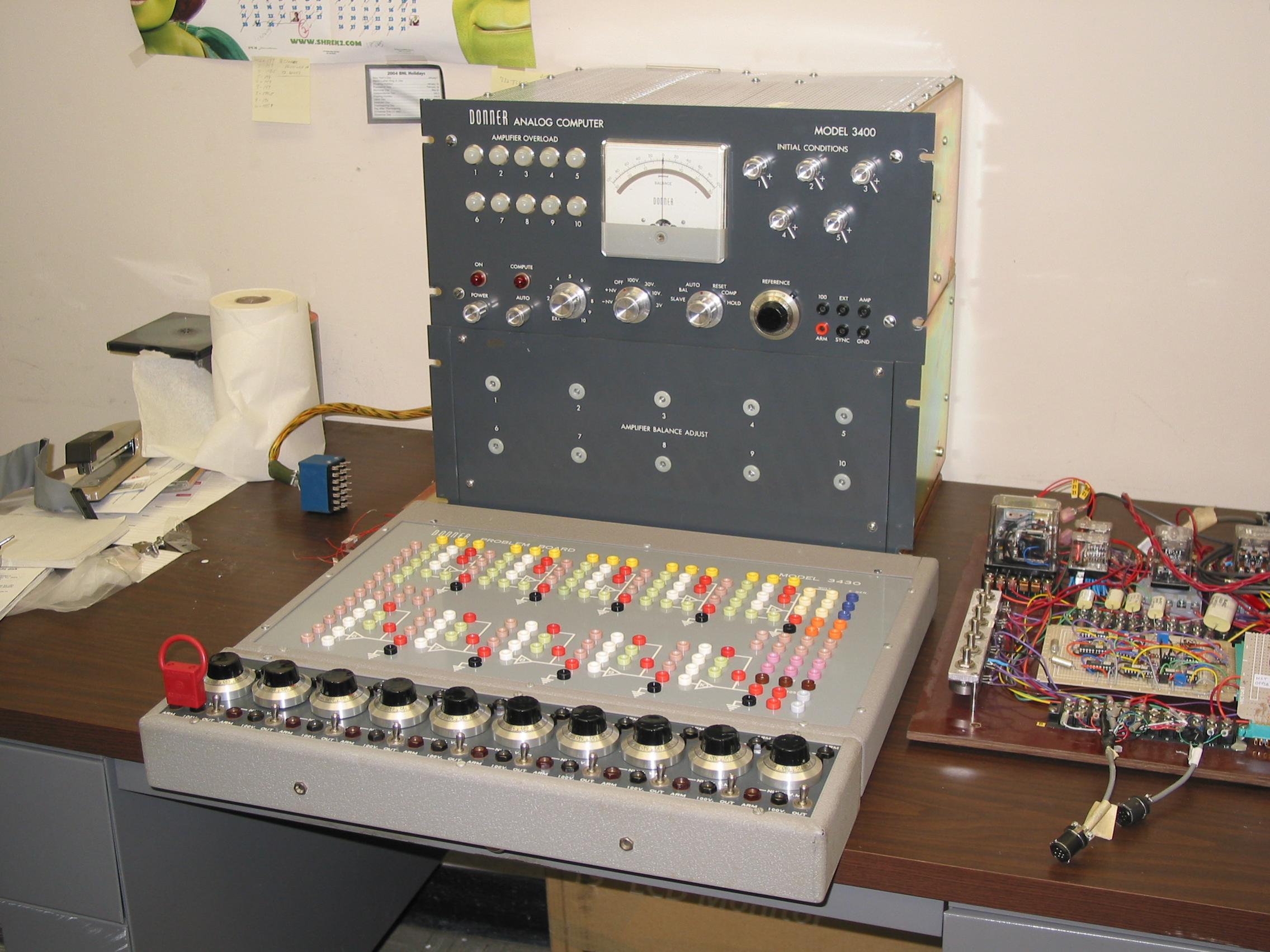

What a beauty. Is that red plug for emergencies when smoke or sizzling sounds emerge?
vac

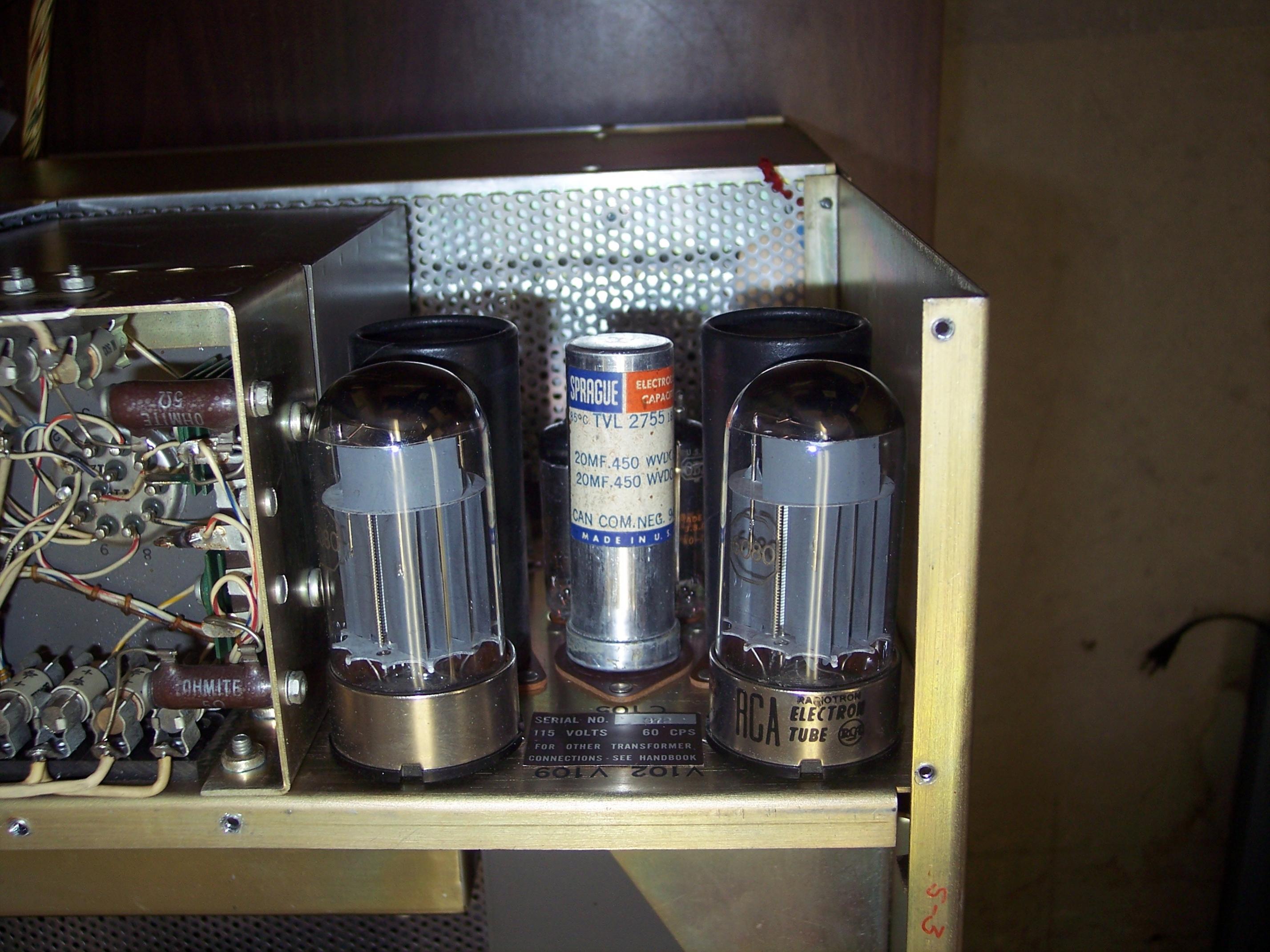

If it is....it didn't work. I had this unit in order to refurbish it. Spent a week reforming the caps very slowly with a variac...two of them did not awaken in a good mood..too dry. I will admit however, that I (for a change) was very intelligent in how I worked on the unit. The first thing I did was take pictures of every single wire, component, connection, in every location on the unit. I could read all the color codes, trace all the wires, just from the pictures. Not normal electronic troubleshooting of course, but I was unable to obtain schematics. When several resistors in the power supply burned and obliterated the color codes, I just "went back to the video tape".
Aren't you missing the 3410 & 3420?
No, I am not missing them at all. 😉
But I did learn a lot about electrolytics, aging, and reforming.
Here's the culprit..that 20/20.. tried to upload two more guts pics, they failed..size I believe.
OH..almost forgot..lower left side, notice those cartridge rectifiers?? I had never seen anything like that before..neat..
