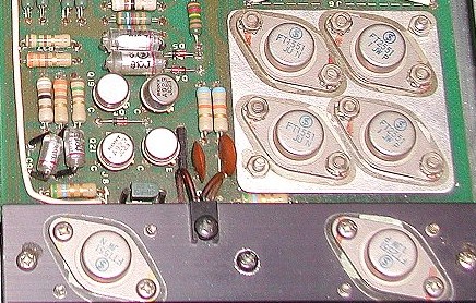

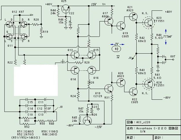

FT1551/FT2551 complementaries, 20W Pd.
As in the Accuphase C-220 from 1977, only preamp with identical devices at the compl. diff. phono input and line stage output, see piccy.
Production of the C-220 seized in 1980, as manufacture of the FT's stopped.
Just the phono stage was the C-7, from '79, kept on going till '84, which suggests that the Accu-P boys were taken by surprise. :clown:

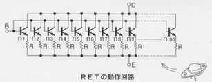

Look Ma, 100 in an emitter circle.
