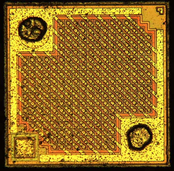

Here is a genuine 2SK170, lots of tiny FET's in parallel

What I would really be interested to know, is whether the 2SK370 has the same die, or a smaller one ?
Unfortunately I do not have any 370's, else I would have sent you one. But Nelson has tons, and maybe he would sacrifice one for scientific curiosity ??
Patrick
I will need to do more as a group, it was harder than you think because we sell nothing in this package there was no jig. I'm not permitted to do the jet of fuming nitric that they use for this so I called in a favor.
Not SY... but here's the reason
The guys pulled the leads off but usually things still work after this! Could you explain the mechanism by which the nitric acid does not attack the circuit.
unless there is copper or nickel somewhere, gold is immune, aluminum, chromium, niobium,etc. is passivated, silicon non-reactive, etc...
strong oxidizers CAN be your friend...
Used to make metal jets for streaming RFNO and UDMH... <<- rocket propellant... gotta be the right stuff or you get BFRC😀😀😱
John L.
