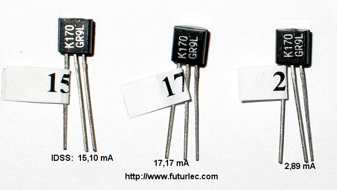

This is a bit off topic, but earlier in the thread there was mention of fake Toshiba JFETs on ebay and others have mentioned this on the forum. How do you tell a fake? Is the Idss way off? Or is it hard to tell?
Letters are stamped with silver ink, not engraved. they can be easy erased with alcohol or acetone. And Idss is usually way off.
