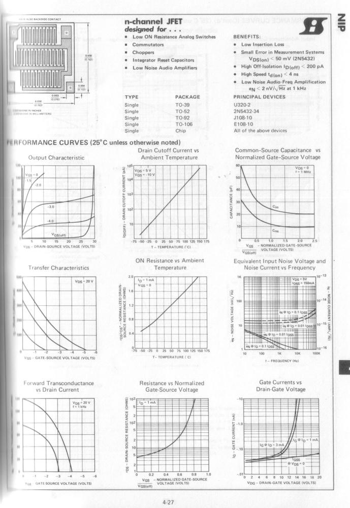

I have the 1977 NIP data, too, so here's the E110 and NIP general characterisation data.
Ohh, N-I-P (aka Negative Intrinsic Positive)
Blimey, what a well tutored expression.
