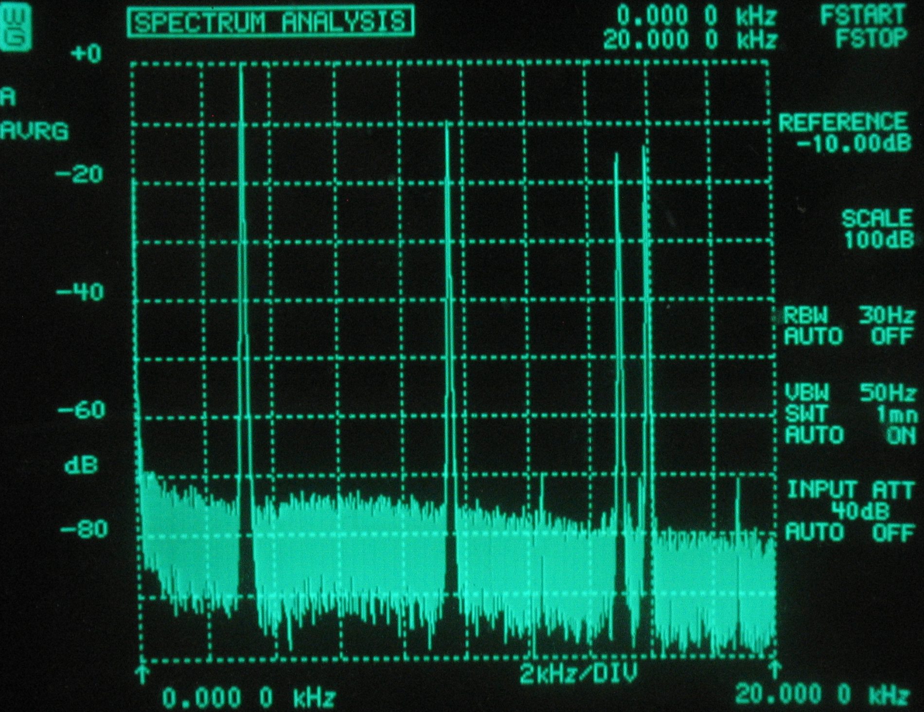

Stinius, everyone wants to 'bail' but not yet. We have to look at which it is: Matti's or Mitch's explanation that is ACTUALLY being measured?
i.e. is it IM or FM(or AM) that is showing up on the graph? It's easy, just do the math yourself and try to fit it to the graph. Rough fits are NOT OK. :geezer:
Rough fit's all you're going to get.
The graph doesn't even fit its own numbers.
I created a simple graph using the numbers given but it doesn't scale so as to fit the published graph.

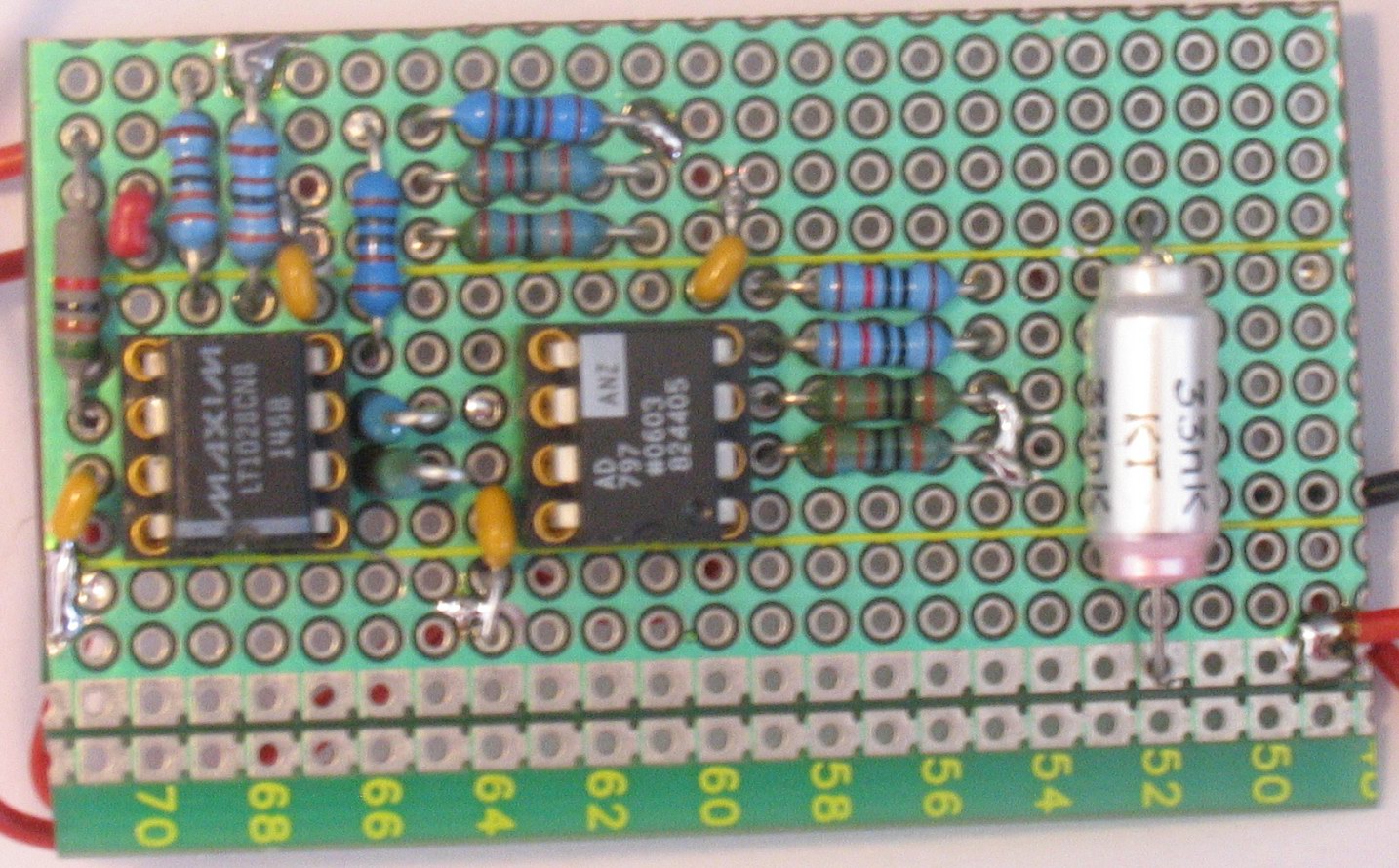

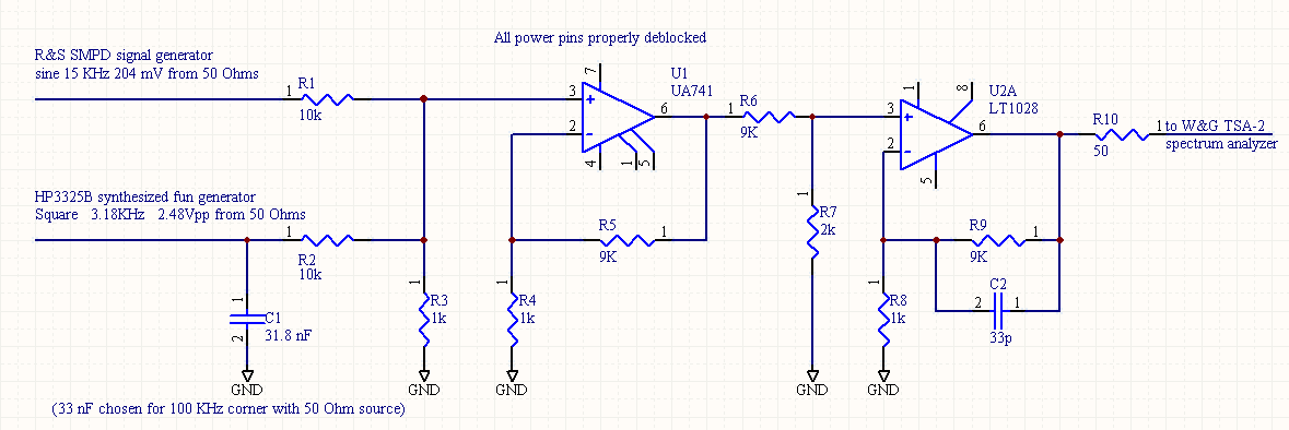

reconstructed test circuit.
The second stage was necessary because the 5K load requirement
prevented getting enough signal into the 50 Ohm spectrum analyzer.
Its influence should be negligible.

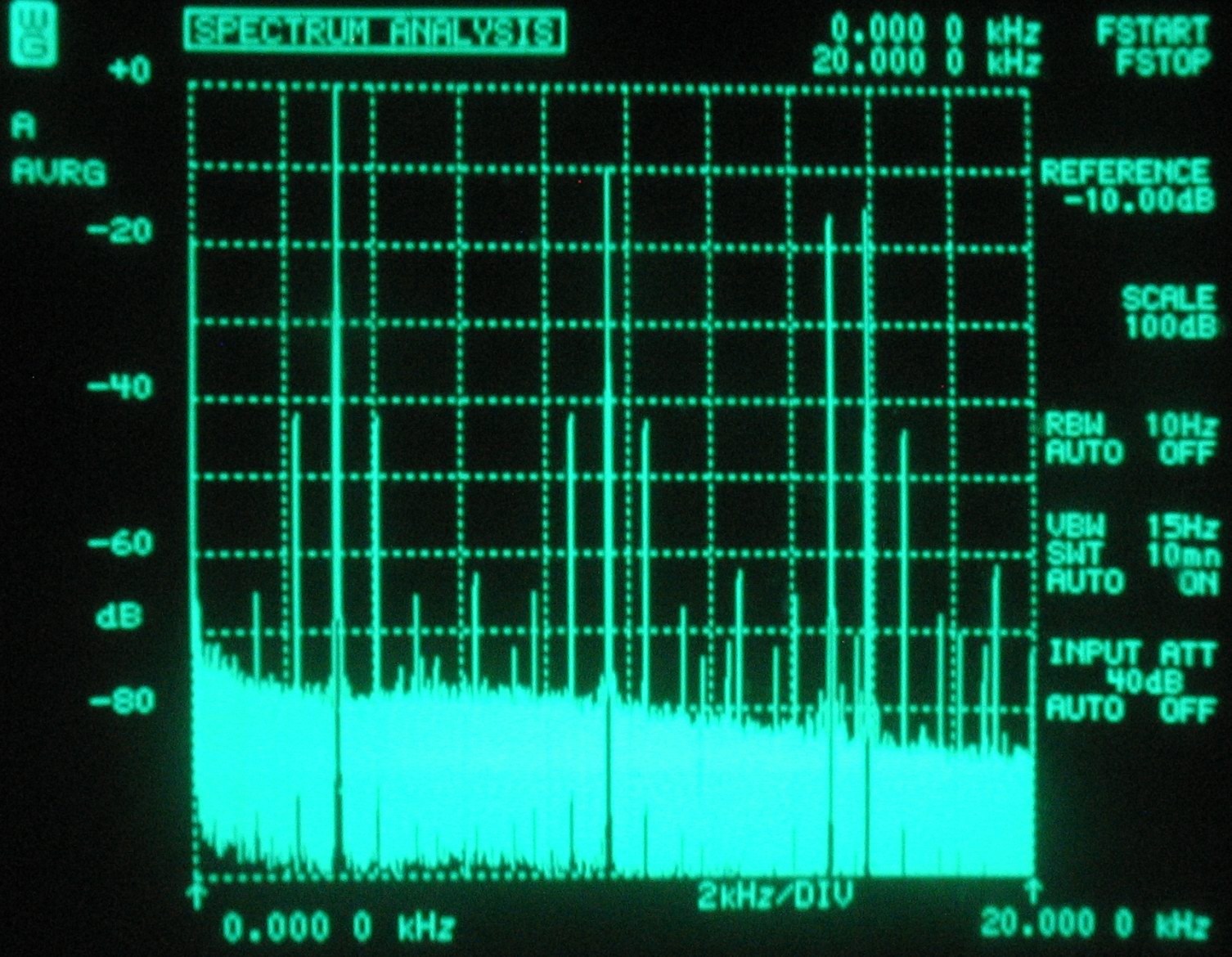

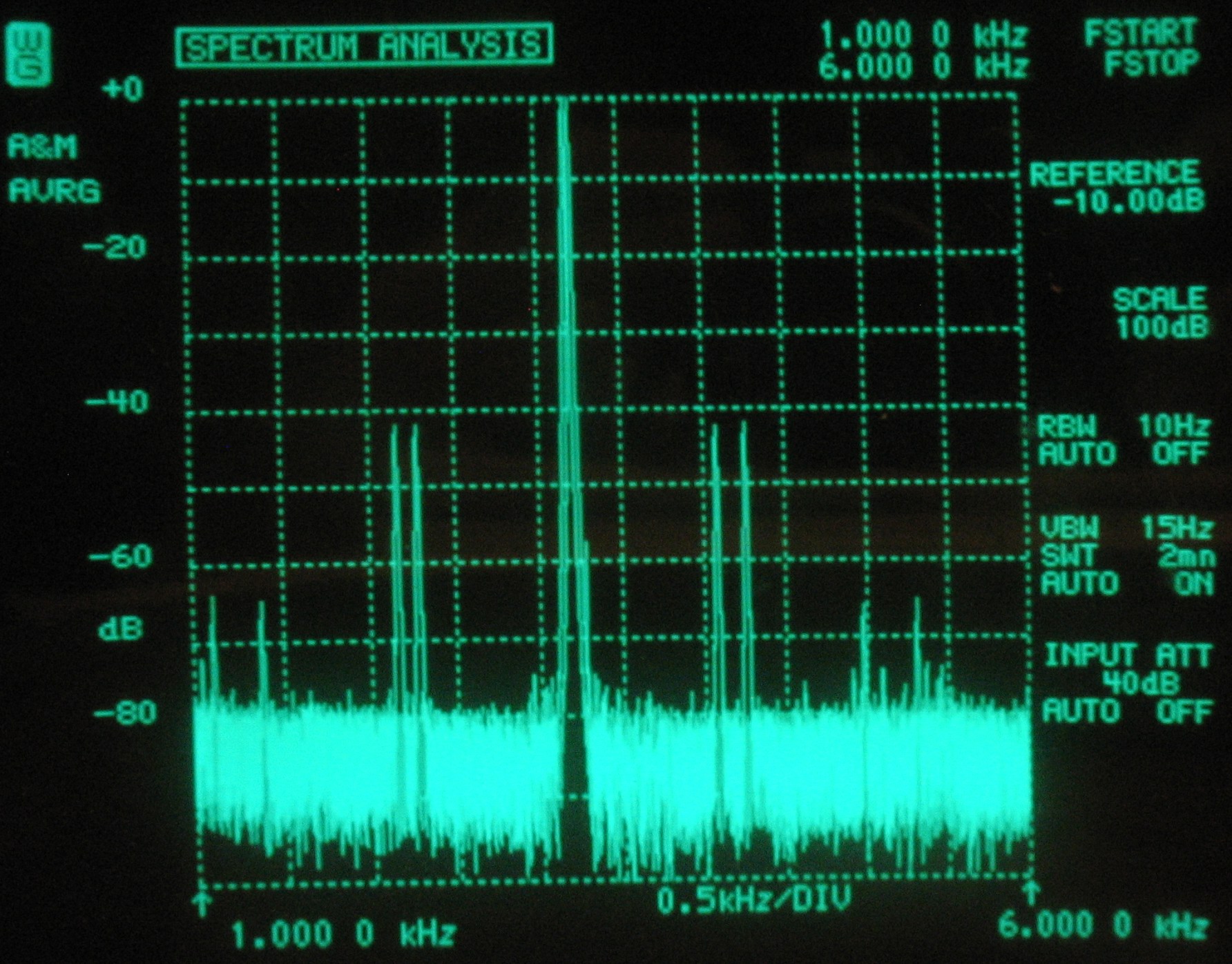

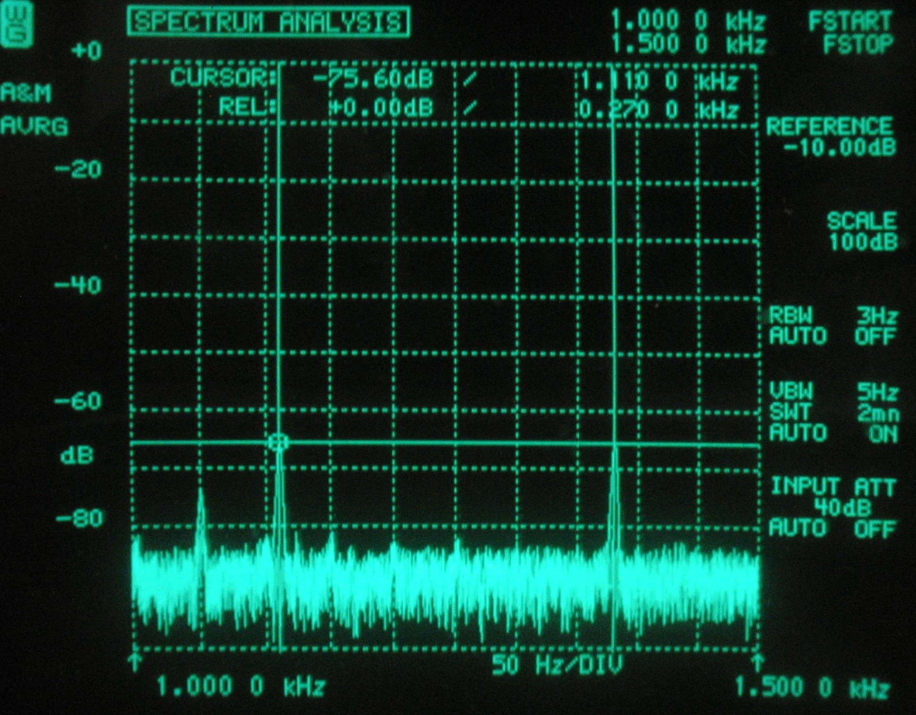

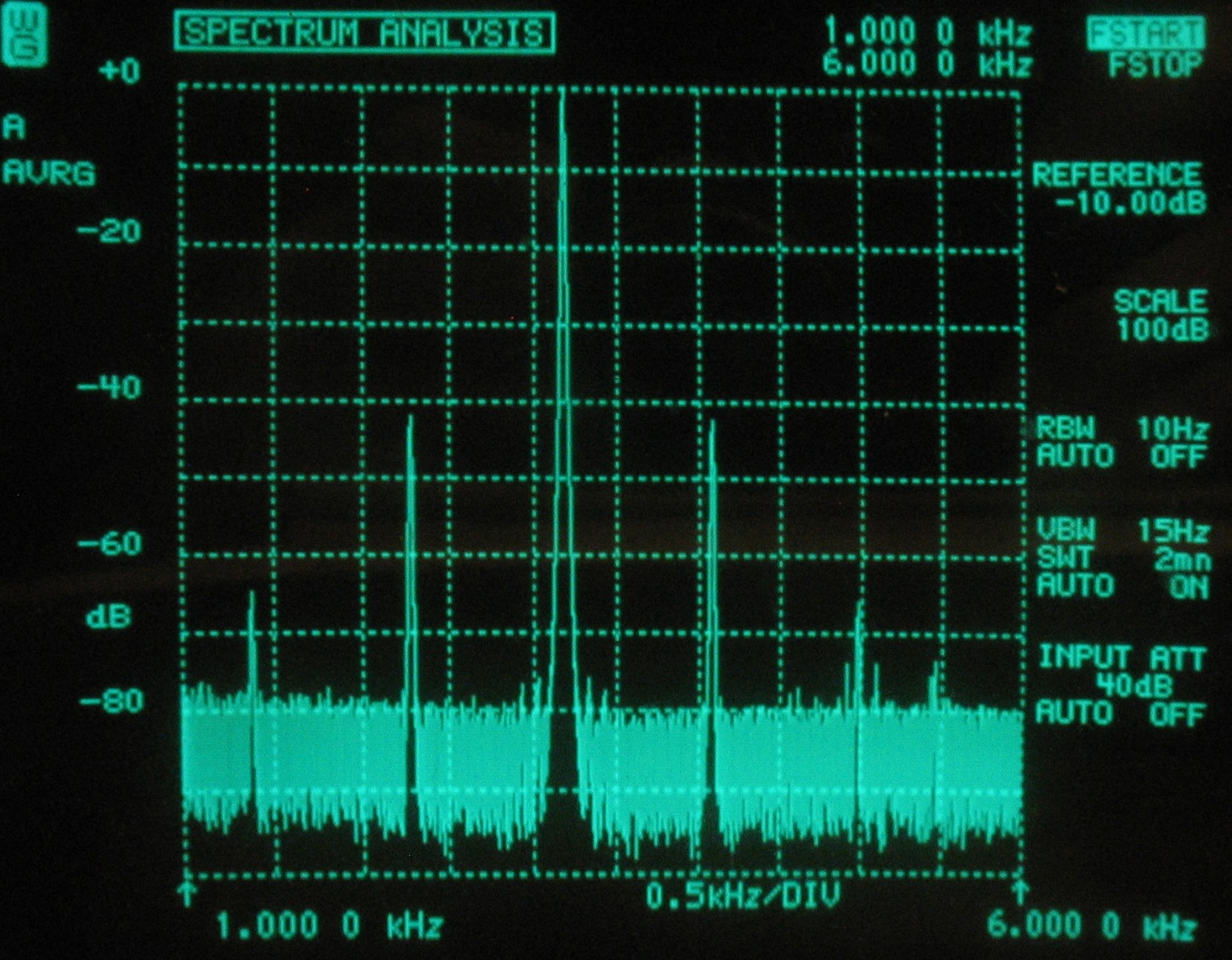

Now I have increased the frequency of the square wave by 30 Hz to 3210 Hz.
The old spectrum is in the memory and overlaid with the new.
These are the peaks now:
1.120 KHz (was 1.370, delta = -250 Hz) ==> 8.33 * df, probably 8*
2.150 KHz (was 2.270, delta = -120 Hz) ==> 4 * df
3.210 KHz (was 3.180, delta = + 30 Hz) ==> 1 * df
4.260 KHz (was 4.080, delta = +180 Hz) ==> 6 * df
5.320 KHz (was 4.990, delta = +330 Hz) ==> 11 * df
I'll zoom in even more to get more precise frequencies, but not tonight.
It's 2:15 am local time.
Gerhard

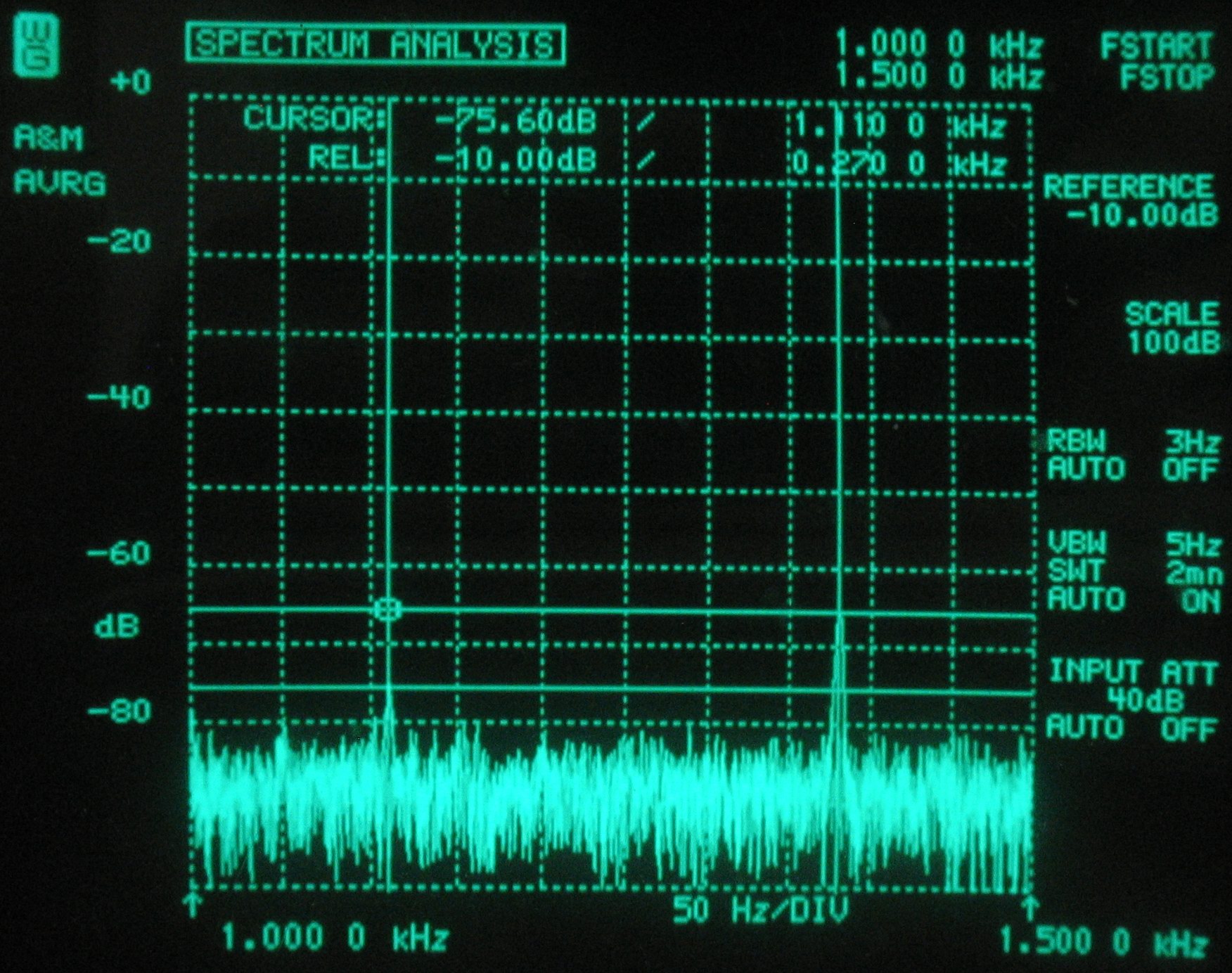

The questionable frequency pair in high resolution:
Squarewave = 3180 Hz ==> 1380 Hz
Squarewave = 3210 Hz ==> 1110 Hz
IMD product wanders 270 Hz down for input step of 30 Hz
=====> This is IMD with 9 * square wave frequency.
Methinks this argument is settled.
